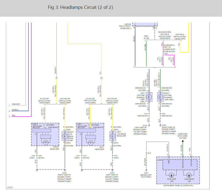

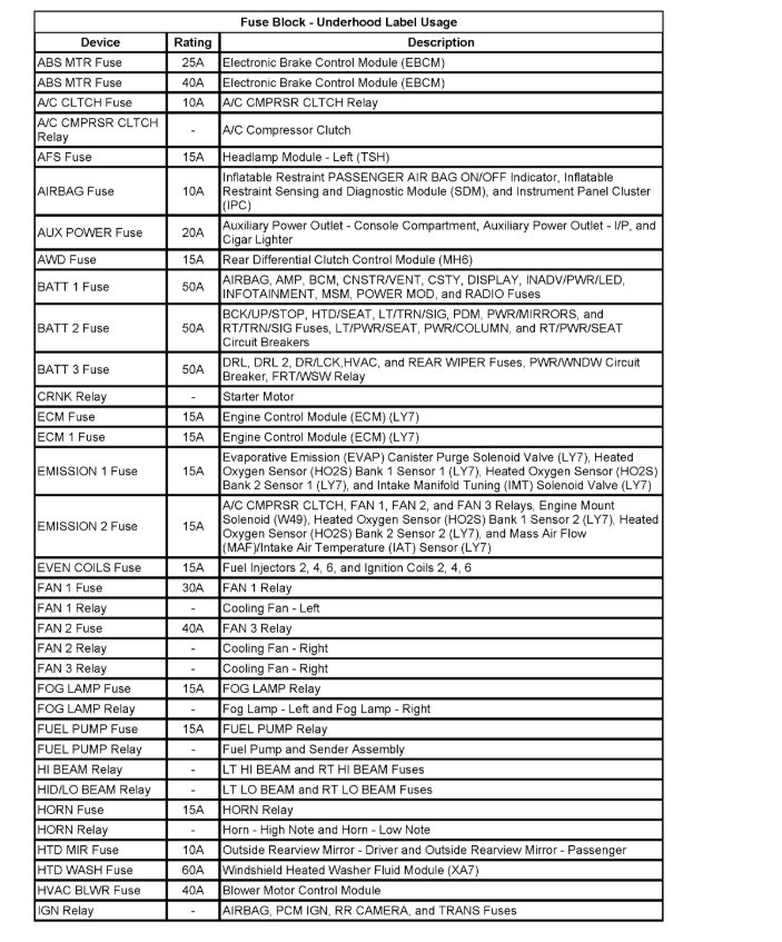

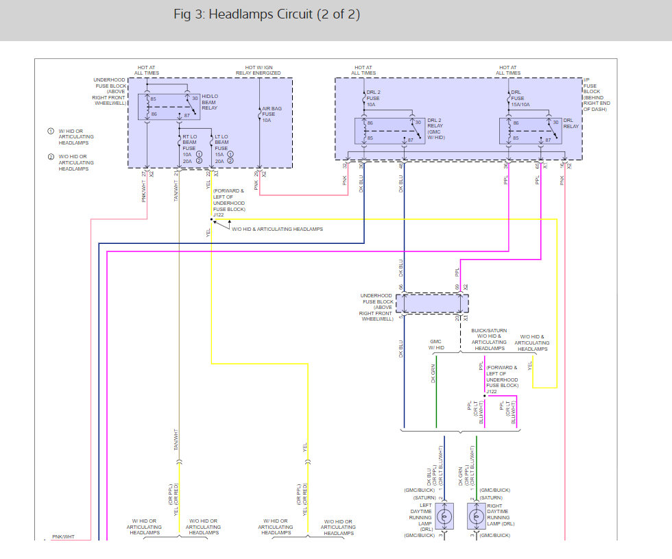

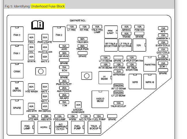

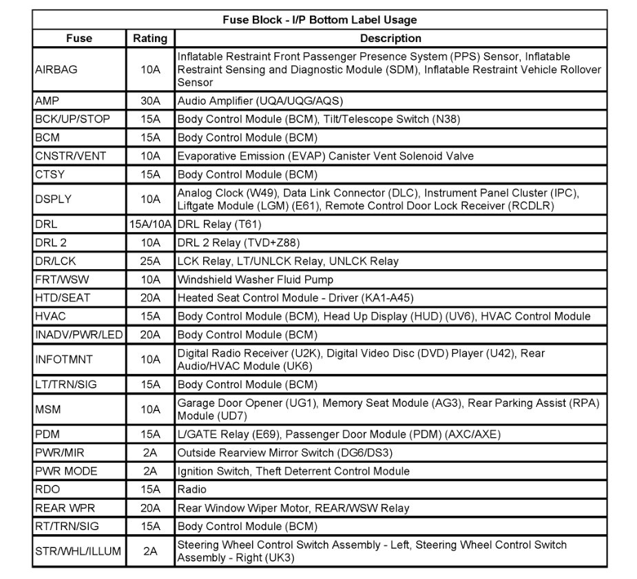

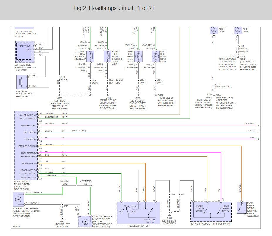

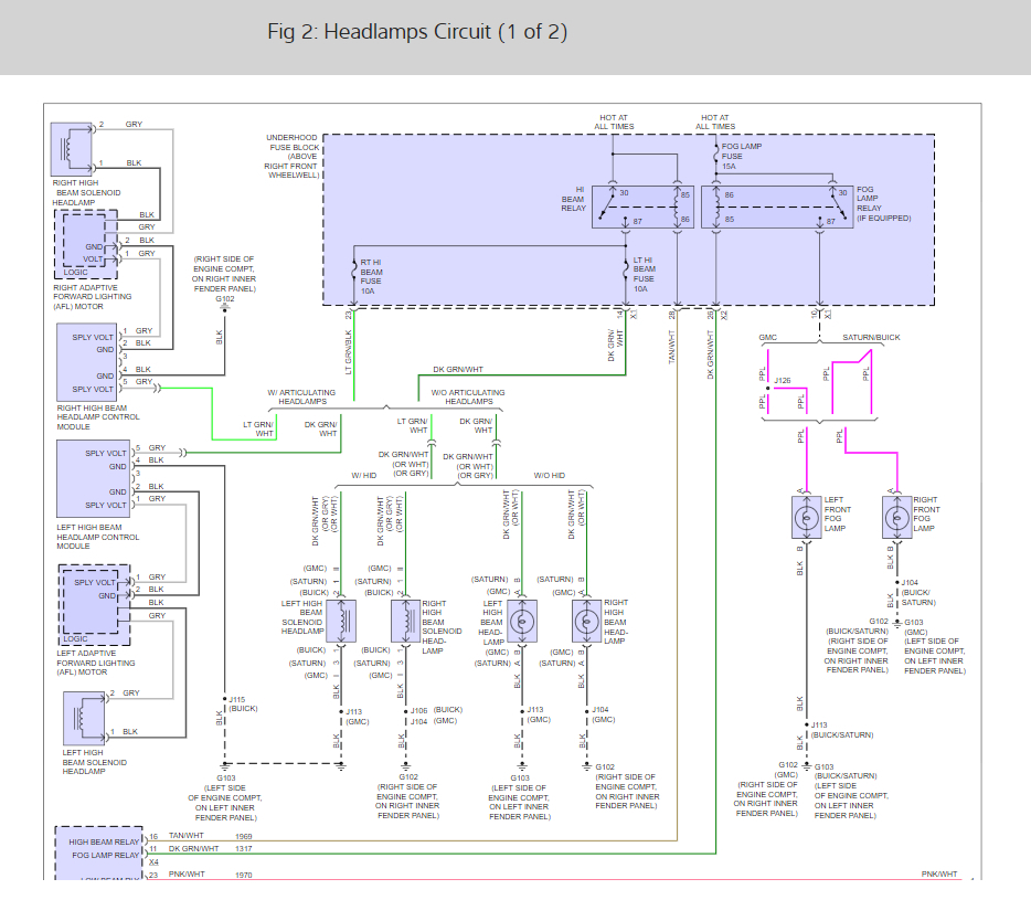

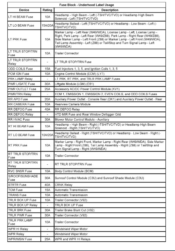

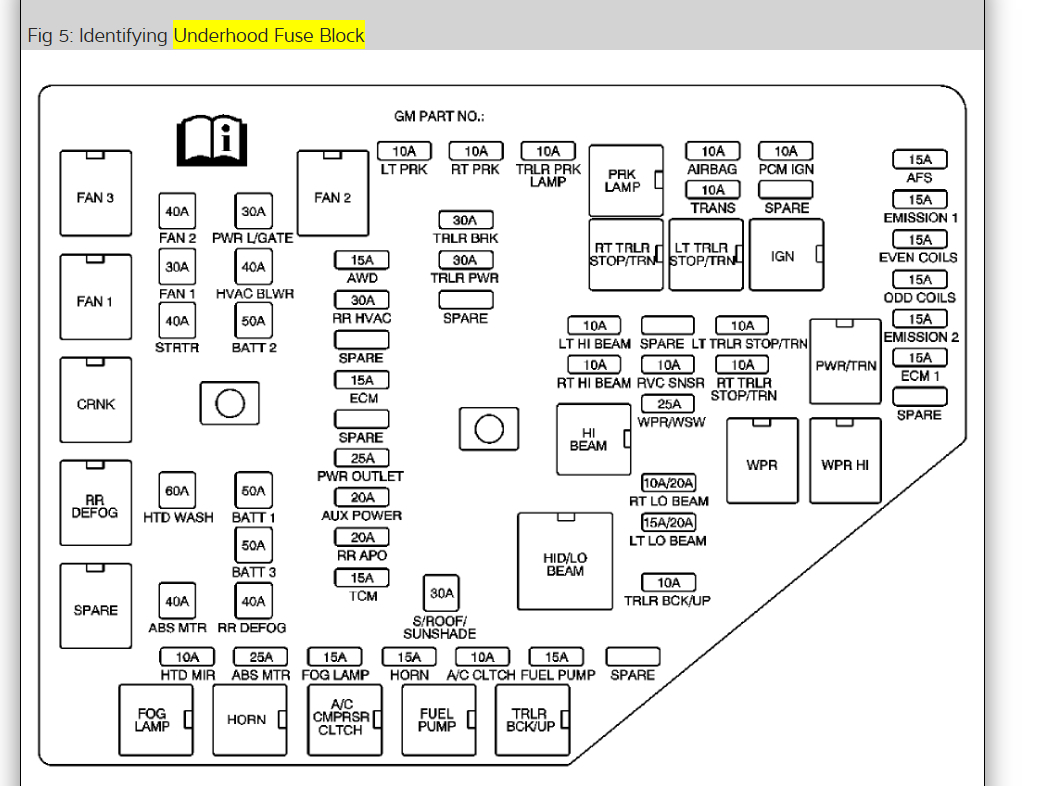

My drivers side headlight doesn't work, along with both fog light, & the high beams
Jun 22, 2019 at 3:04 PM
  • 55,402 POSTS
There are fuses and relays that run the system I would check those first, after that the BCM controls the lights in question so it might be going bad. here are guides to help you check the relays and fuse with the wiring diagrams for the headlight so you can see how it works with location of the fuses and relays as well:
and
Check out the diagrams (below). Please let us know what you find.
