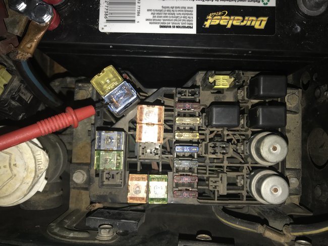

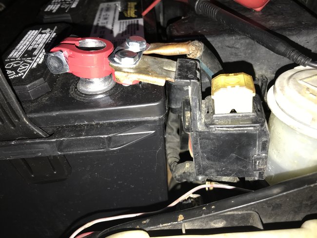

The vehicle does have an aftermarket remote start. I started with that first when testing. I did test all circuits. The only one to show a change in the flow was the generator circuit. I did check the fuse itself. It appears to be clean and unbroken. The only fuse I did not pull was one that comes from the positive terminal on the battery. I was not sure what this fuse was for but I am guessing that it helps to regulate or protect against voltage spikes. I attached the photo of this.

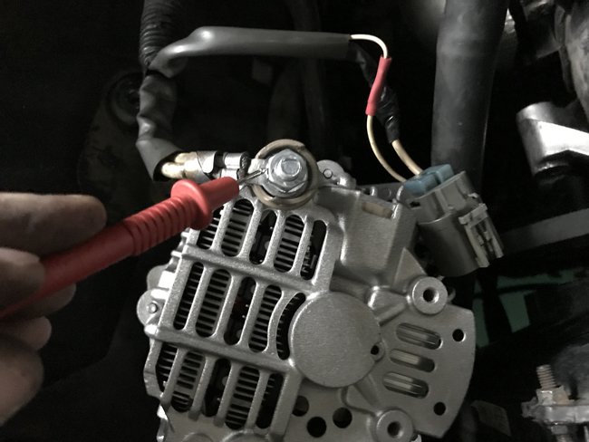

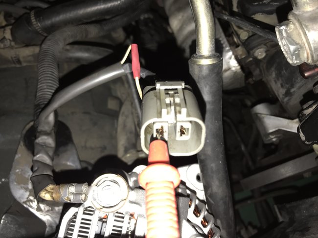

I do not know if this matters but both ends of the alternator cables have power going to them. I tested both cables out and both have 12 volts going to them.

So I really appreciate your help Heyman1104. I ran the drain test and disconnected ignition switch. The drain was still there. I disconnected the alternator and the drain was still there. I went back and checked all fuses again and removed all aftermarket wires and accessories. I tested again and still the only fuse to stop the drain was the one linked to the alternator. or at least I believe it is. I attached a photo of the fuse (it is a 100 A fuse). When I take the fuse out and both cables are attached to both terminals and then place the fuse back the ABS relay clicks. I removed the relay and the drain is still there. I guess it just means that power is being shunted over there bypassing the ignition switch.
