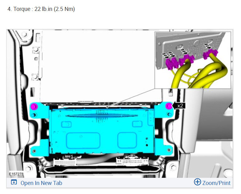

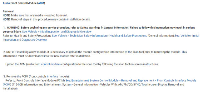

The FACM is located in the center of the dash. Here are the instructions on how to replace the unit in case a code comes up for it. Check out the images (below). Please let us know what happens.
