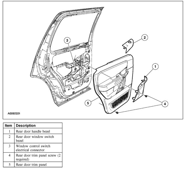

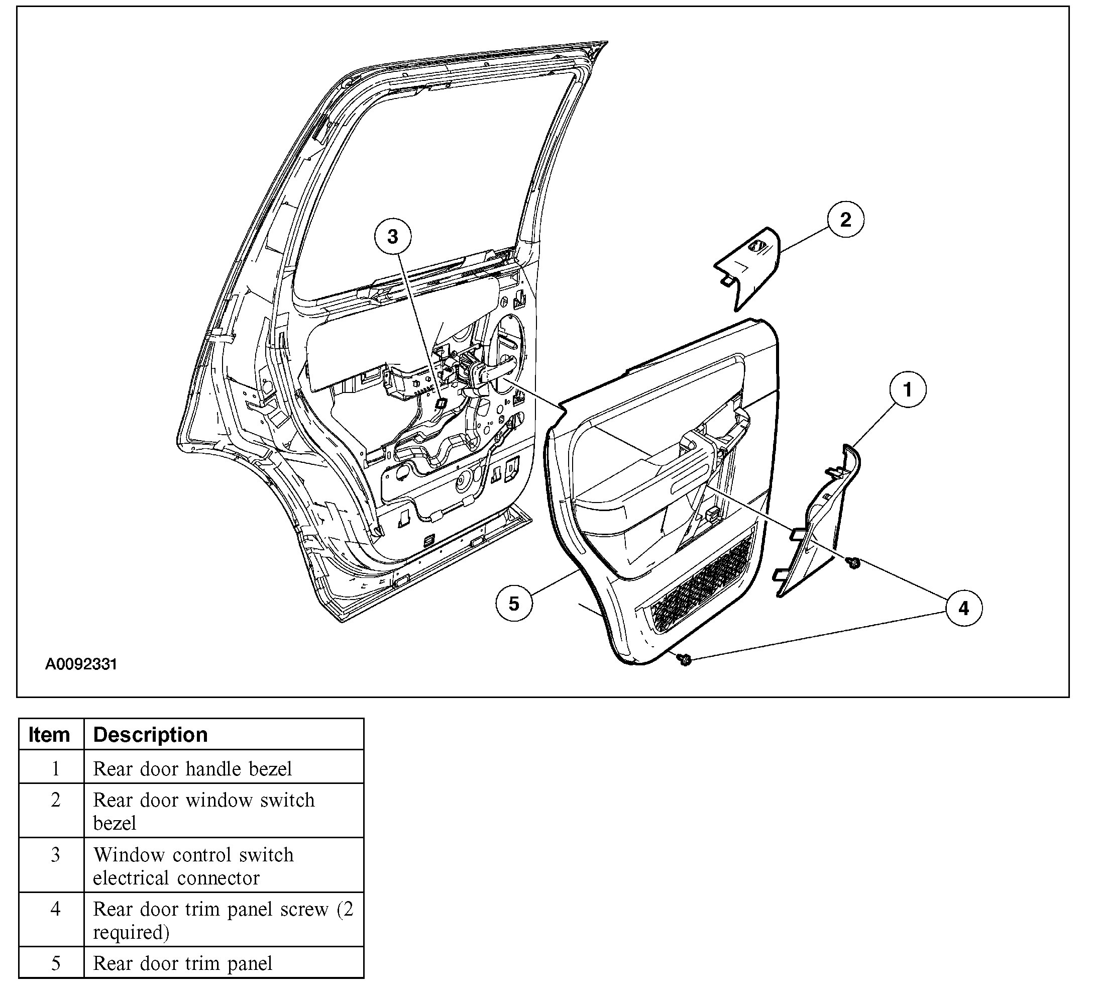

Here are the directions for panel removal. The attached picture correlates with the directions.
_____________________________________________________________--
See Pic 1
Removal and Installation
1. Remove the rear door handle bezel.
2. Remove the rear door window switch bezel.
3. Disconnect the window control switch electrical connector.
4. Remove the 2 rear door trim panel screws.
5. CAUTION: To avoid damaging the trim panel, do not pull directly outward to carry out this step.
Lift the door trim panel by pulling directly upward on the armrest to disengage the panel clips.
6. To install, reverse the removal procedure.
