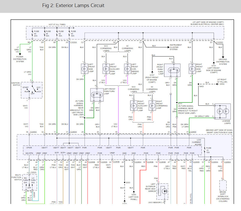

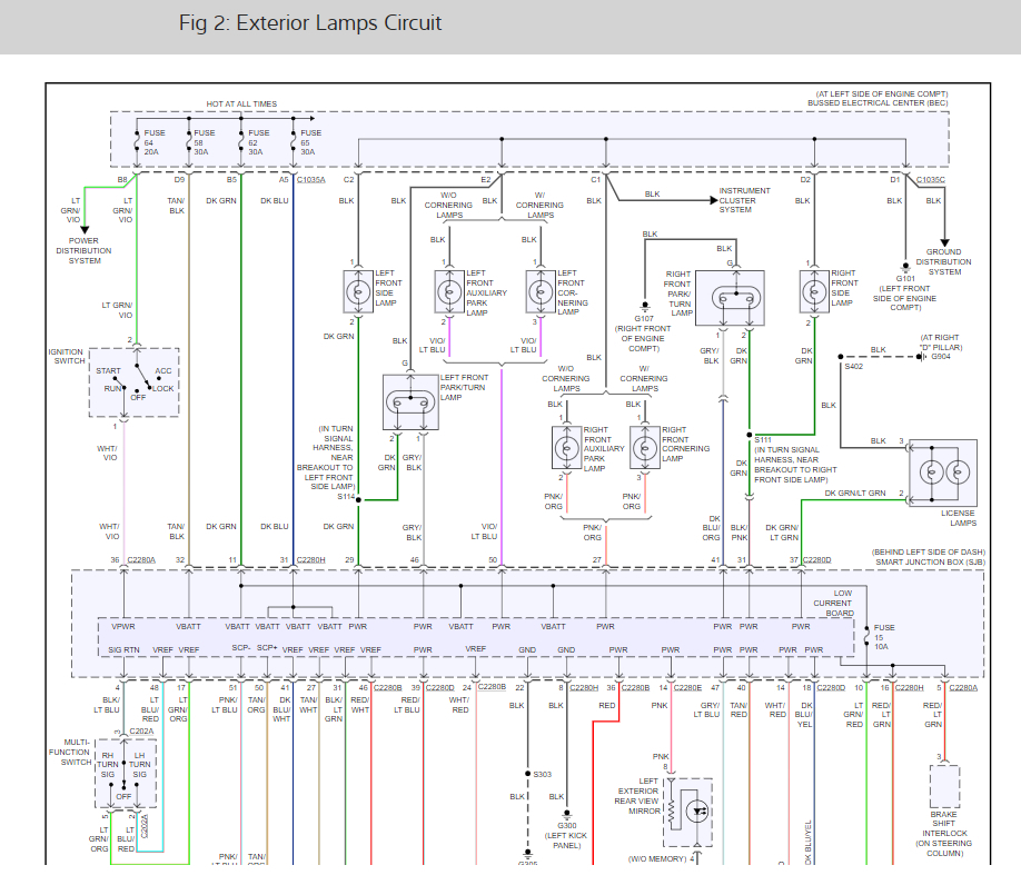

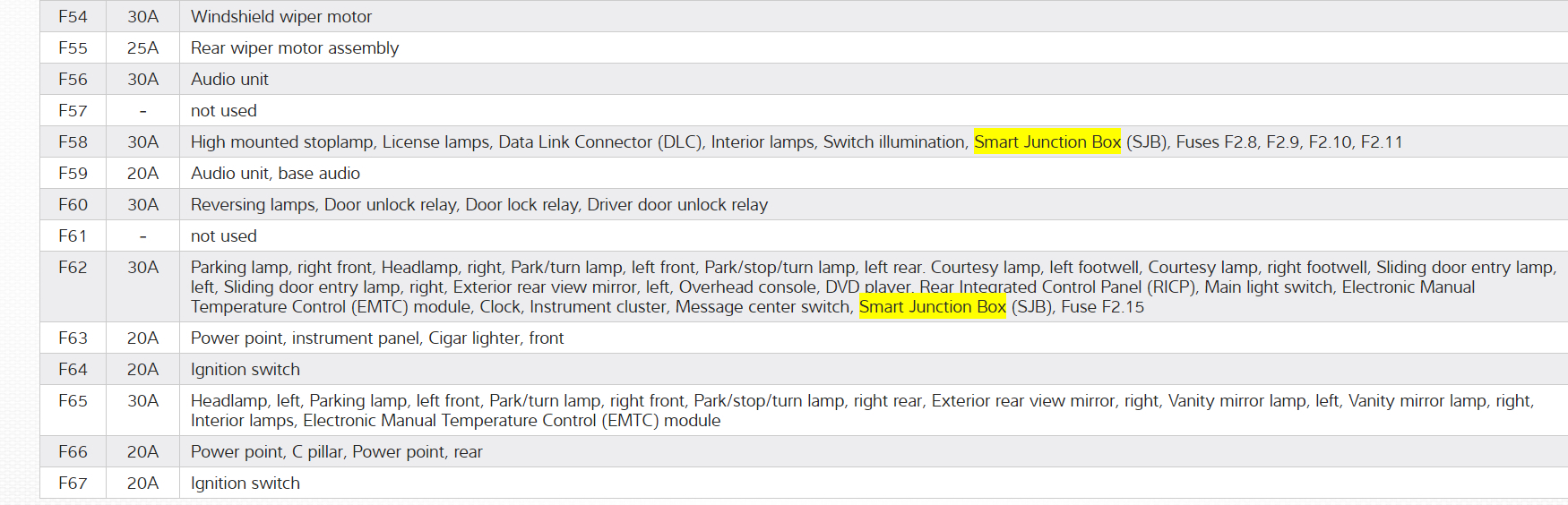

Driver's side rear taillight and signal not working
133,000 MILES • 4.2L • 6 CYL • 2WD • AUTOMATIC
FRANK SNODGRASS
Bulb works fine with lights.
Sep 25, 2019 at 9:00 AM
  • 55,770 POSTS

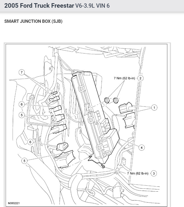

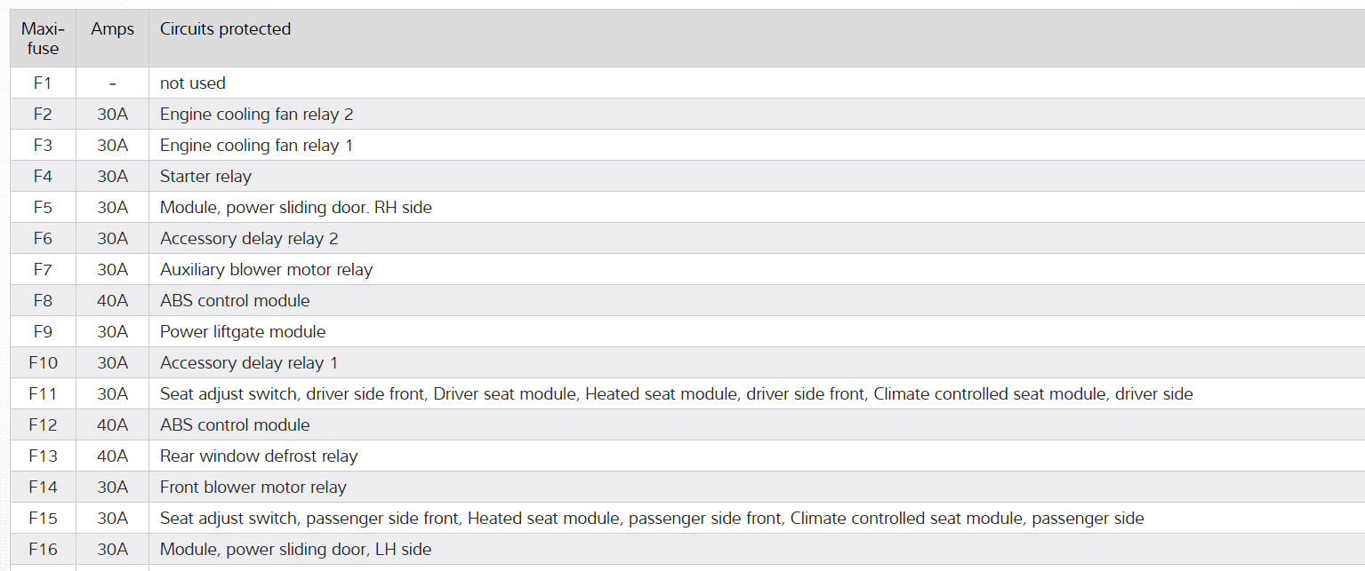

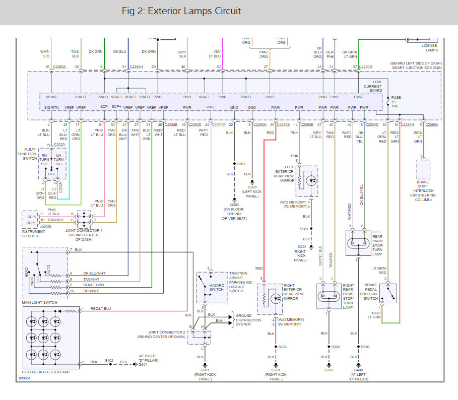

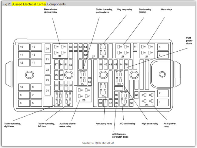

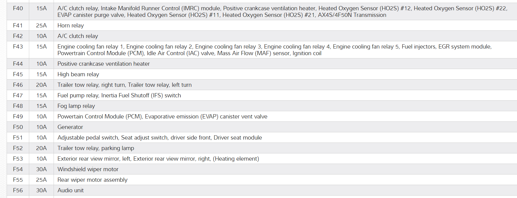

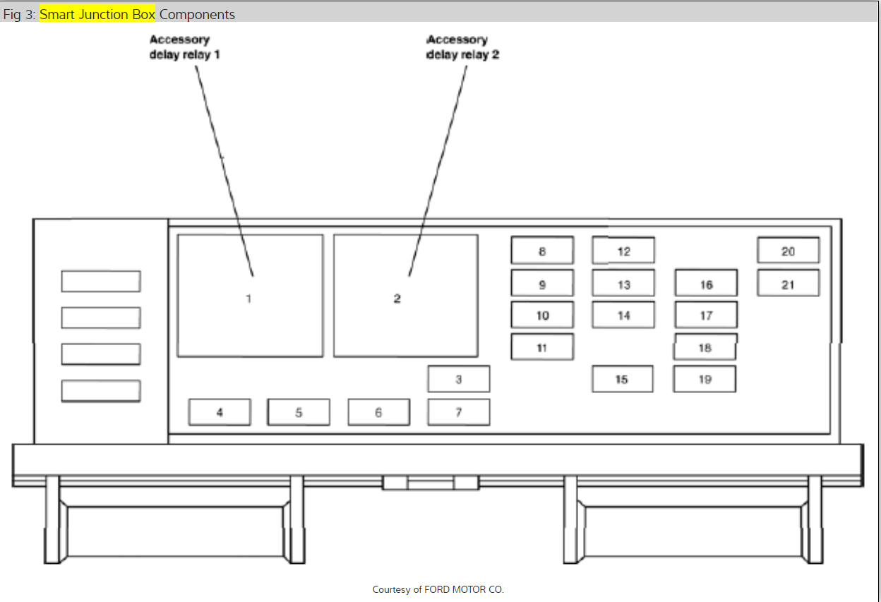

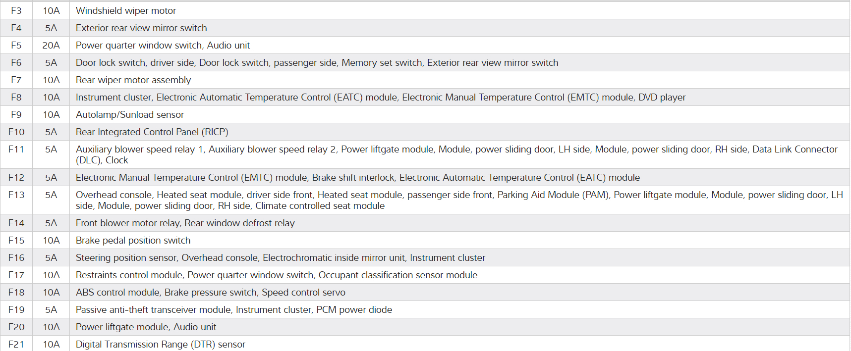

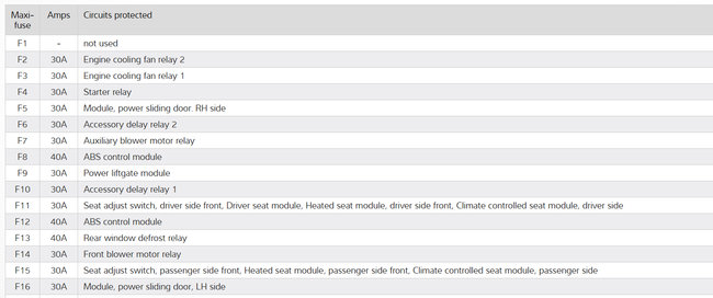

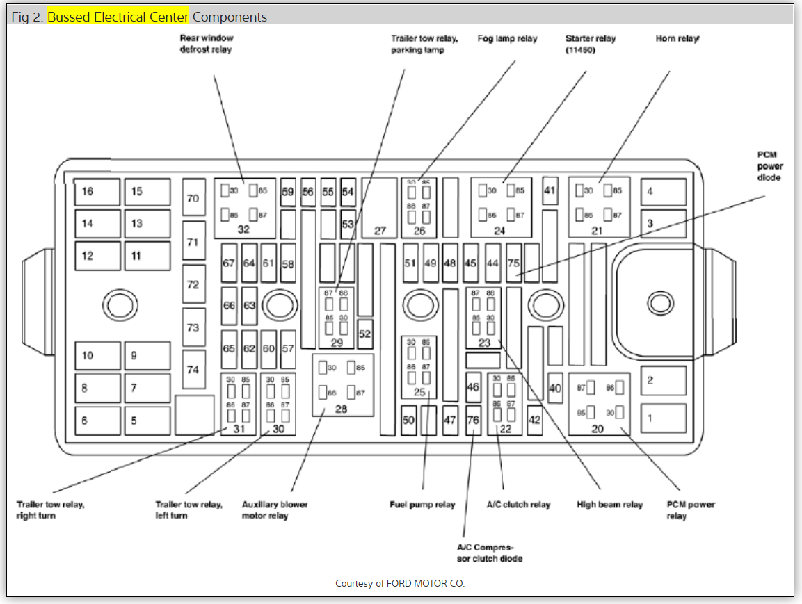

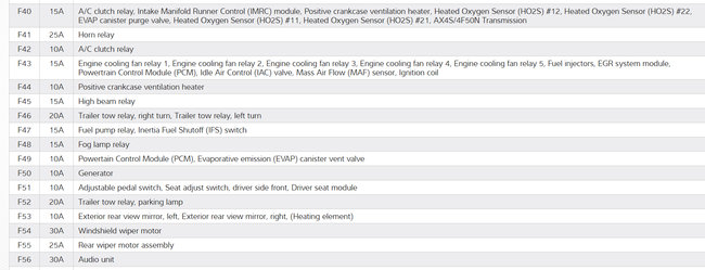

There are 4 fuses that run the system that need to be checked first. here is a guide to help test the fuses and the fuse locations well with the turn signal wiring diagrams so you can see how the system works and which fuses to check:

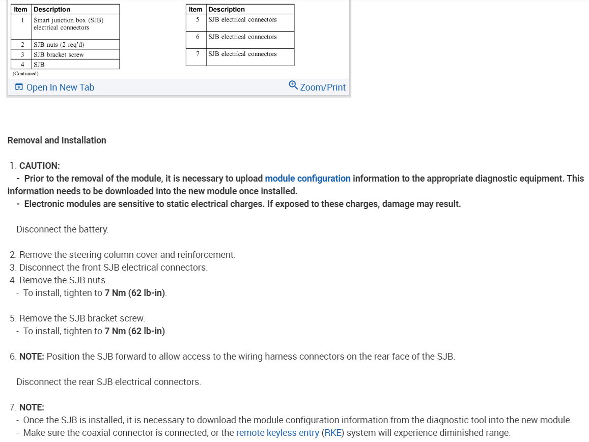

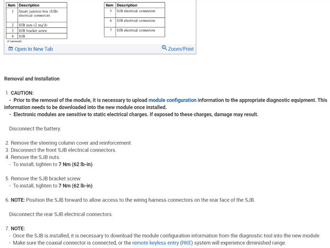

If the fuses are good chances are the smart junction box (BCM) will need to be replaced which I have included instructions for as well. Check out the diagrams (below). Please let us know what you find. We are interested to see what it is.
