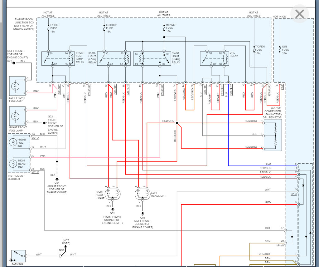

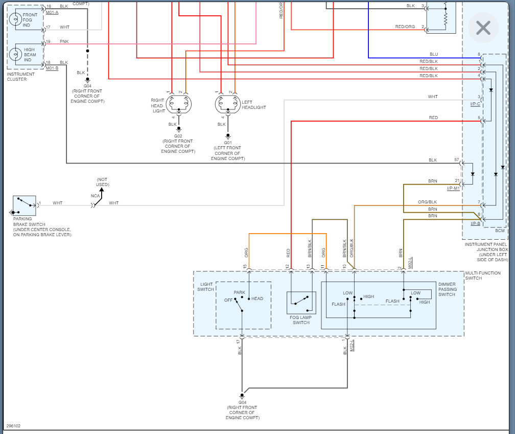

The odometer and speedometer are most likely related, but the headlights are most likely not. So, I would suggest we start with the headlights and if that happens to fix the others then that is great. However, if not, then we most likely have a speed sensor or cluster issue.
So, let's check the voltage coming out of the relay going to the head lights.
Here are a couple of guides that will help with this:
I am attaching the wiring diagram below so let's start with this and we can go from there.

Headlights are working again. I'm thinking it's a bad light switch because now the front parking lights and the cluster light have gone out. i have no codes.

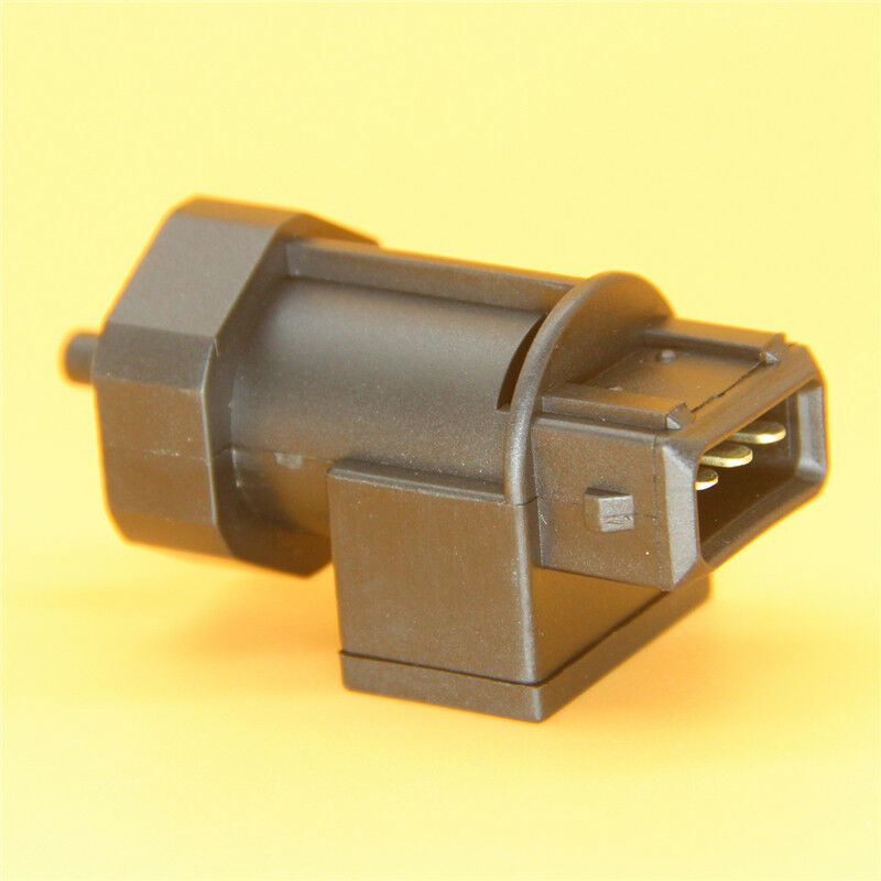

Just so you know, i replaced the transmission speed sensor (manual transmission) and one wheel speed sensor.
Apr 12, 2022 at 1:34 PM
Okay. Can you get a picture of the speed sensor that you replaced in the transmission? I just want to verify this was the output sensor.

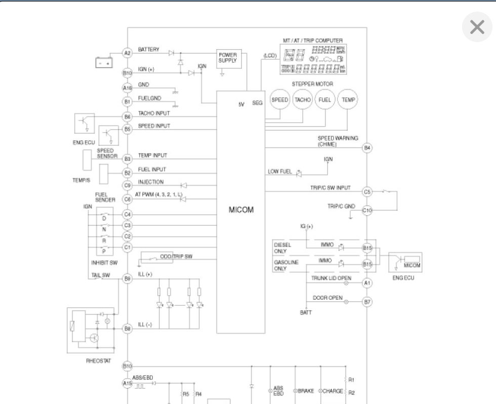

Also, if this is ok then the likely cause of this is the cluster itself. This cluster has a logic circuit board that takes the speed sensor input and displays the speed and odometer. So, if this is getting a speed signal then the cluster is the likely issue.

Sorry for the delay.
