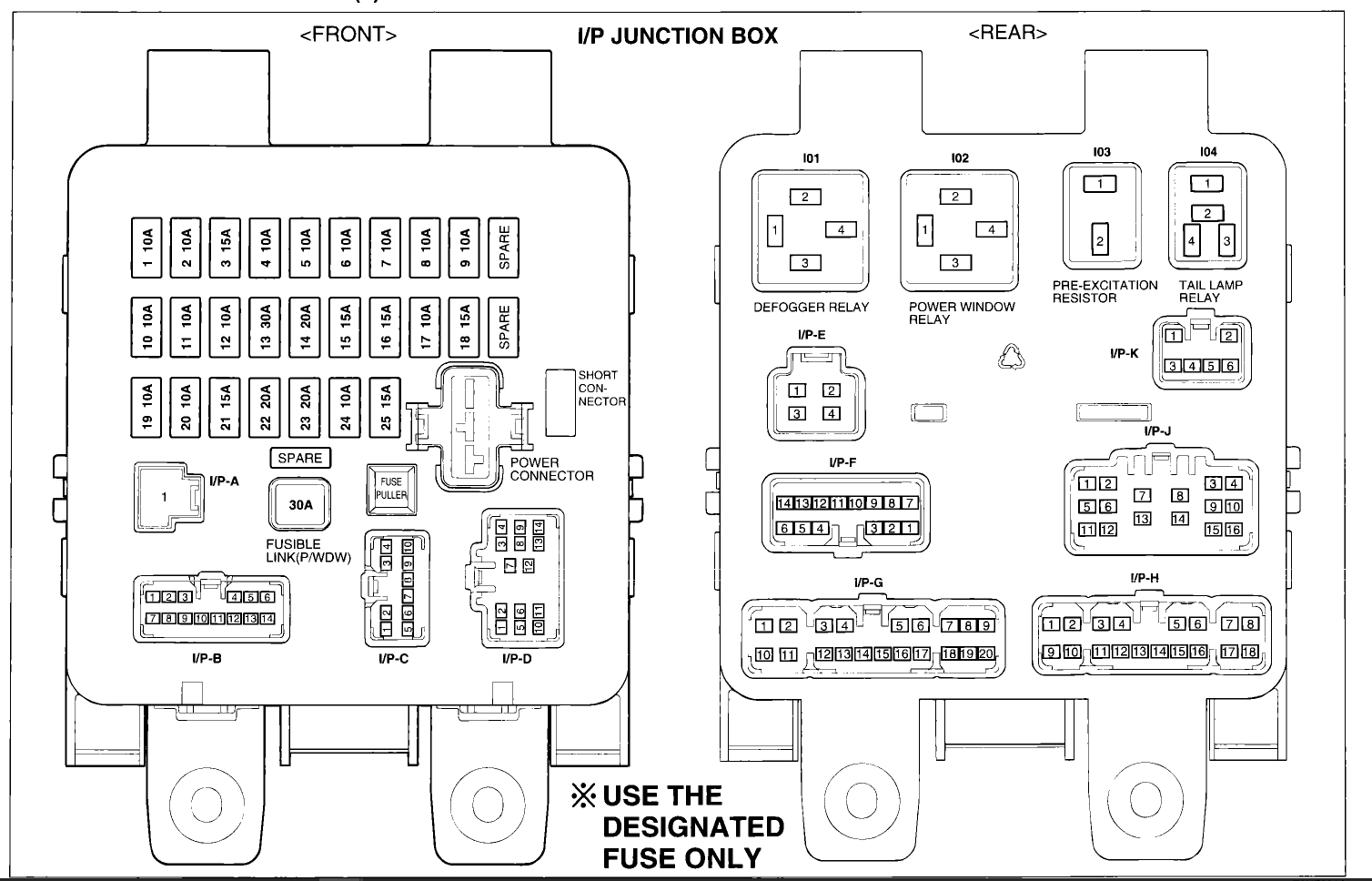

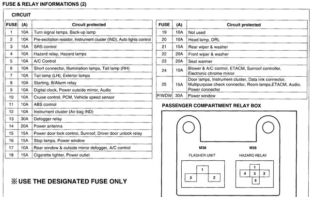

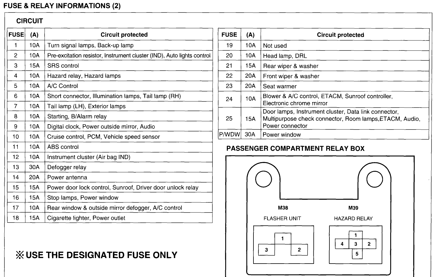

Fuse blown for power port , replaced fuse . Now the radio,clock, and interior lights don't work. Replaced fuse still will not work.
Dec 12, 2019 at 1:22 AM
Experienced Mechanic
55,711 POSTS

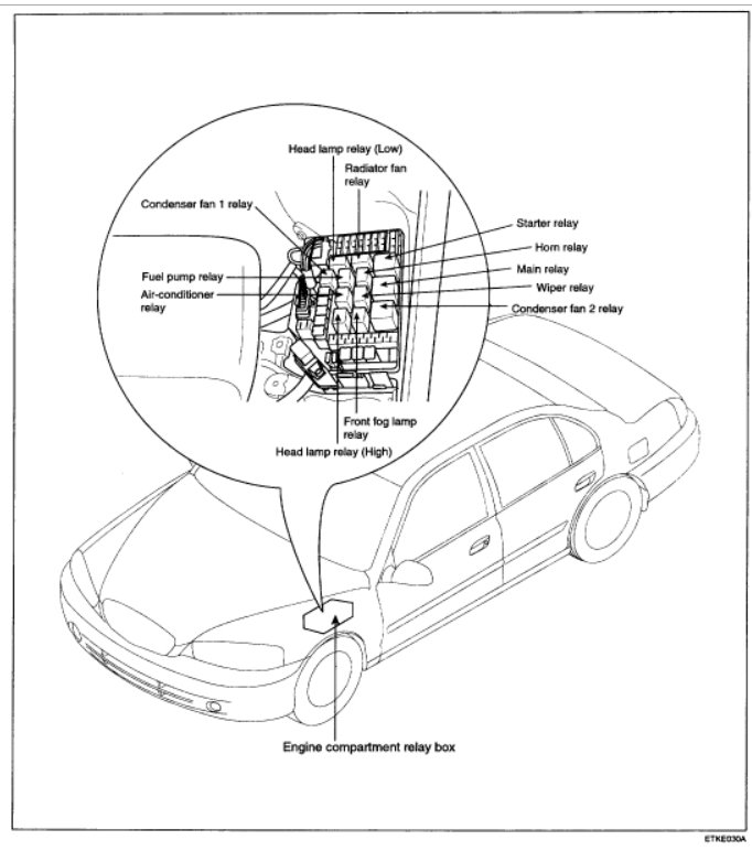

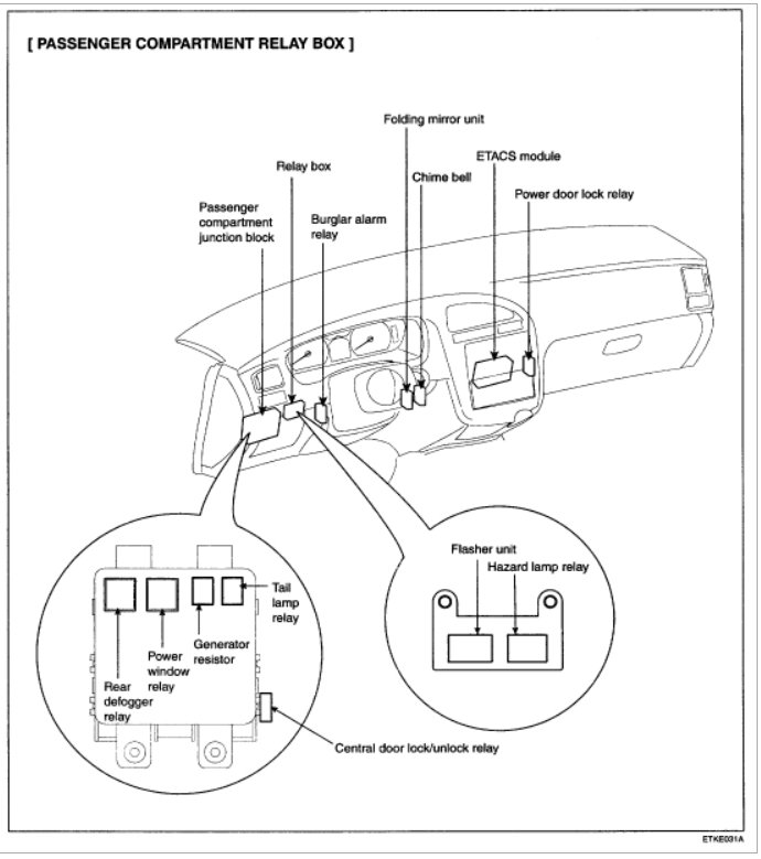

Do you have power at fuse #18 in the interior fuse panel? Here is a guide to help and the fuse location as well:

Interior fuse panel is different.
Dec 13, 2019 at 10:09 PM
55,711 POSTS
Can you take a picture please? it's all i show.
