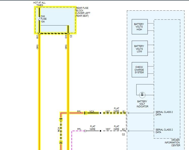

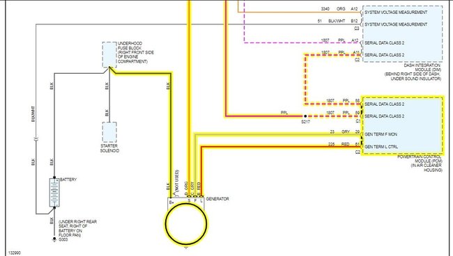

Within the last week I have installed speakers with amp and interior LED lights. Last night the lights near my speedometer went out and this morning it would not crank. Nothing came in but the phone charger light. I do have a second battery in my trunk for all accessories. I also have a car alarm, push button start system and rear camera installed and all are on the same wiring

Good morning,
What is the battery voltage with the key off?
What is the battery voltage when the engine is running?
How much current is the amp rated at?
I attached a diagram for you to view. We need to do some testing to see if the alternator is any good.
