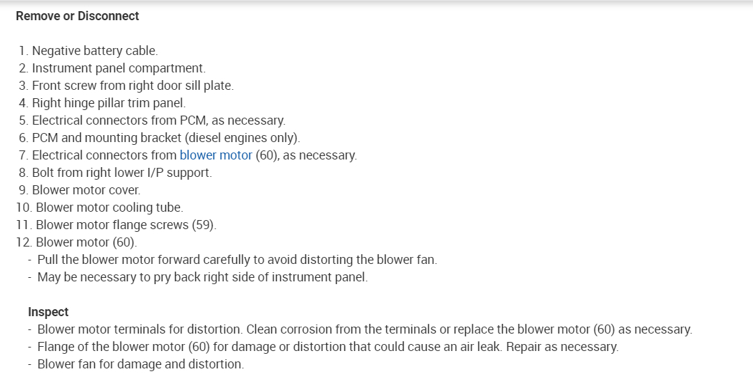

Smells like antifreeze and something burning. When I turned the heater on it took a lot of power, I heard it. And the battery gage went way past 14. I didn’t drive it and it didn’t come close to warming up. The heater has been squealing a lot. It’s been very cold outside.
Dec 29, 2022 at 8:20 PM
  • 55,721 POSTS

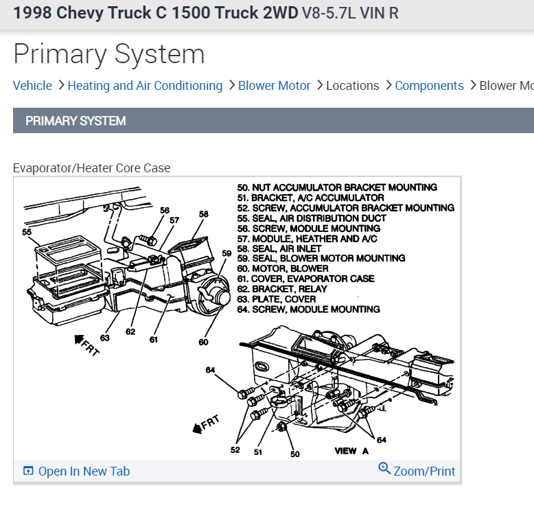

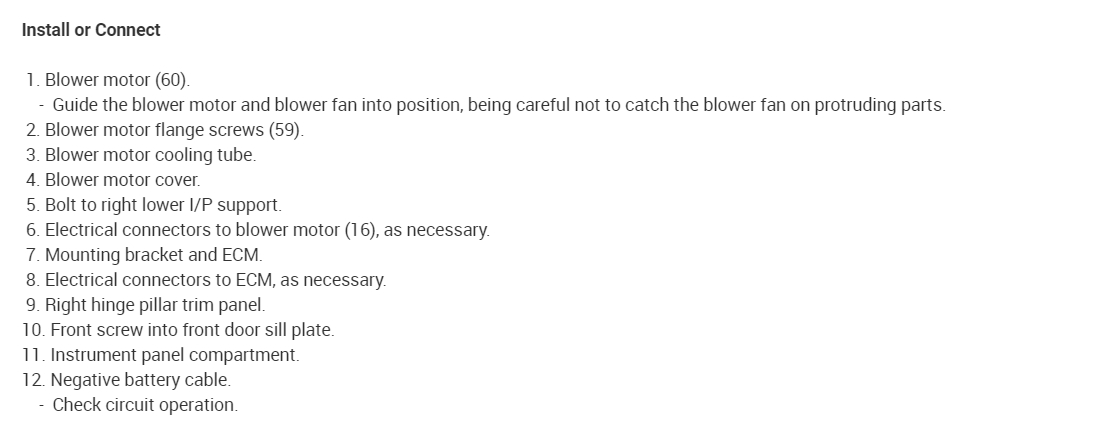

This happens when the blower motor shorts out. here is the location and a generic step by step guide to help walk you through the repair with instructions for your car in the images below.
https://www.2carpros.com/articles/blower-fan-motor-works-on-high-speed-only
Check out the images (below). Let us know what happens and please upload pictures or videos of the problem.
