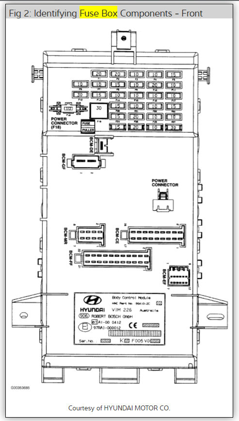

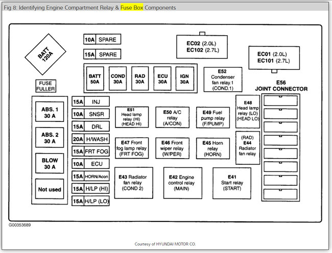

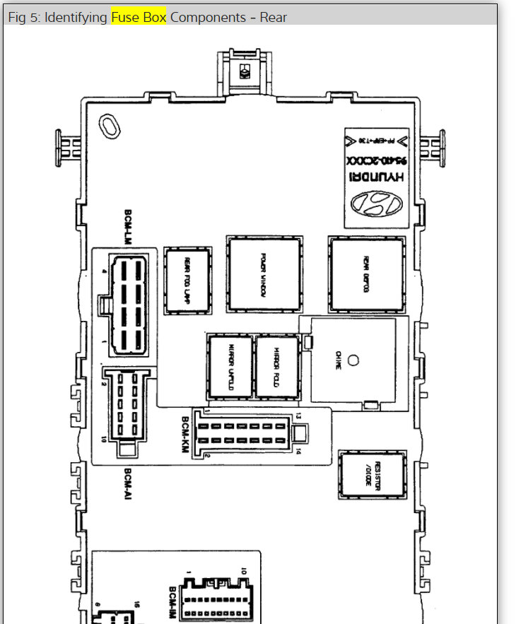

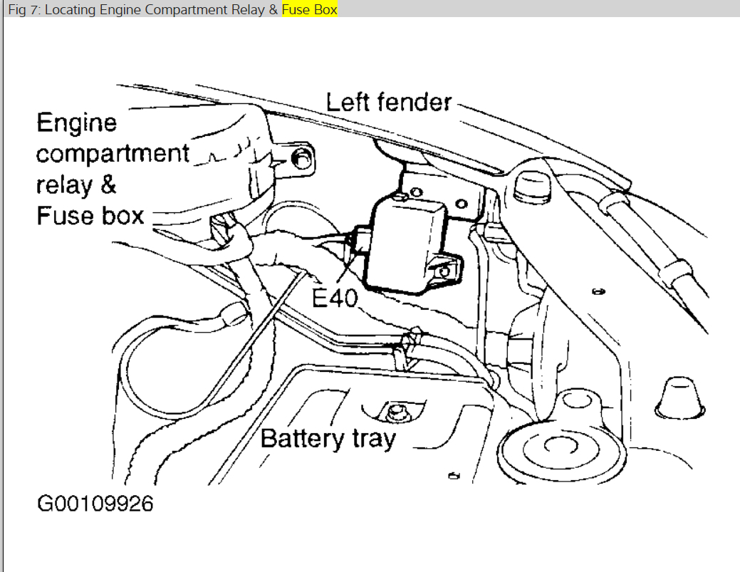

Battery was put on wrong by a friend, engine starts but have no stereo, heating or fans. Fuses have been checked.
Help
Feb 21, 2019 at 11:28 PM
Experienced Mechanic
55,743 POSTS
Hi Sara,

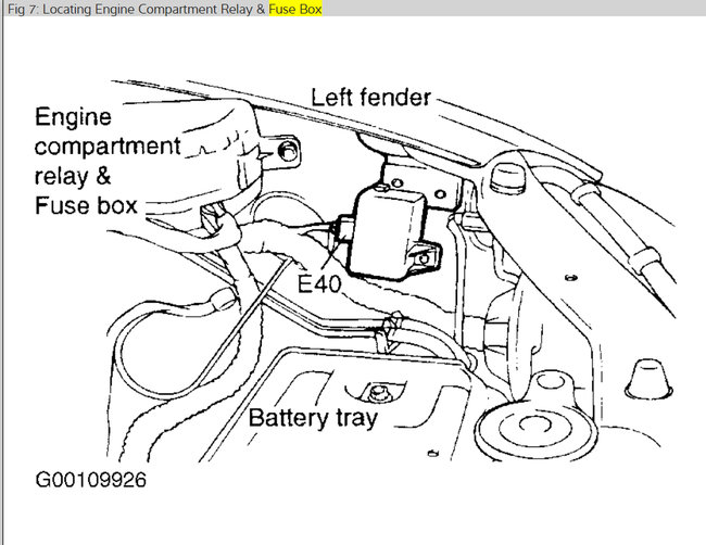

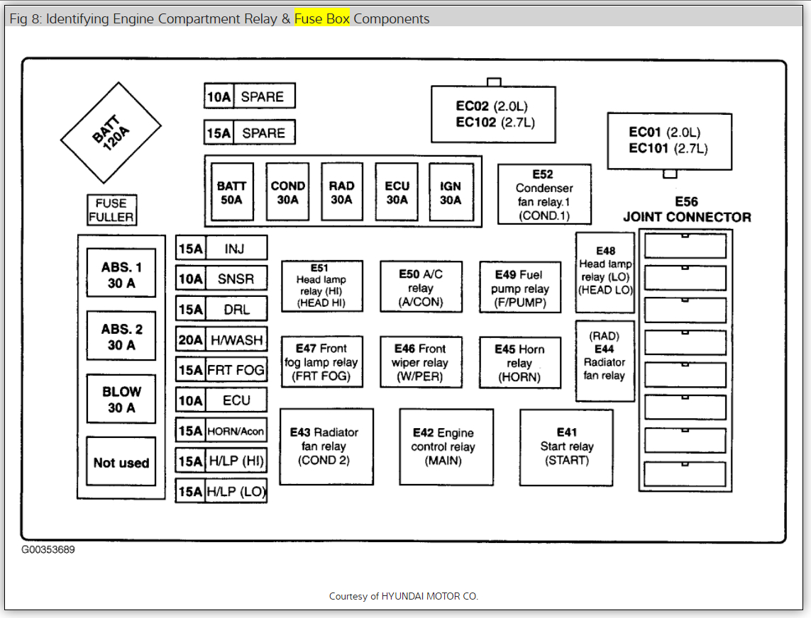

It sounds like you have a power connector #18 fuse that is out. here is a guide to help you test to confirm and the fuse location below:
Images (Click to enlarge)
