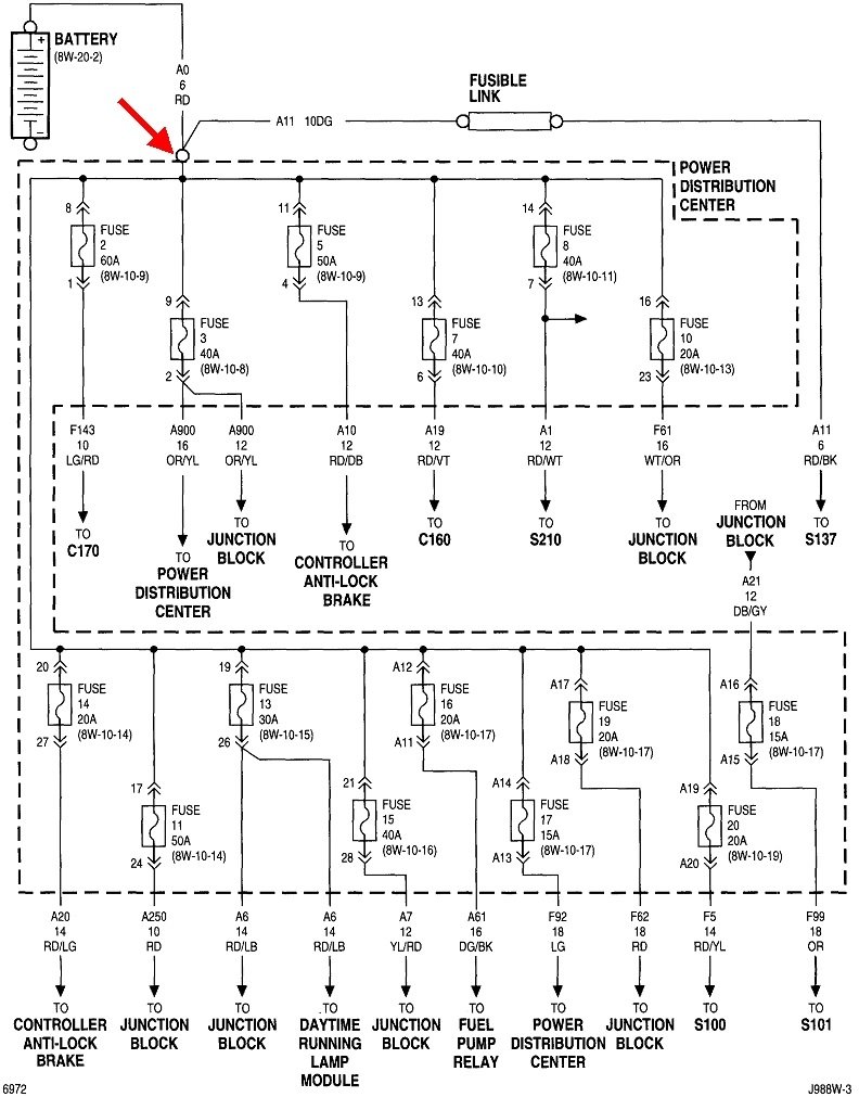

I got it from my cousin who messed the ignition switch transponder and everything else up I got another one and the PCM or whatever that matched but it still will not crank. Nothing on the dashboard works or power windows. I would like to have an idea what it would cost for a mechanic to fix it I give up.

If everything is dead, including interior lights and the instrument cluster, the best suspect is a loose or dirty battery cable. Start by checking both cable clamps on the battery posts. If those are okay, follow the smaller positive wire to the under-hood fuse box and check that connection. That's the cause of everything being dead, sometimes intermittently, on all car brands. That's the red arrow in this diagram. Also follow the smaller negative wire to the body and be sure that connection is tight and not rusted. Let me know what you find.
