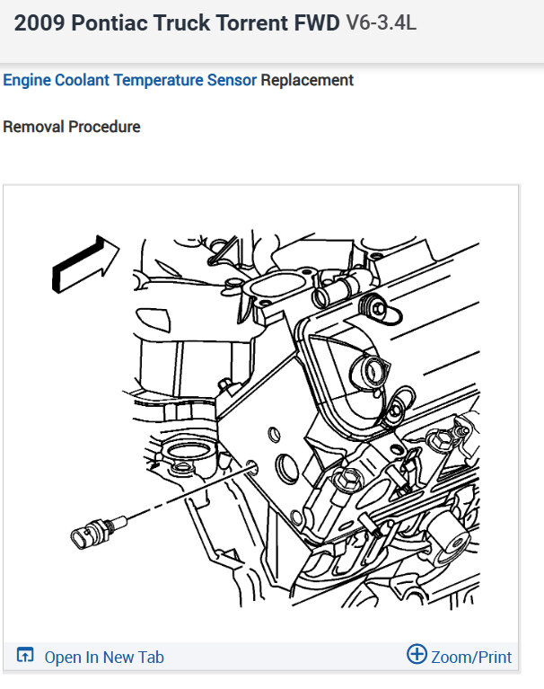

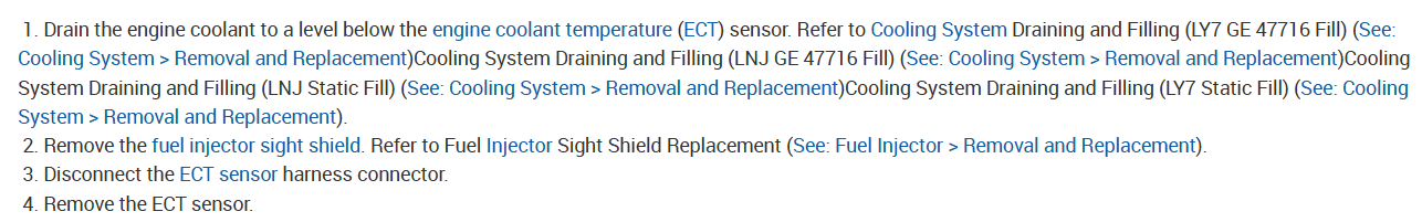

Because you have a check engine light on I would run the codes to confirm the engine coolant sensor is out of range. Here is a guide to help you run the codes and the sensor locations as well.
