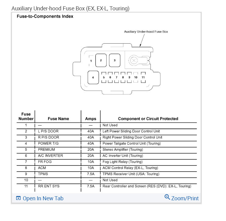

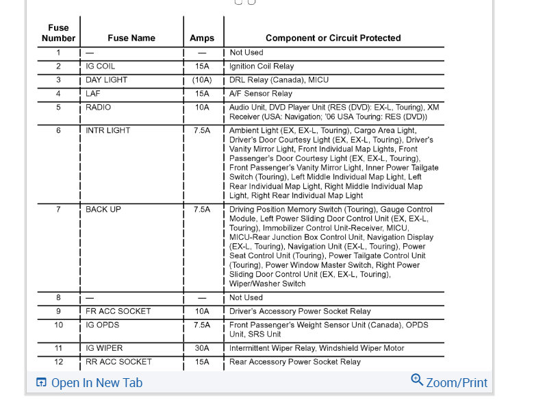

My turn signals will not work, my rear wiper does not work, my outside temperature is blank line, my front wipers will not work on intermittent, and my headlight indicator does not display but headlights do work.
Nov 7, 2019 at 11:13 AM
  • 55,399 POSTS

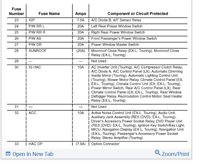

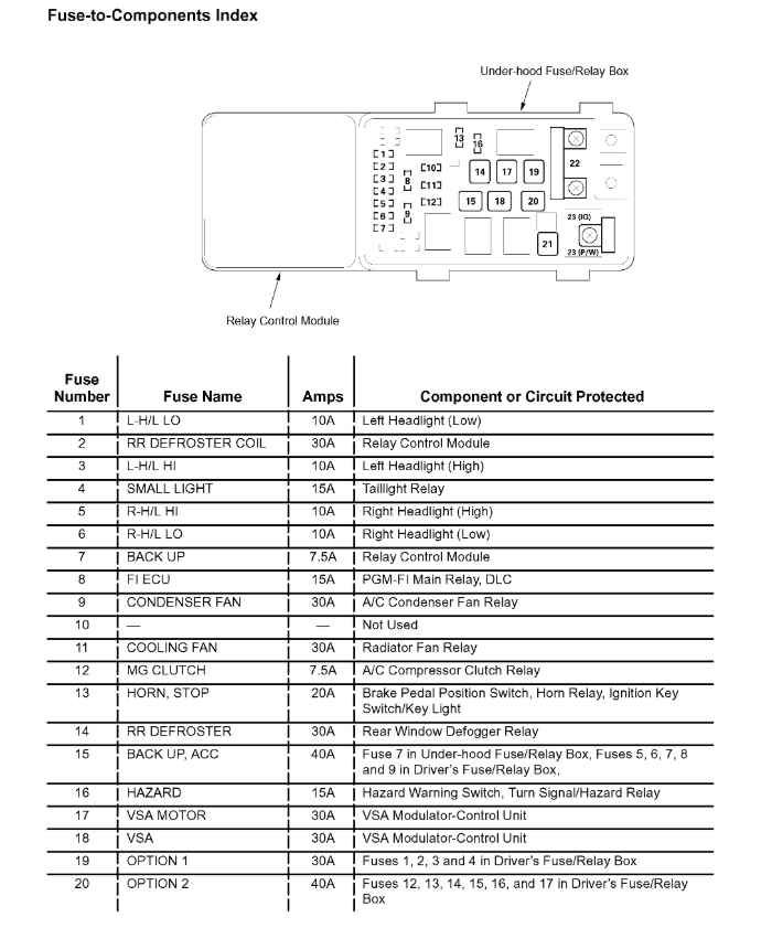

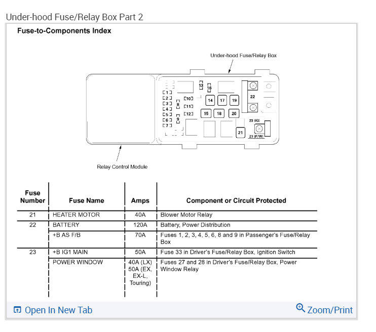

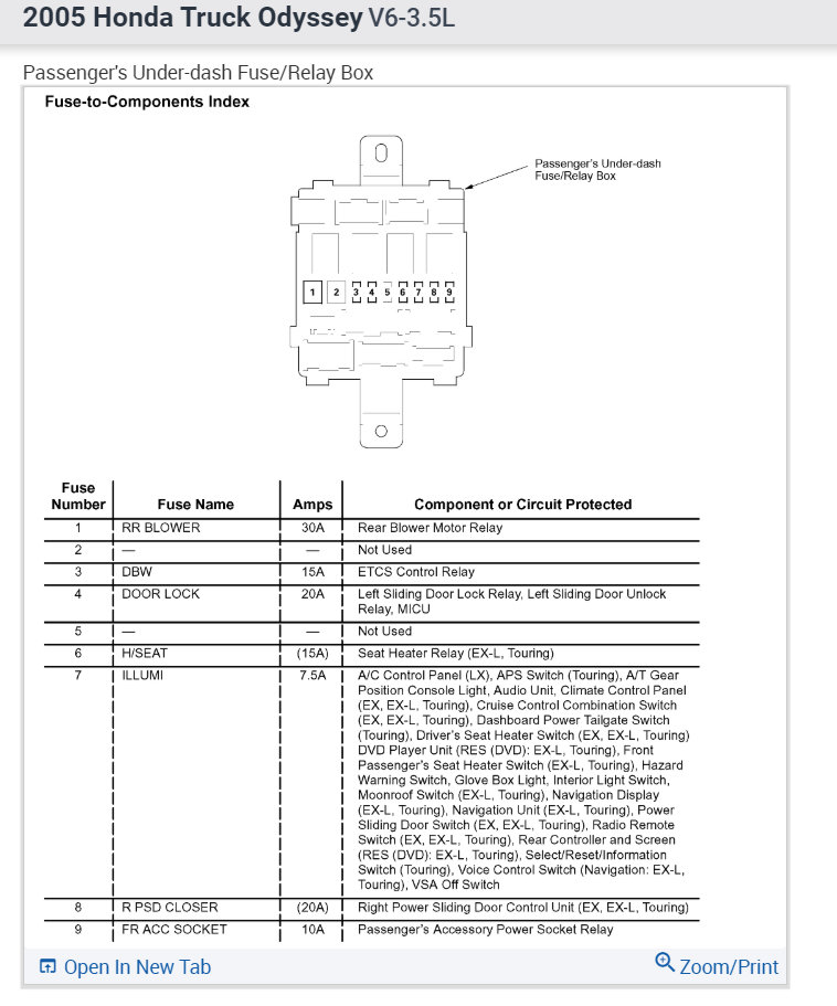

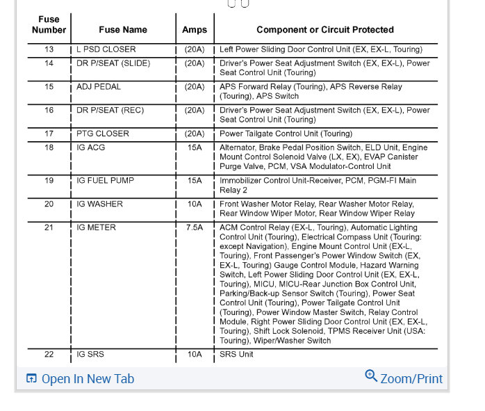

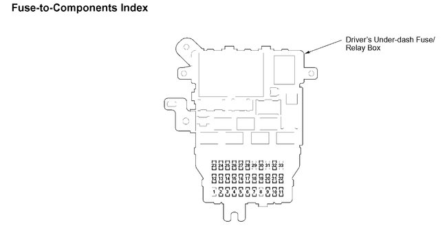

It sounds like the MICU in the fuse panel has gone bad. To be sure let's start by checking the fuses here is a guide and the fuse location in the diagrams below:
Key on start with he fuse panel under the hood. Check out the diagrams (below).
You can use a CAN scanner that will tell you as well.
