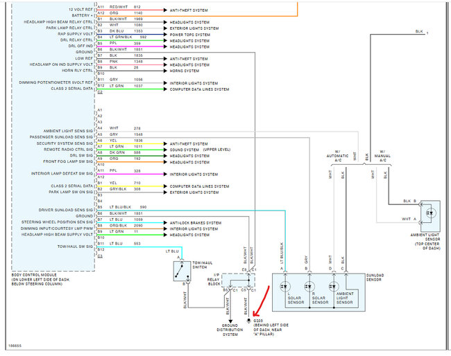

Blower motor not working/dome lights flash on and off/ stalls when making tight turns at slow speeds/windshield wipers won’t cut off after being turned on until I shut the truck off and turn it back on. I can smack the dash, and it makes a difference for the dome lights going on and off.
Jun 5, 2025 at 12:30 PM
  • 55,442 POSTS

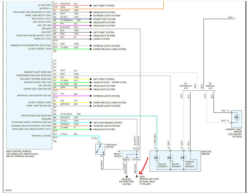

Yes, it sounds like you have a bad system ground for the BCM. Here is how to check the grounds for the BCM and I have included a wiring diagram to show the grounds and their locations.
Check out the images (below). Let us know how it goes.
