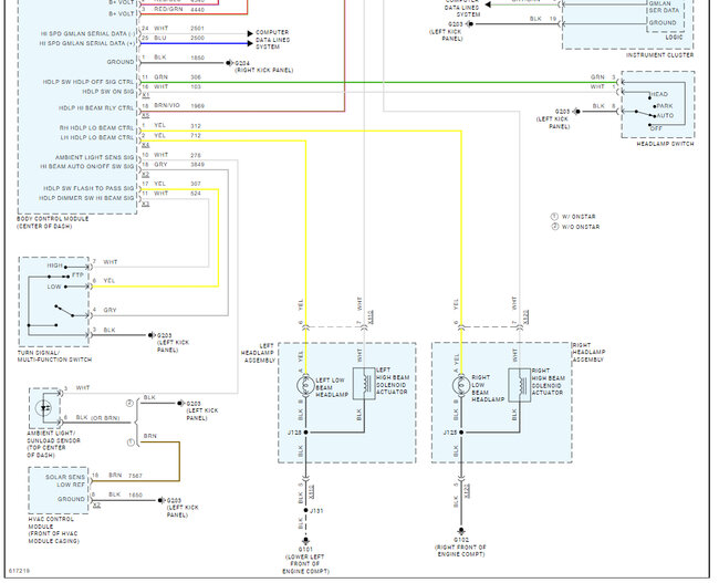

Drivers side headlights not working?
2018 CHEVROLET MALIBU
90,000 MILES • 1.5L • 4 CYL • TURBO • 2WD • AUTOMATIC
MARKN60

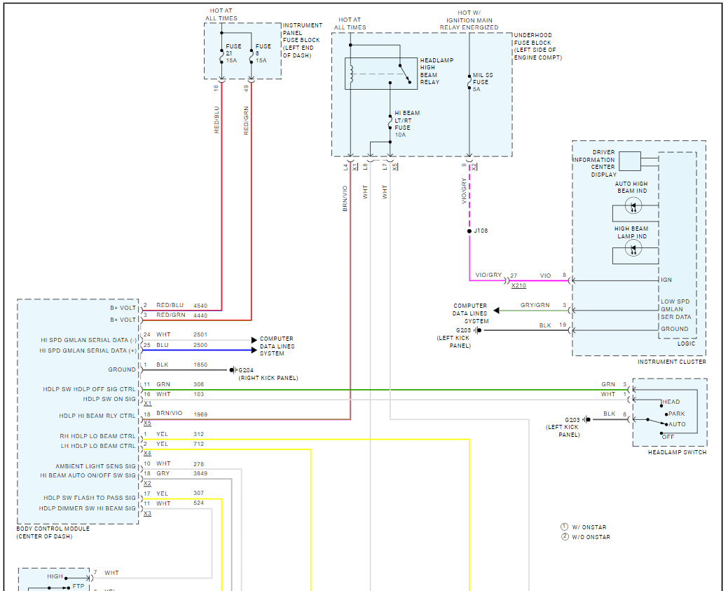

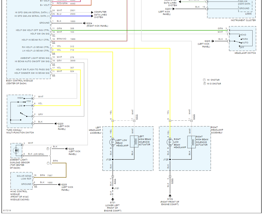

I changed the bulb and checked the fuses. Have power at bulb socket. Think I might have a bad ground? Was wondering if I could get a wiring diagram? Thanks
Oct 16, 2024 at 7:13 AM
  • 55,423 POSTS
Yep, if you have power the problem can only be the ground, this guide can help you test it, and I have included the headlamp wiring diagrams below.
