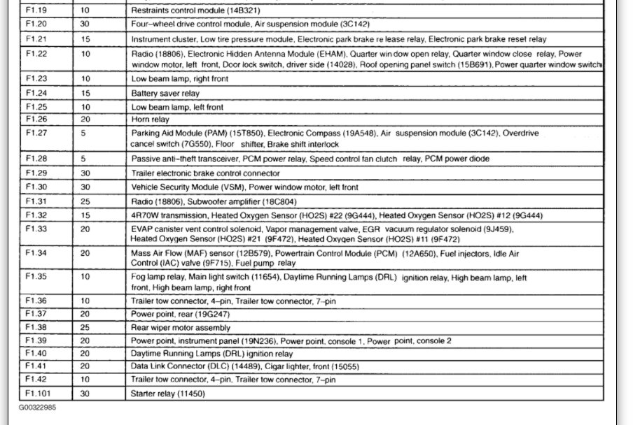

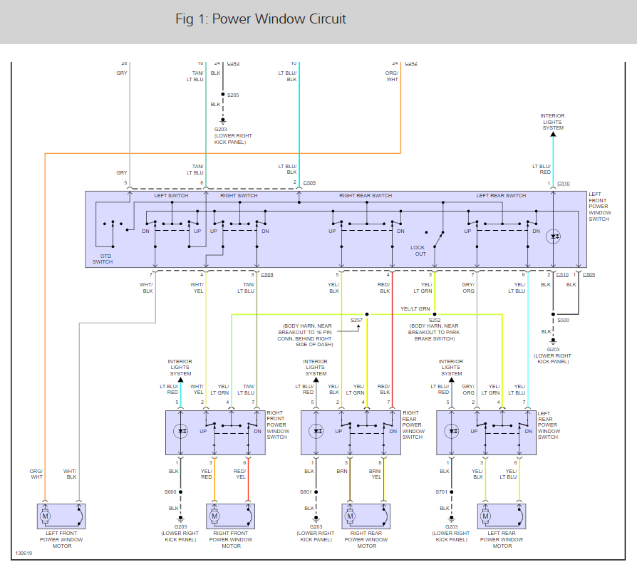

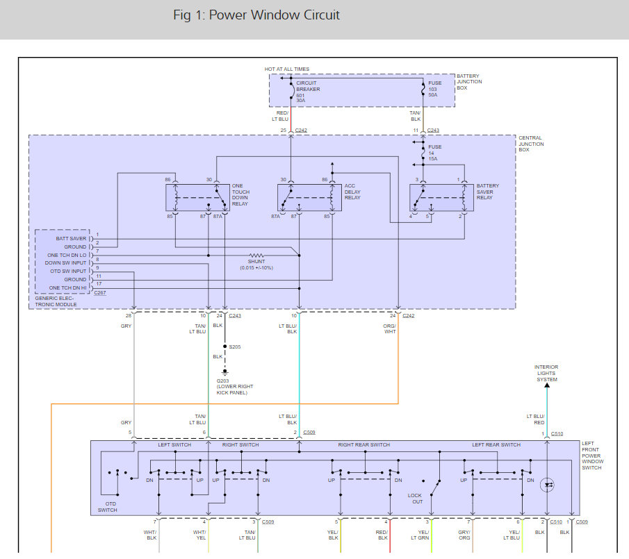

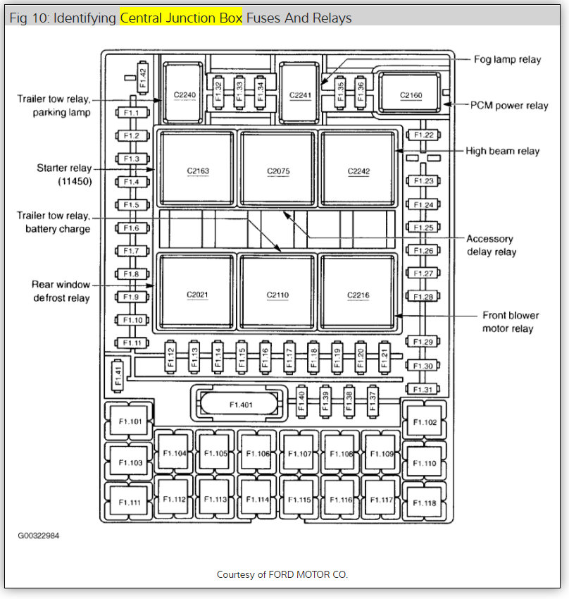

My power windows, rear AC and dome light do not work at all and my compass just reads -40 degrees south. All of the fuses are good the only thing left I believe is a relay or I do not talk to wire somewhere and only place I could be is underneath the dash where there is a bunch of alarm wires. Please help please help.
Jul 14, 2018 at 11:34 PM
  • 55,214 POSTS

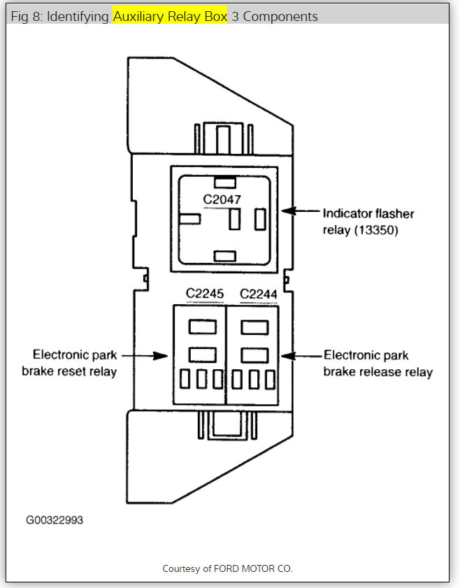

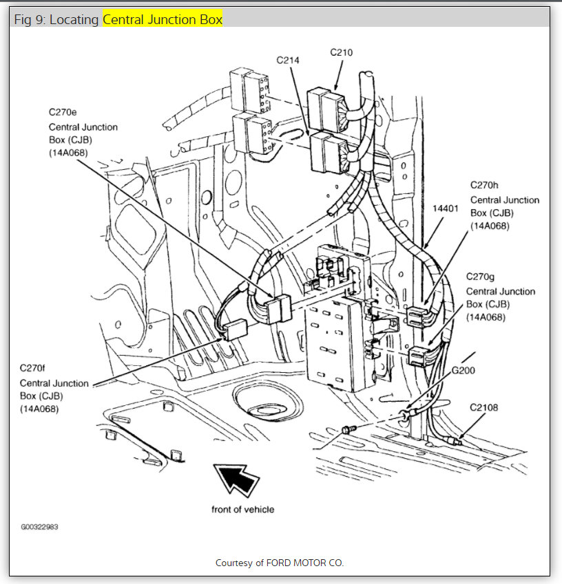

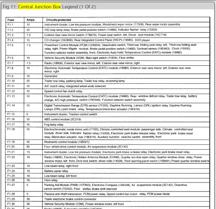

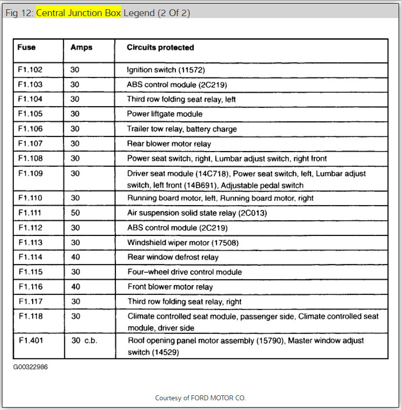

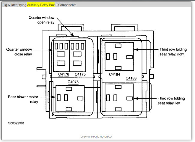

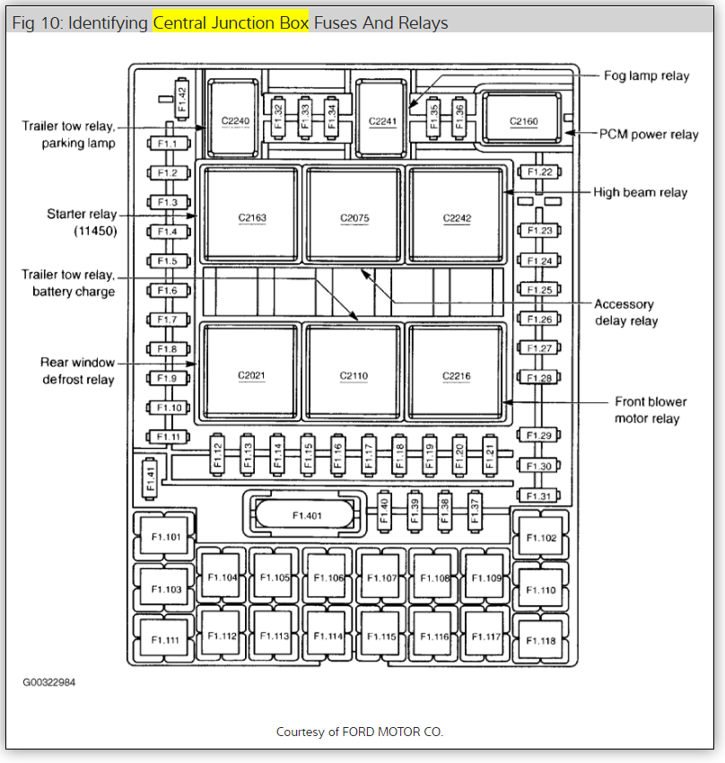

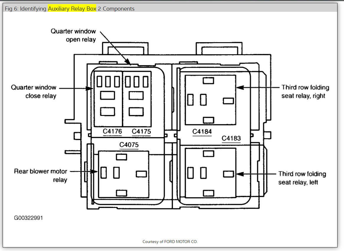

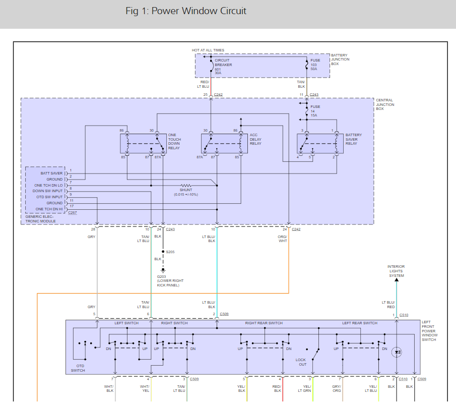

Hello, there are three relays that need to be checked. Here is a guide to help you and a window wiring diagram so you can see which relays to check and I have included the location of the relays as well:
Check out the diagrams (below). Please run some tests and get back to us.
