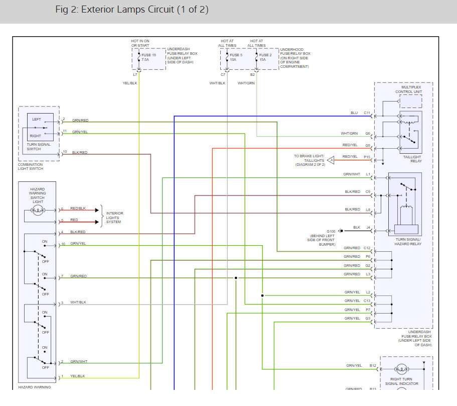

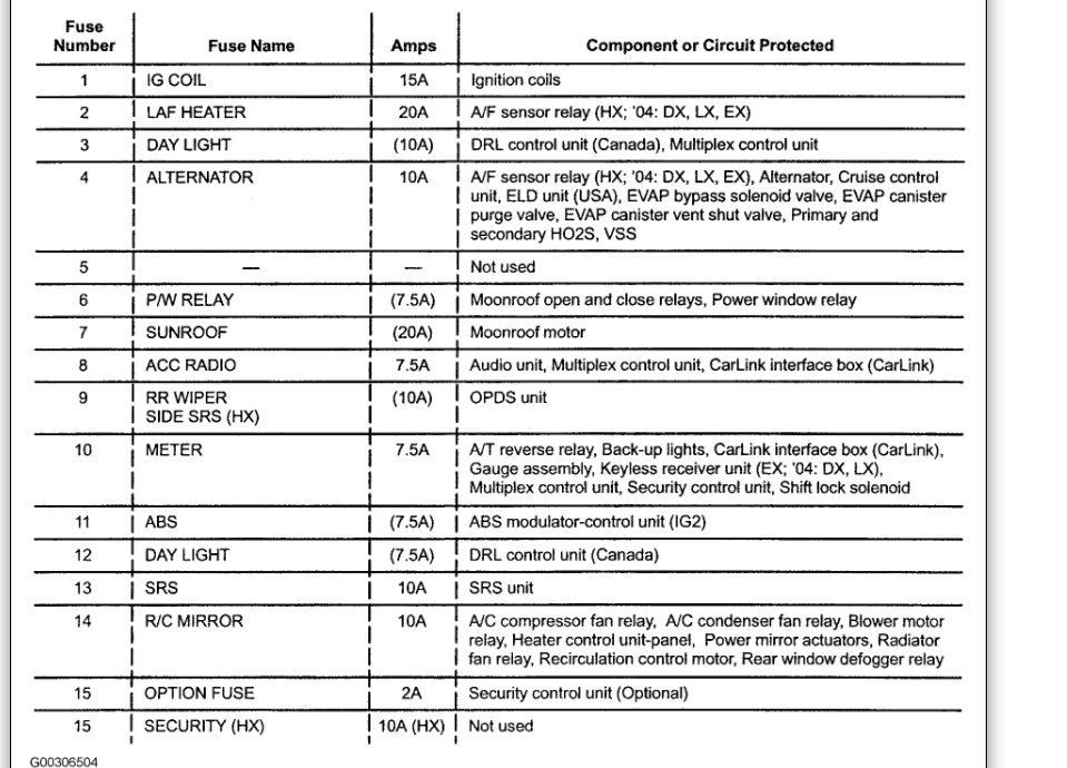

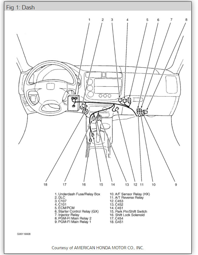

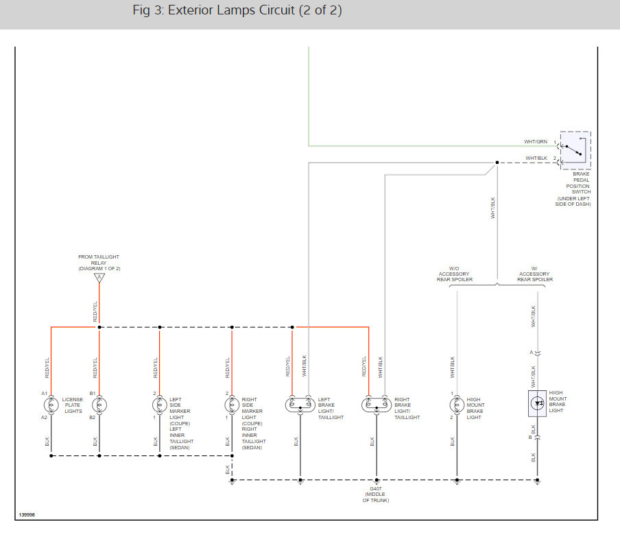

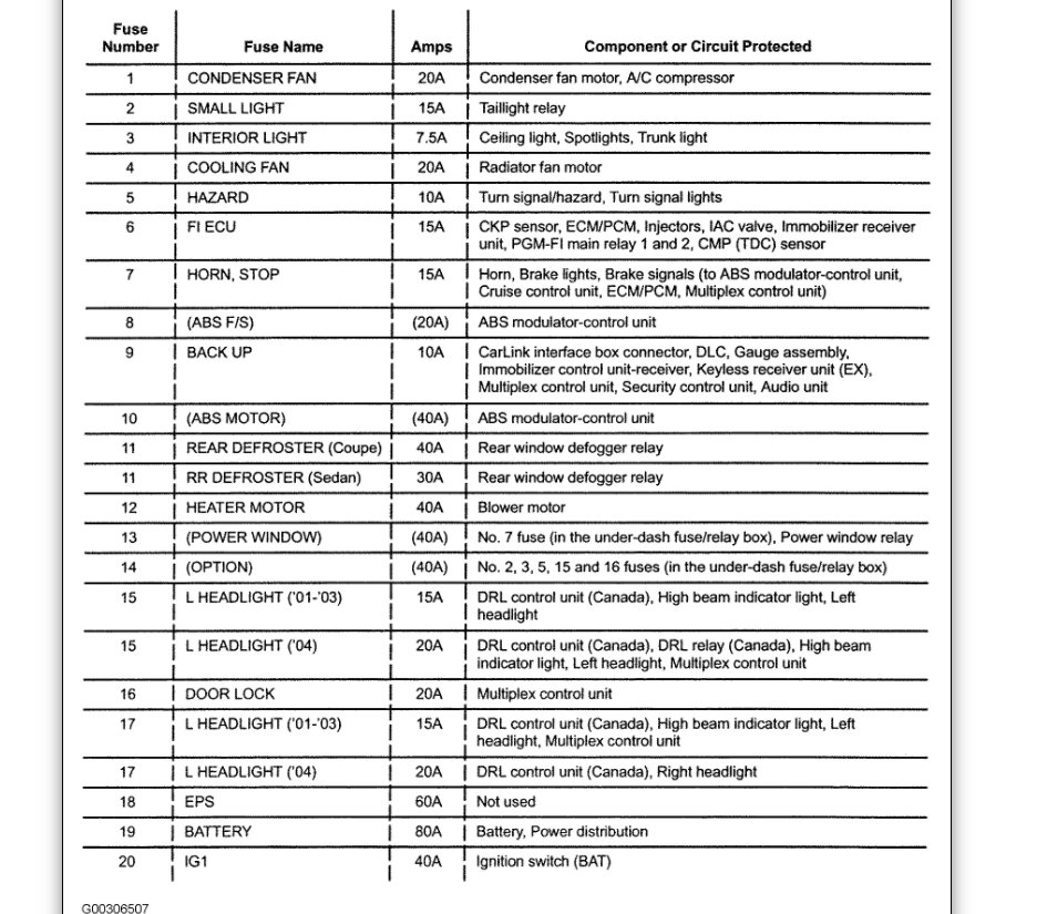

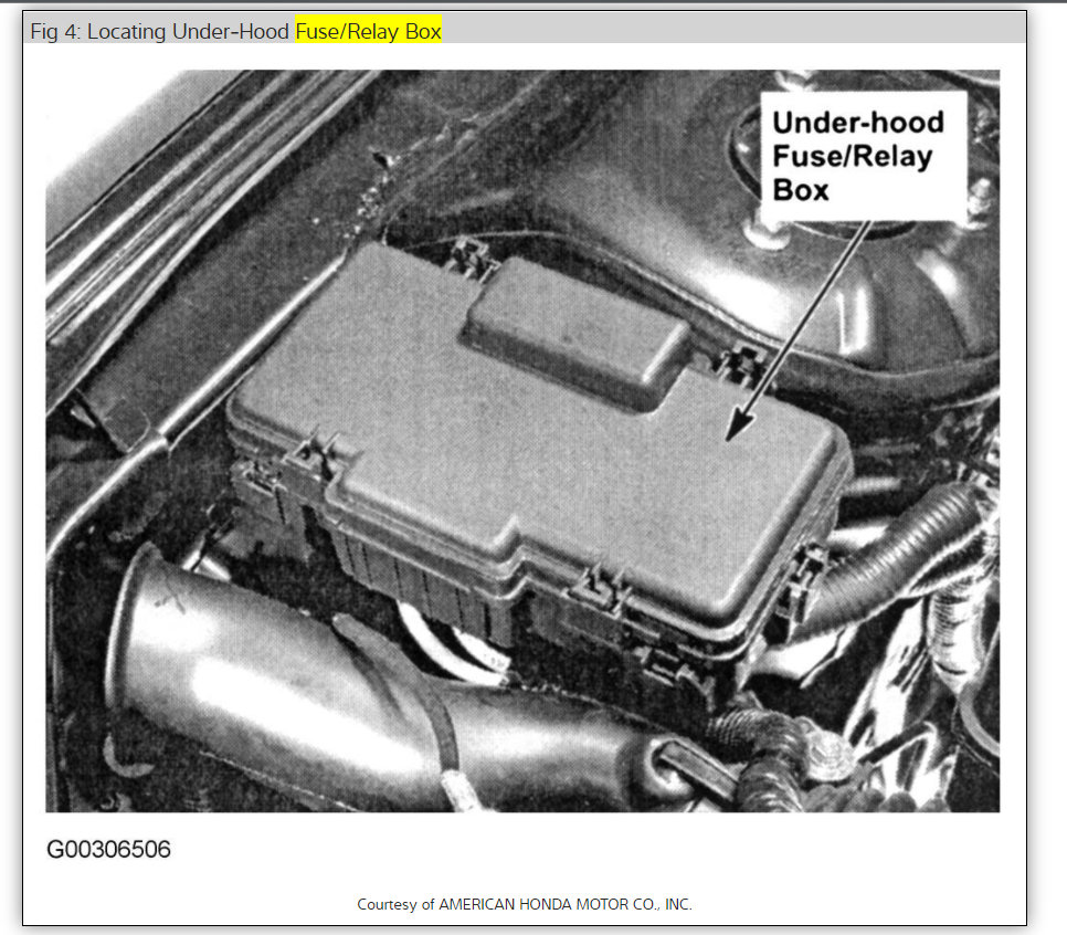

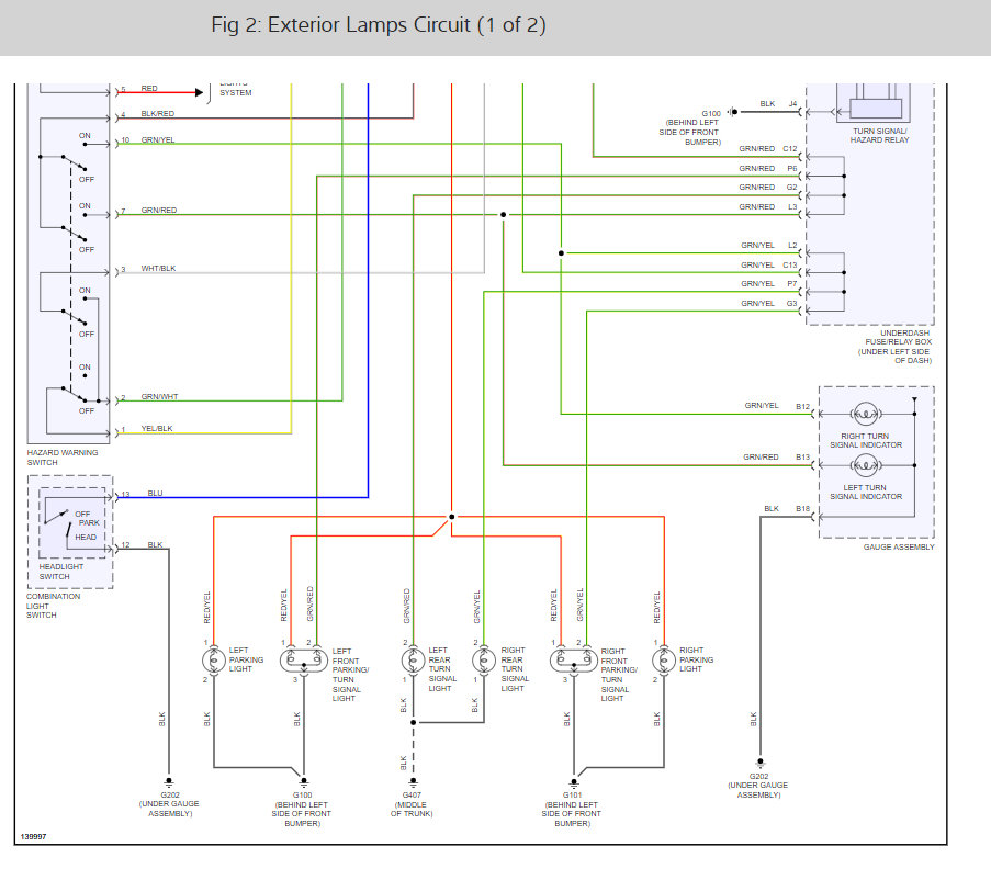

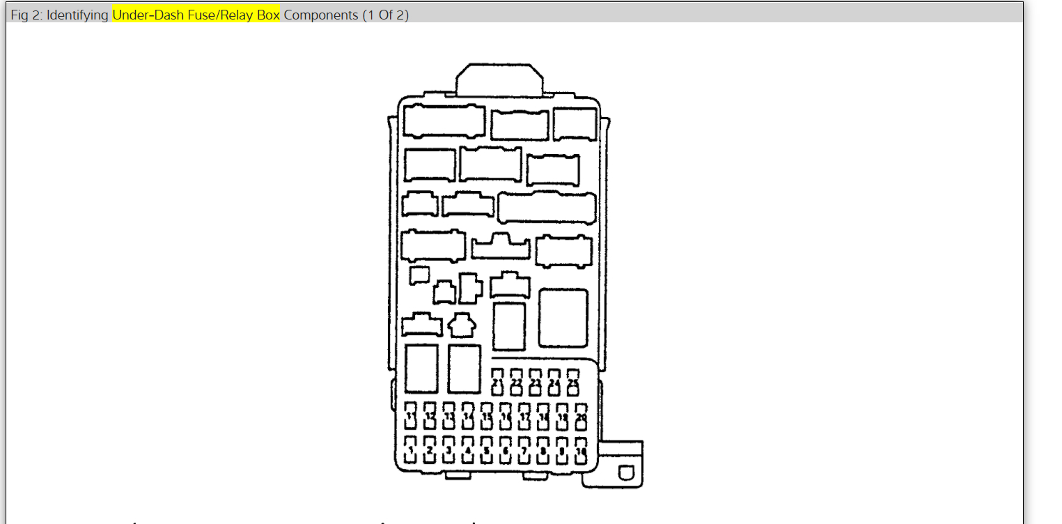

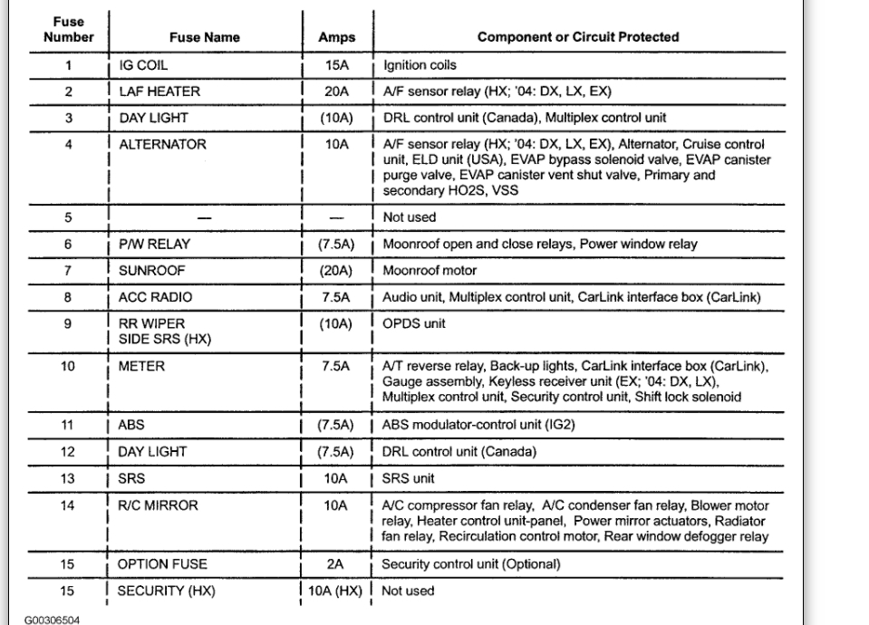

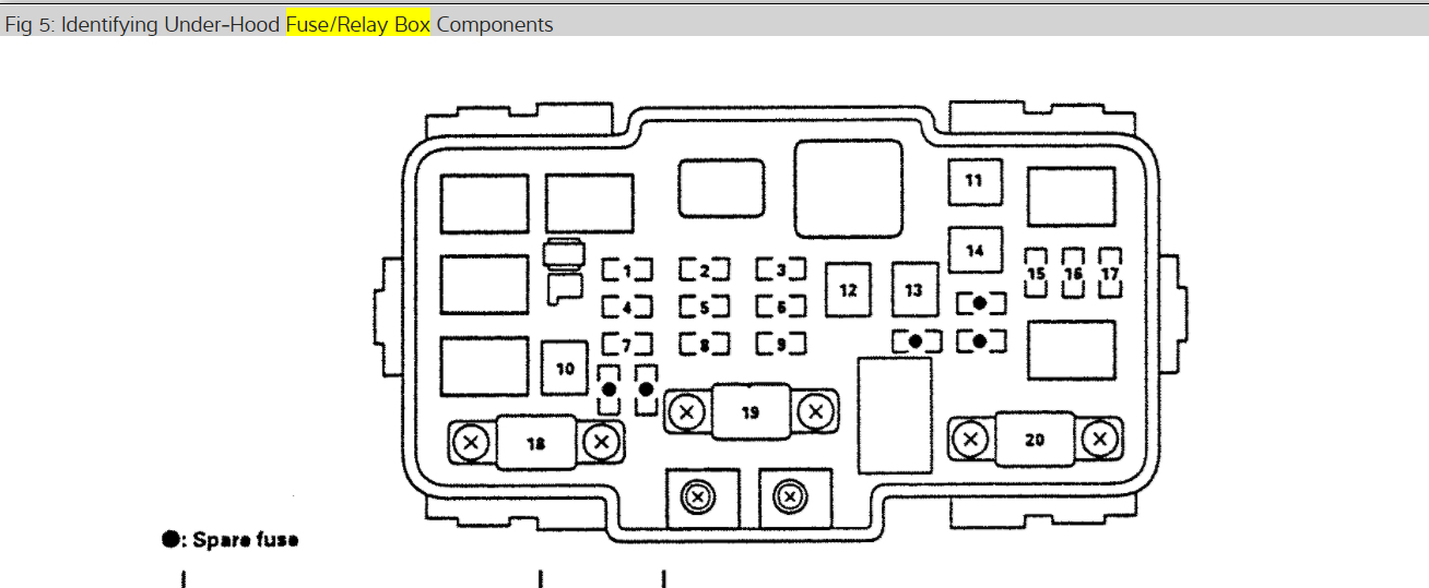

Dash lights and rear running lights went out at the same time, but front running lights are working. Checked the fuses seemed to not be blown. Don’t know to solve the problem.
Dec 18, 2019 at 4:46 AM
  • 55,688 POSTS

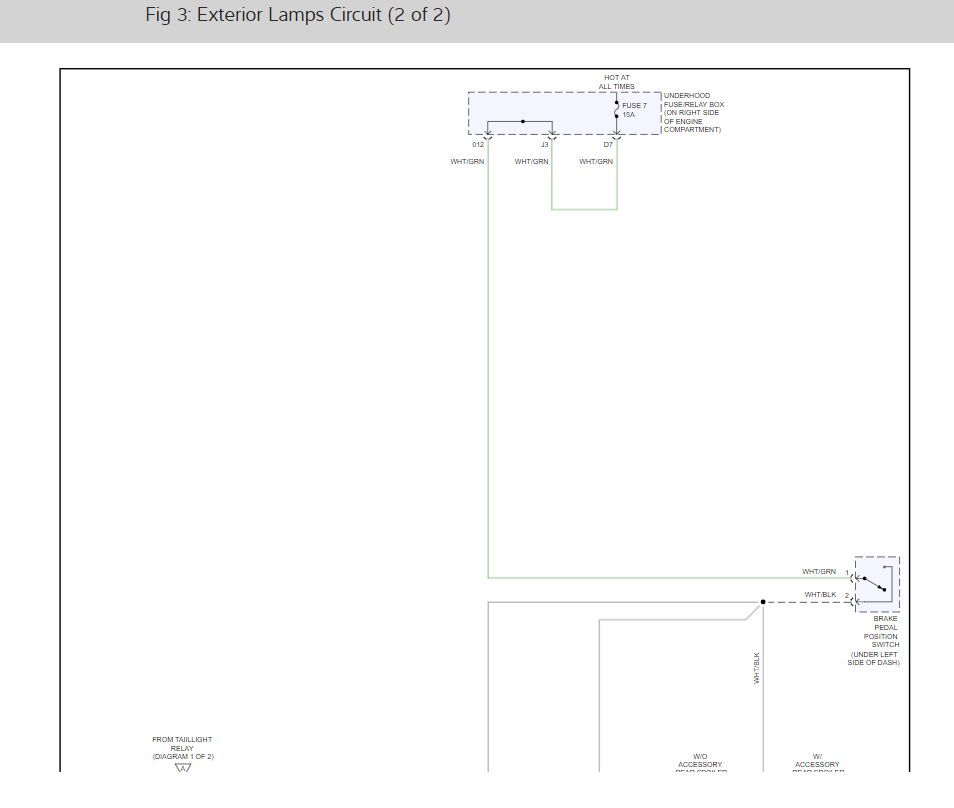

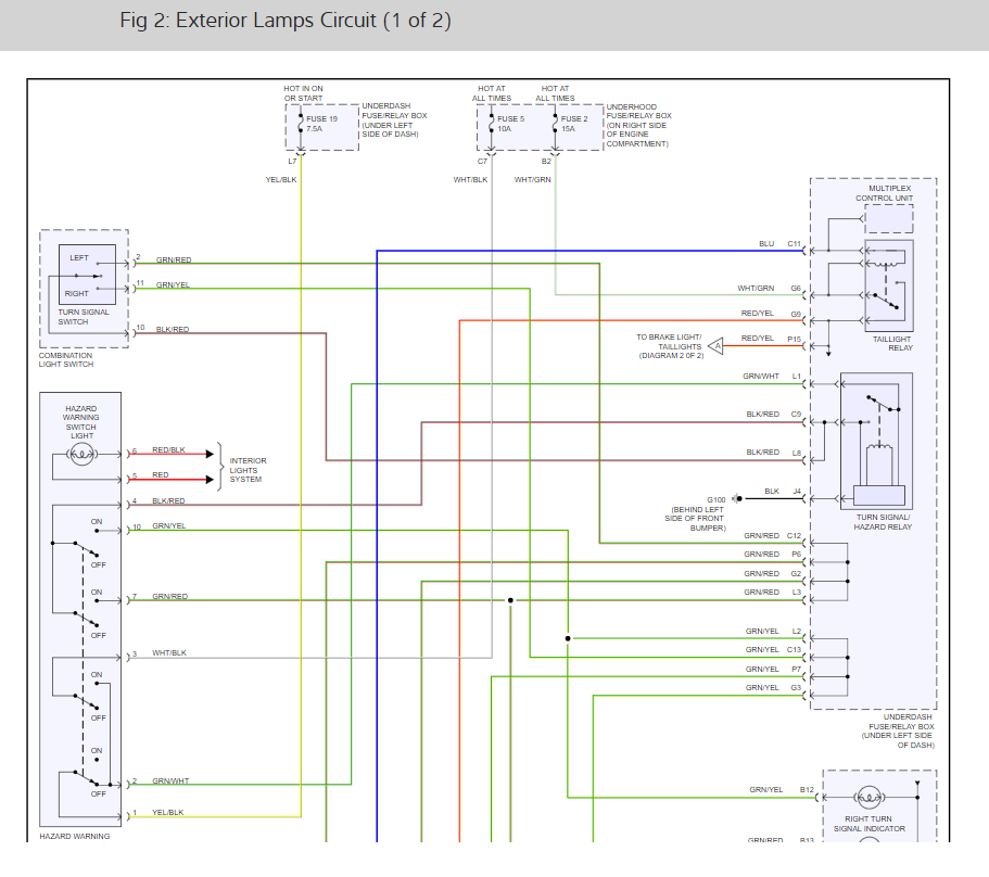

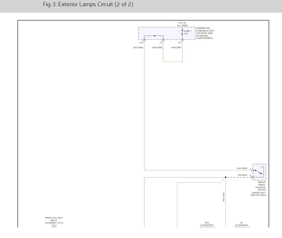

There is a tail light relay that needs to be checked. here is guide to help and the location of the relay:
Here are the blinker wiring diagrams so you can see how the system works and where to check for power.
