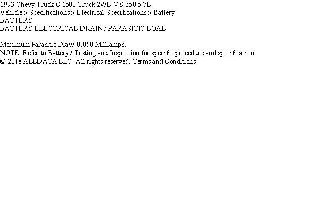

My truck is the 1500 model.
No radio.
No clock.
Alternator disconnected.
No lights on.
Not ran for three weeks.
45mm current draw. (Why?)

What problem are you trying to solve? If you measured a drain of 45 milliamps, that is only slightly more than the industry-standard of 35 ma. At that rate, a good, fully-charged battery will be strong enough to crank an engine fast enough to start after sitting for three weeks.

I stand corrected. Your truck also allows up to 50 milliamps of drain. I tried to copy and paste the page, but the formatting did not copy. The first document is for the spec of 50 milliamps. What follows is the service bulletin copied from an online service manual. I learned the GM does not have a way to stop the ignition-off-draw other than to disconnect the negative battery cable.

Surely. According to that bulletin, your 45 milliamps is higher than what is commonly found, but it is still acceptable, by just a hair. You also mentioned the truck sat for three weeks, which coincidentally is exactly what Chrysler says is the limit for any of their vehicles starting with a fully-charged, good battery. Remember that as batteries age, lead flakes off the plates. That means every day you actually have less battery than the day before. I have a '93 Dodge Dynasty with less than 5,000 miles. Every time I drive it, I have to stick a battery in it, but I have let it sit at times without removing that battery. I did get six weeks out of the original battery when the car was new and sitting on the dealer's lot while I went nuts every night with rustproofing, but now at home, when I stick in an older battery, I only get a week or two before I have to connect a slow charger for an hour to get it started.
