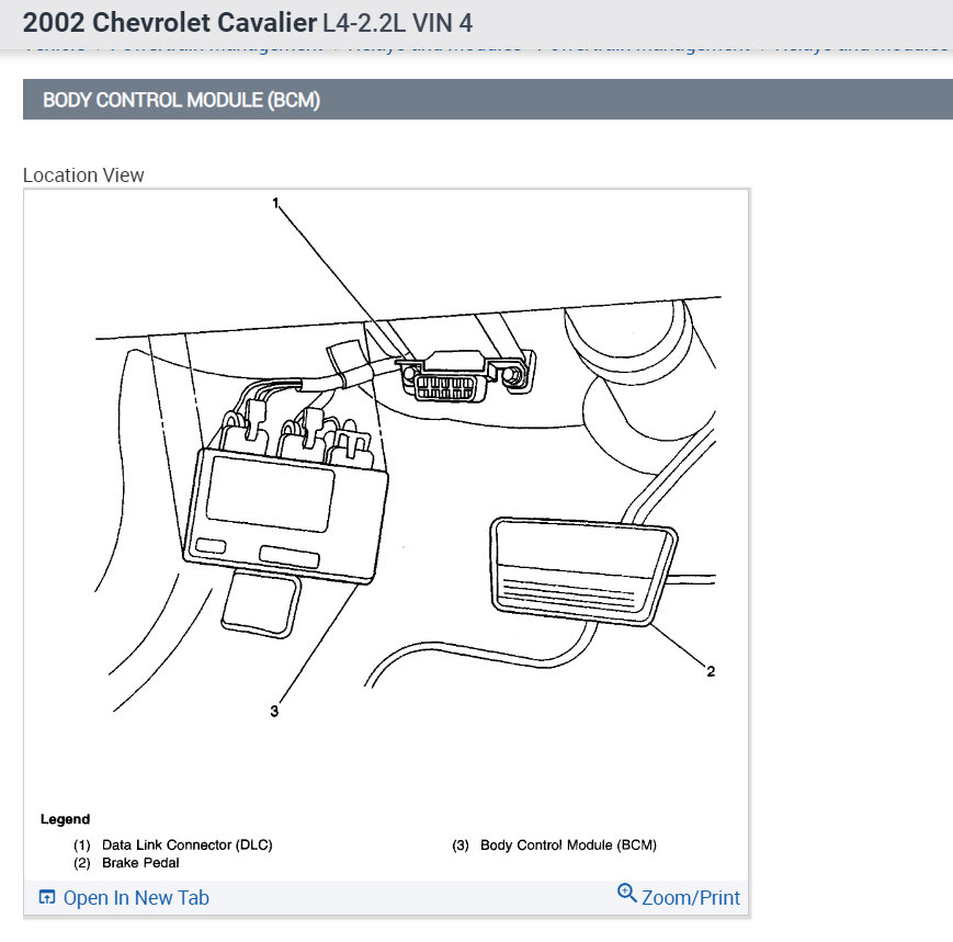

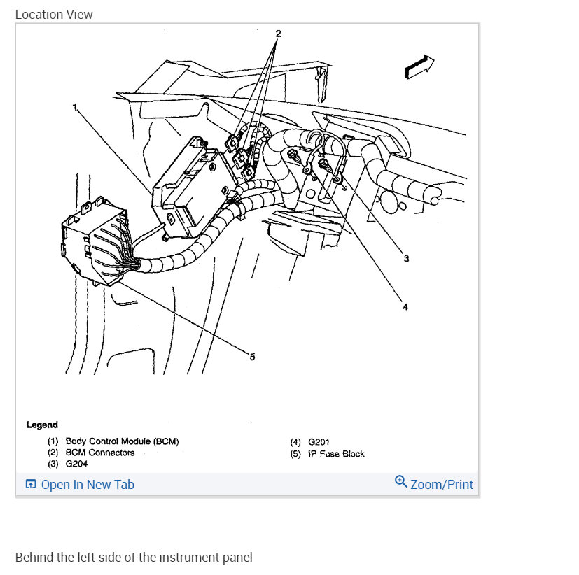

I have no headlights, brake lights or turning signals?
Apr 19, 2023 at 12:10 PM
  • 55,721 POSTS

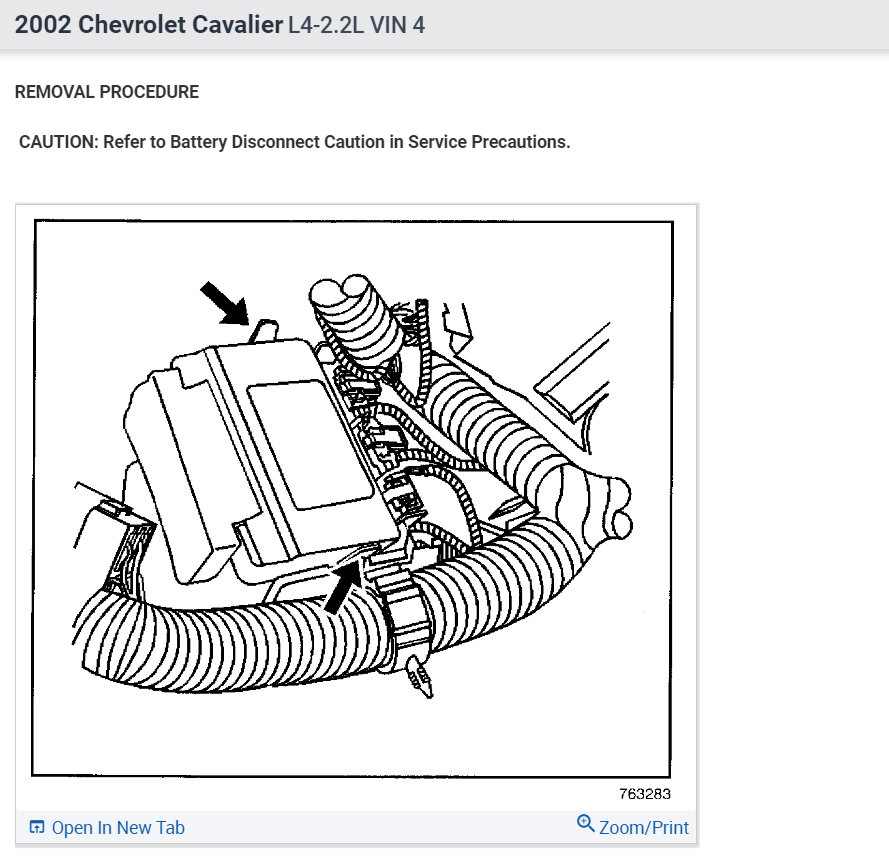

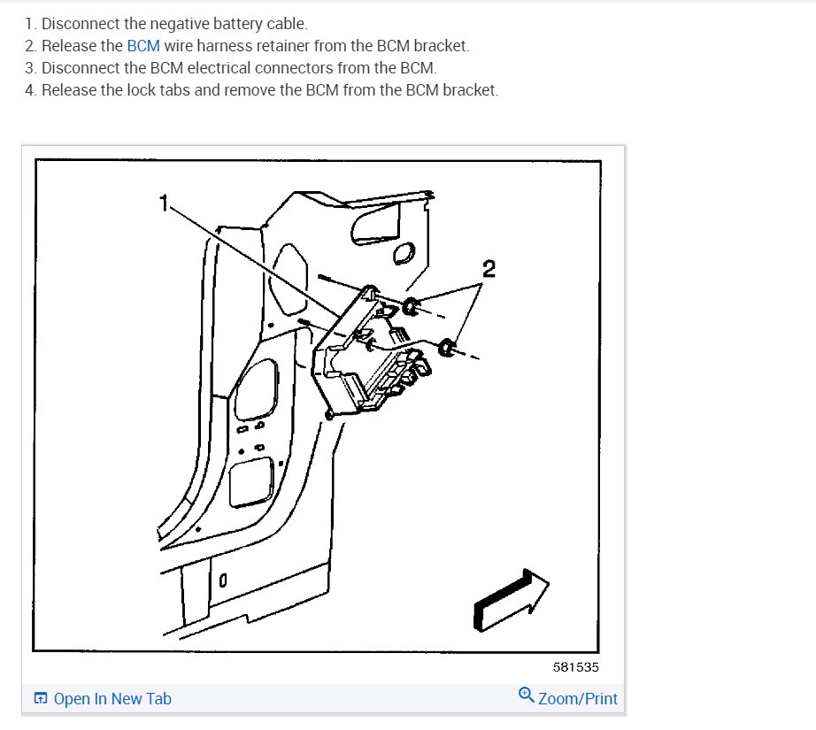

It sounds like the BCM is going out, but we need to do a CAN scan to be sure. You can get a CAN scanner (Controller Area Network) which will work on most cars from Amazon.
https://youtu.be/u-4syLc-ifQ
and

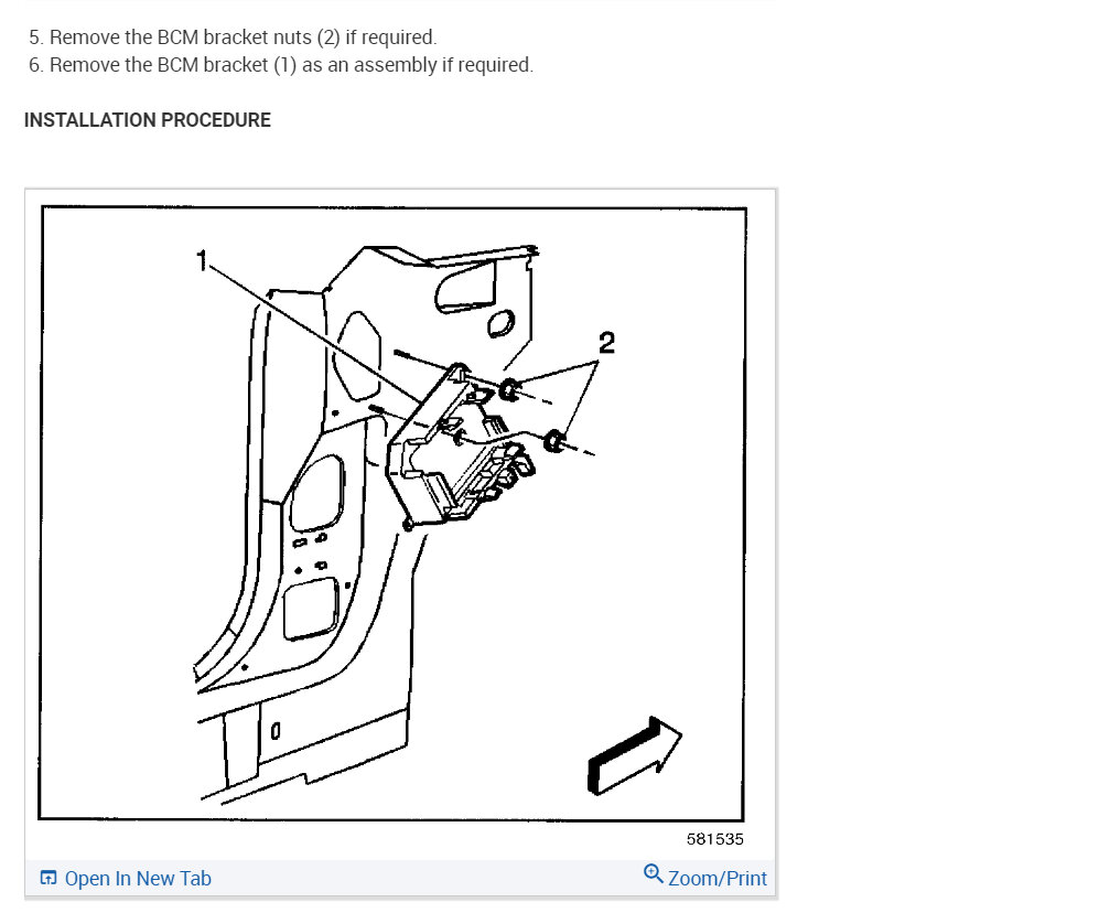

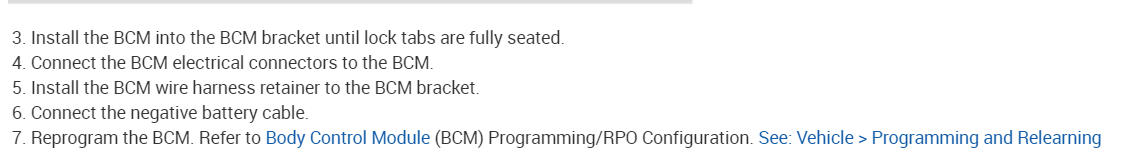

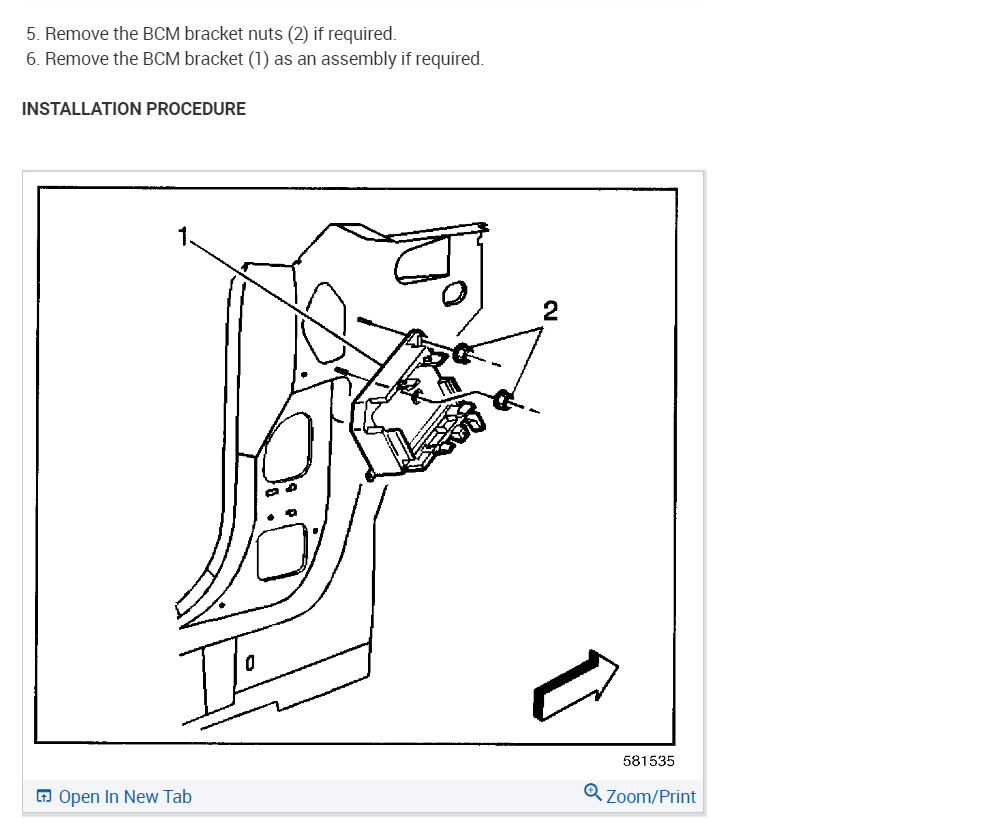

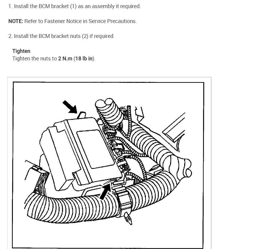

Here is how to change the BCM out is case you need it. You can get a preprogrammed unit by searching Google or Ebay. Check out the images (below). Please let us know what happens.
