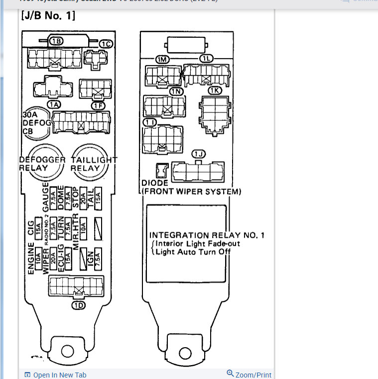

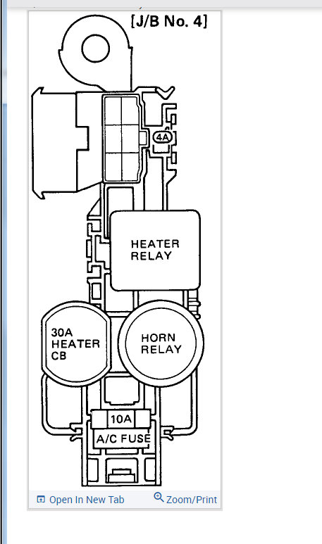

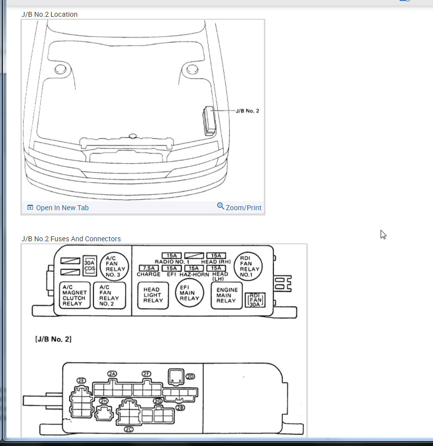

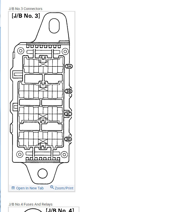

Some wires slipped out of the plug and the part that goes to the back of the relays and I'm needing to find out where those wires go to. if at all possible the pictures should include the colors of the wires. any diagrams pictures or anything of that sort would really really helped me in this problem. I'm having an electrical nightmare on my hands and any electrical pictures or diagrams would be greatly be appreciated. thank you and God bless.
Dec 10, 2019 at 3:10 AM
Please see the info attached. You will see the connector view of the fuse block. This should provide the detail you need to figure this out.
Please let us know if you have other questions. Thanks
