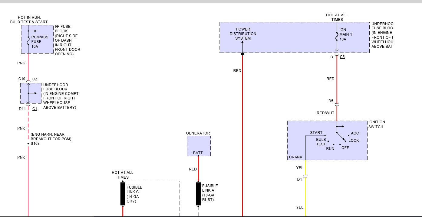

Went to start the van heard a pop. Now all i hear when i try to start is jumping electric snapping. Also, i have no power to anything. But the service lights came on.

You may have blown a fuse. there is a main fuse after battery so check that. Then try a security system reset. See link.
https://www.2carpros.com/articles/how-to-reset-a-security-system

I looked a bit closer ! The battery blew up. Always start wth the battery!!

Yes it happens from time to time, clean the area with baking soda and a garden hose, then follow this guide to get the battery replaced.
https://www.2carpros.com/articles/how-to-replace-a-car-battery
