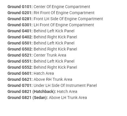

I would like to know we're all the ground locations are?
Mar 21, 2020 at 5:52 PM
Good morning,
There are so many ground connections throughout the car.
What area are you looking specifically?
I attached the grounds and locations for you below.

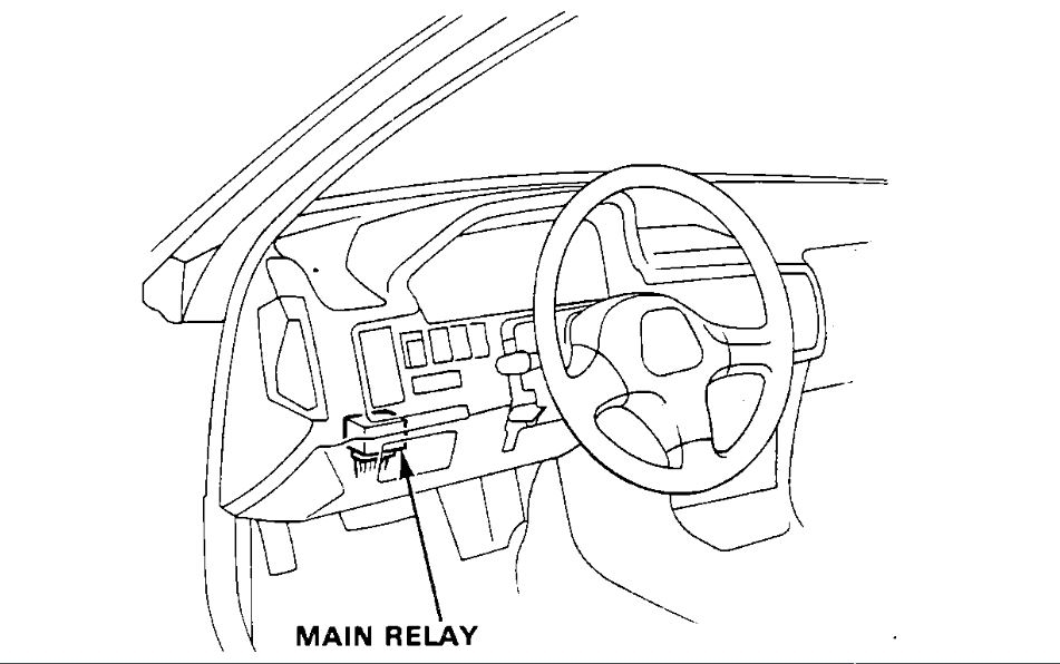

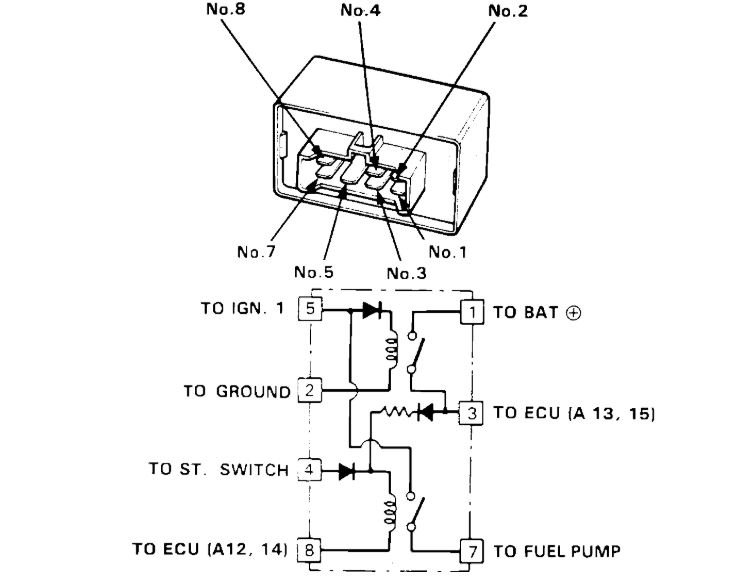

Thank you. pictures would helped also!! I'm just concerned because of a engine swap and I have had issues!! Currently I'm not getting fuel pump to cut on when ignition switch is turned to start. I think it's the main relay but worried bout ground locations because I've already had the mph cluster heat an melted the mph needle until it fell off!!
Mar 21, 2020 at 10:34 PM
Let me check the locations for the engine related ground. Sorry, they do not show the location of the grounds with a picture due to the age of the car.
Also, the main relay is the main cause for the fuel pump not working.
