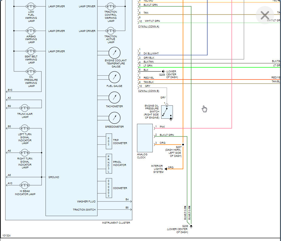

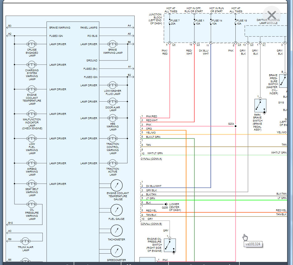

Here is the wiring diagram if you would like to check voltage coming from the sensors. I suspect you will find constant/steady voltage from the coolant temperature sensor when the gauge is ranging. If that is the case then that means the cluster is the issue.

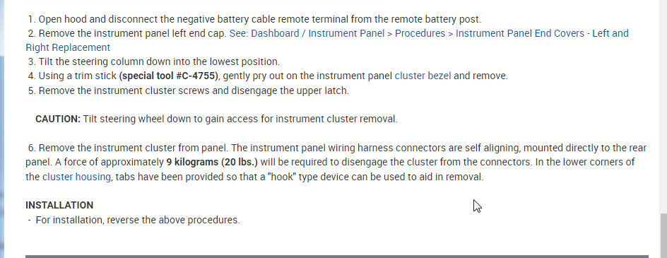

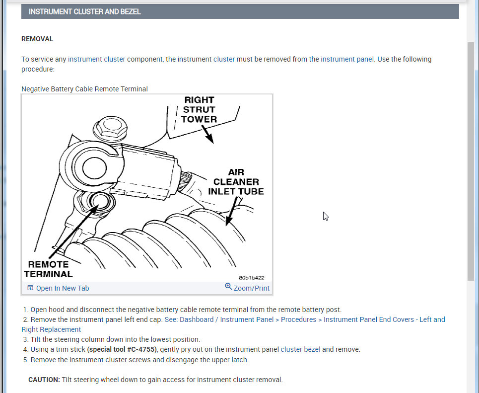

Let me know if you have questions on this. Please find the info below.
