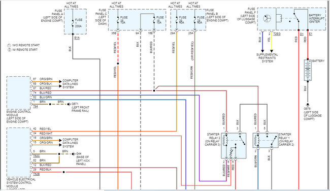

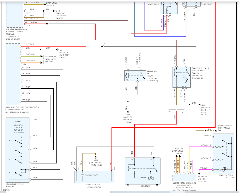

Where is the starter relay and the fuse that controls the relay located?
2017 VOLKSWAGEN PASSAT
87,000 MILES
MALLESO
Need exact location of starter relay and the fuse that controls the relay no diagrams on the car.
Jul 21, 2022 at 11:00 PM
  • 110,241 POSTS

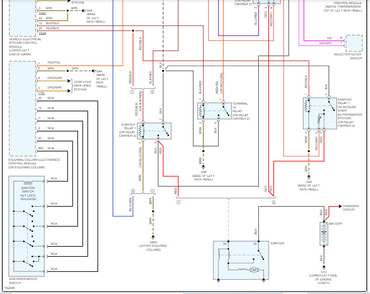

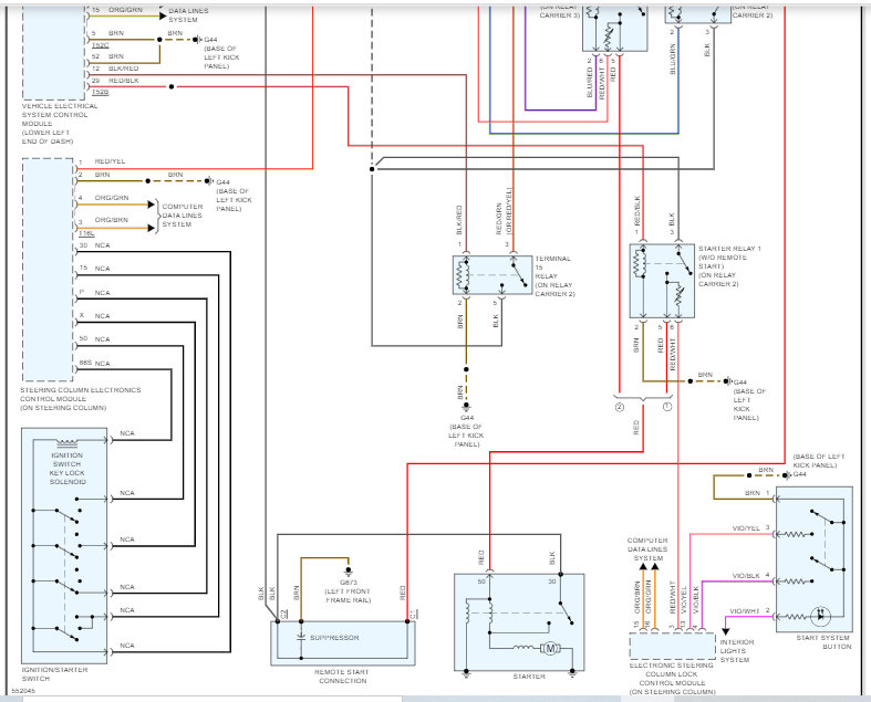

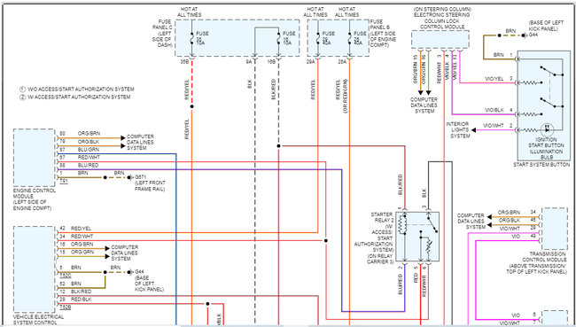

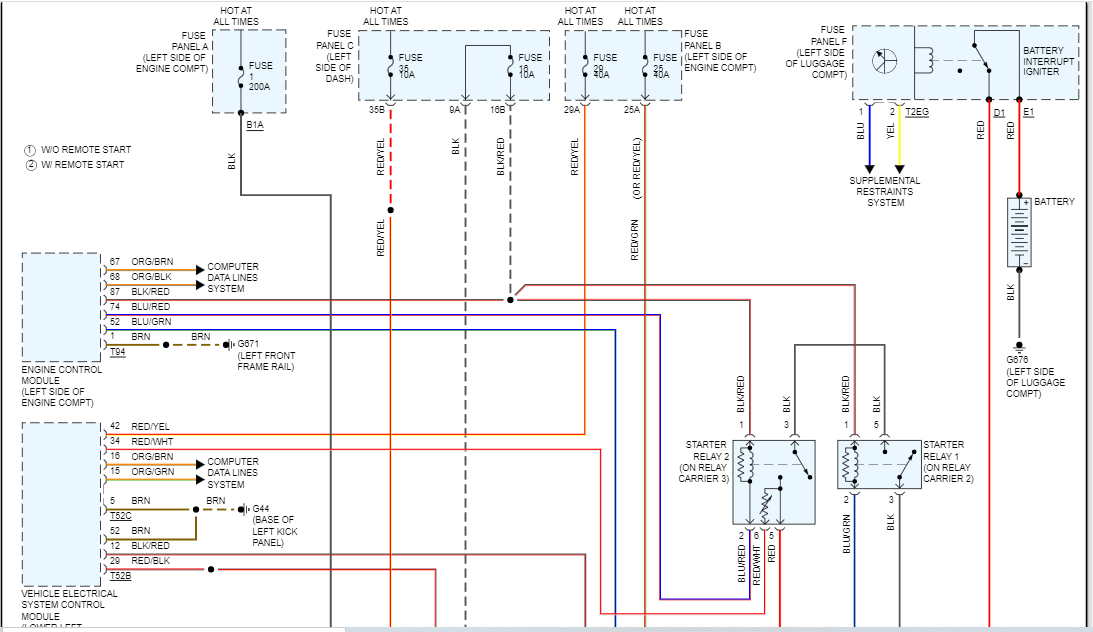

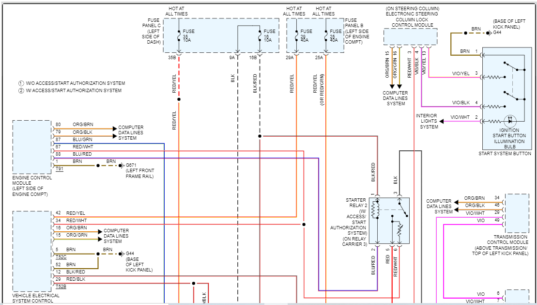

I'm not sure if you have the 4 or 6 cylinders. I attached the starter circuit schematic below for both. The first two pics are for the 4 cylinder and the second is the v6.
If you look through the schematic, it indicates the location s of fuses and relays.
