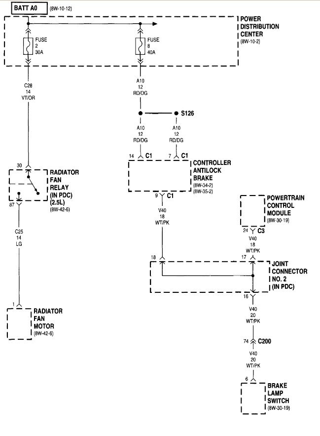

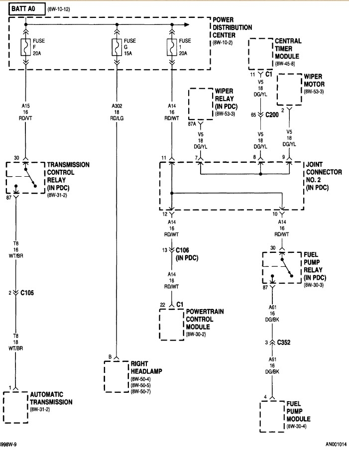

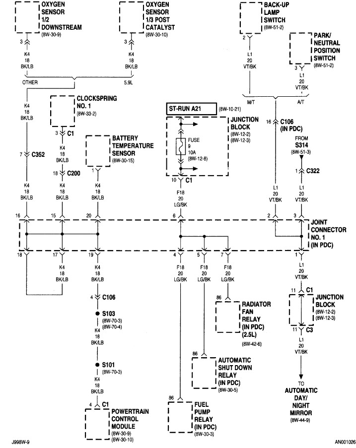

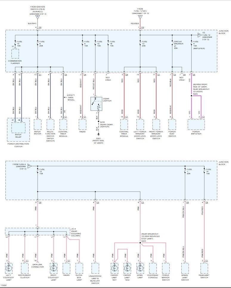

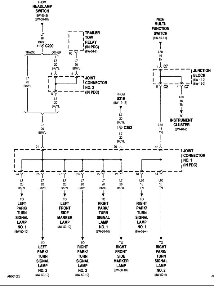

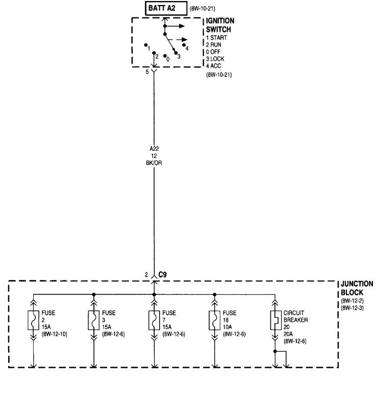

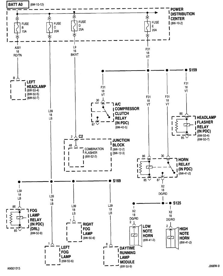

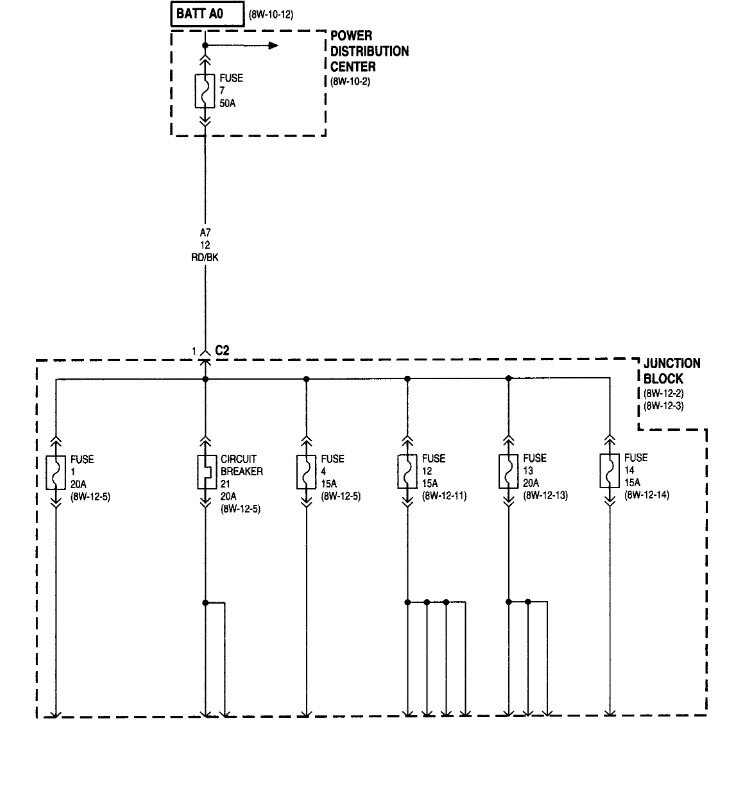

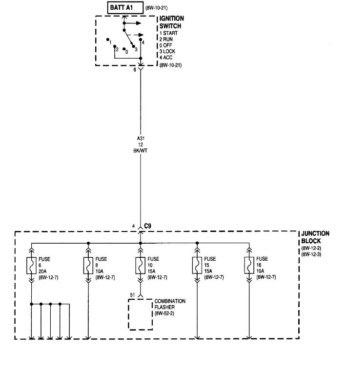

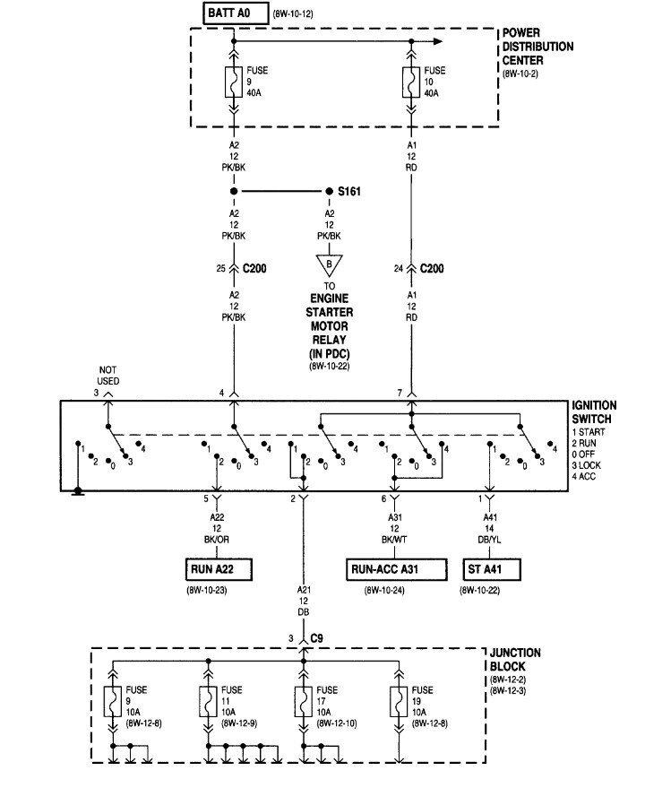

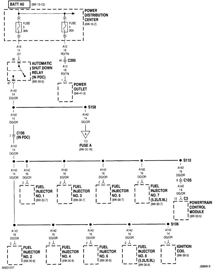

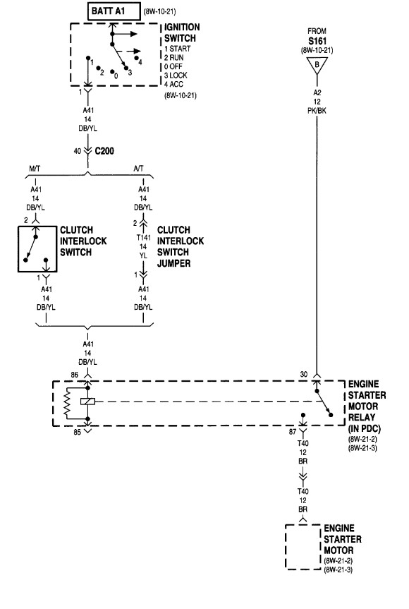

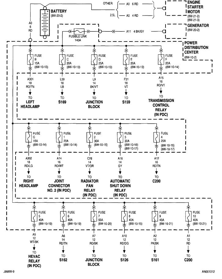

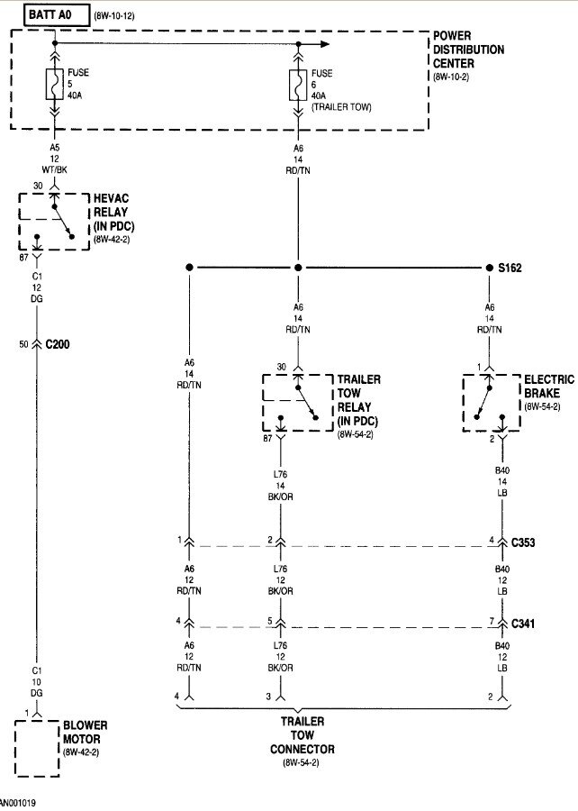

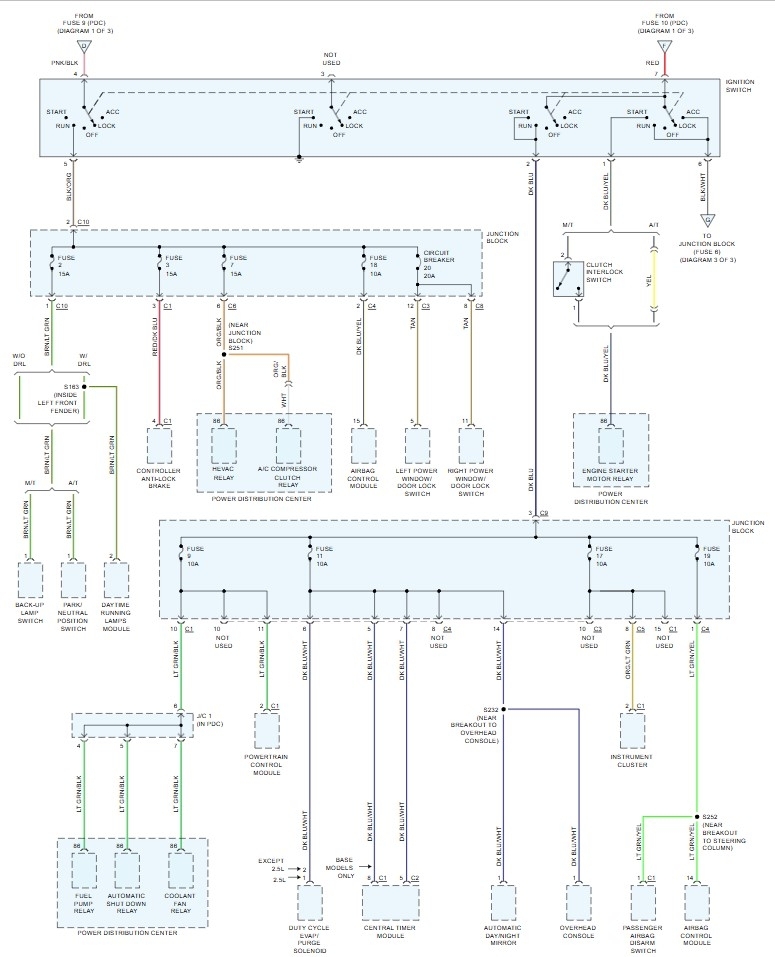

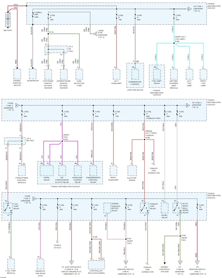

These are the diagrams for that unit and some of the other power distribution items it's connected to.

Printed out unable to read need wire diagram for engine fuse box of each relay and color wire.

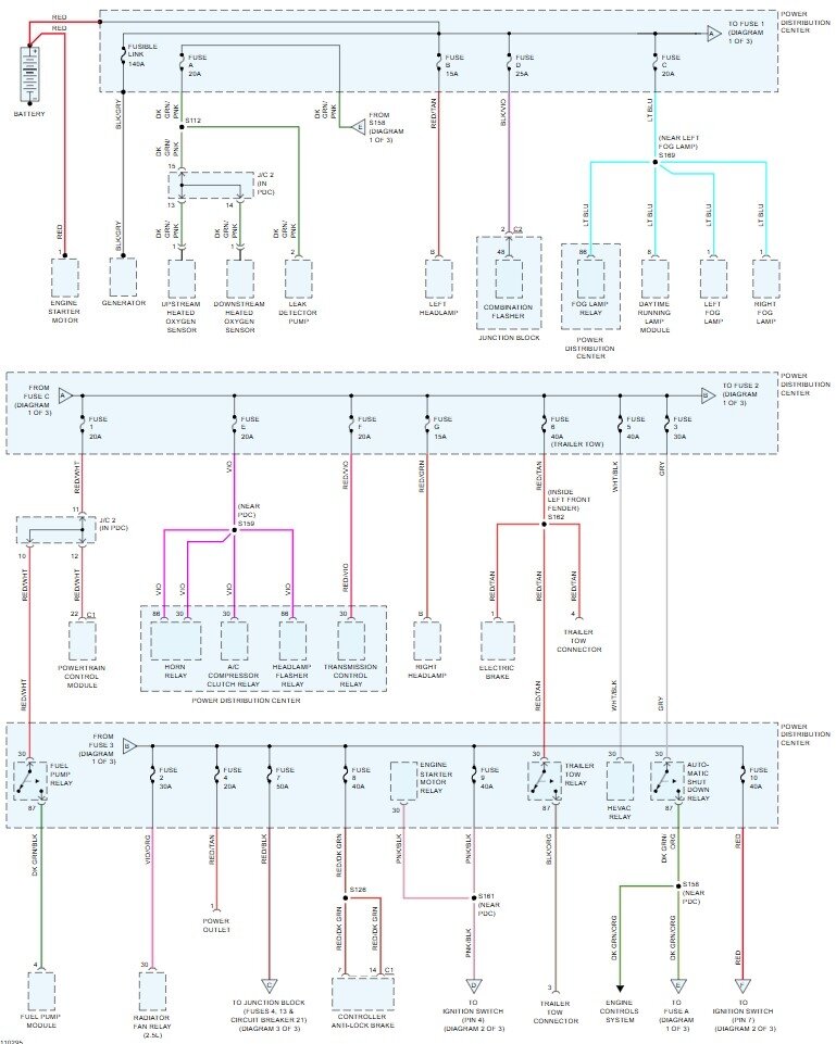

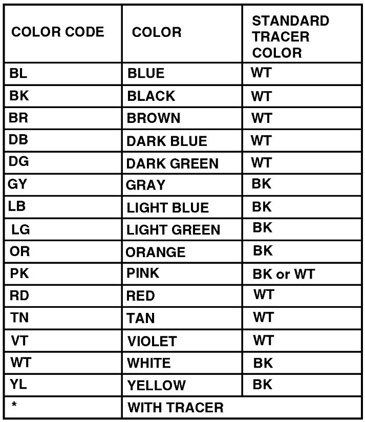

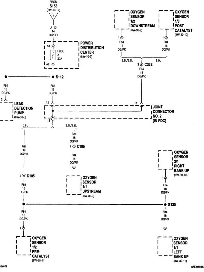

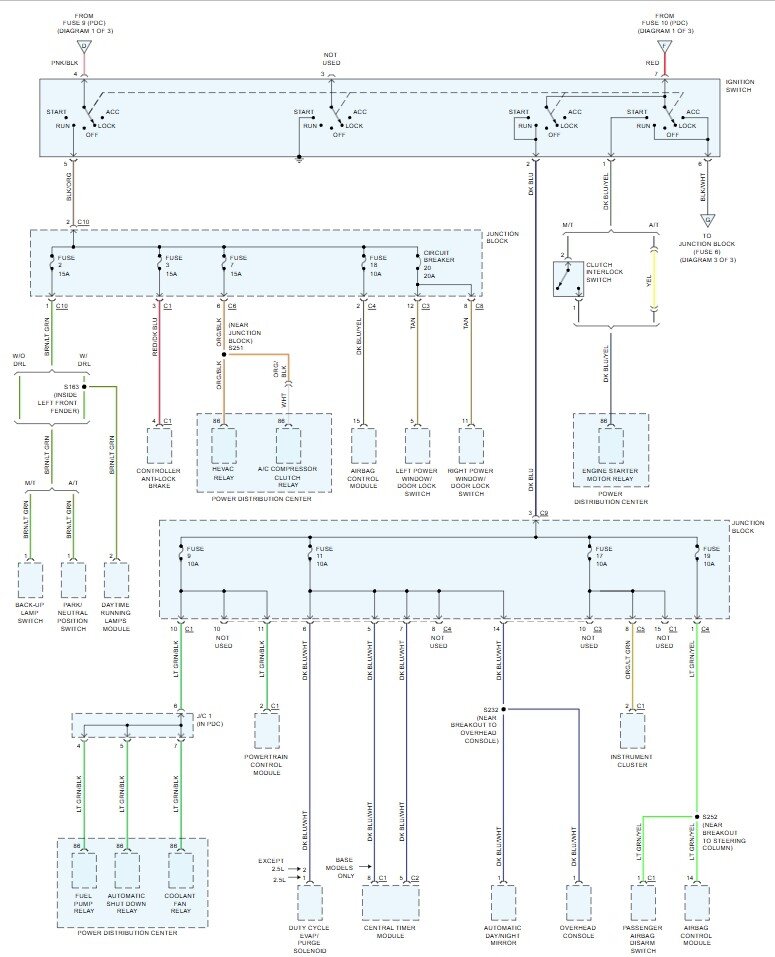

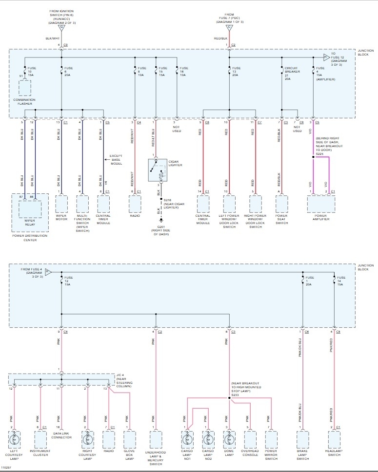

Try these, they may print better. These are all the fuses and what they power. The color code for the wires is also attached.

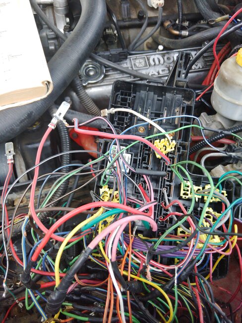

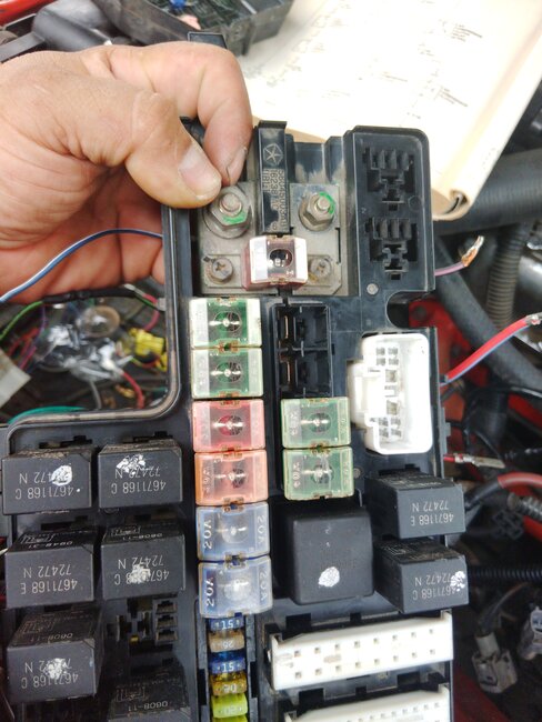

Need wiring diagram for the fuse box in the engine compartment would like to find is a diagram with color coded connection to and from for each relay and fuses its a 1999 Dodge Dakota 5.2 v8 4x4 fuse box diagram
Trying to help a friend that his was dry rotted and not sure why but he decided to just cutt the fuse box out again I don't know why lol.

Did the wiring diagrams above help or?
