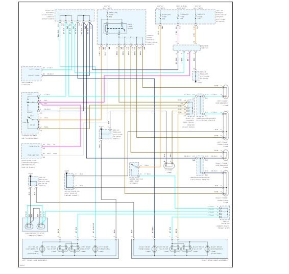

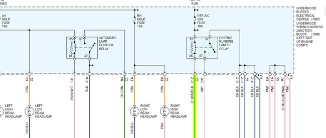

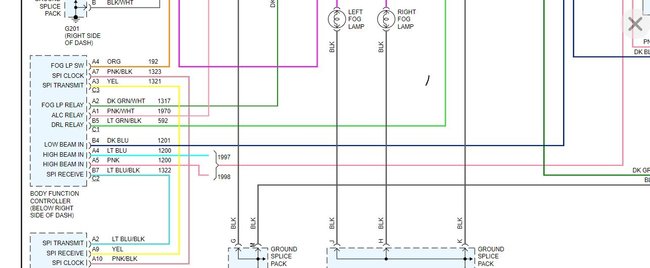

I attached some diagrams for you to view. Make sure the DRL relay is functioning.
