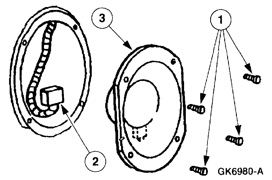

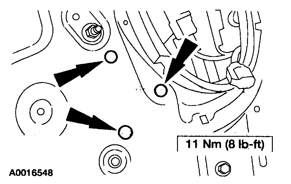

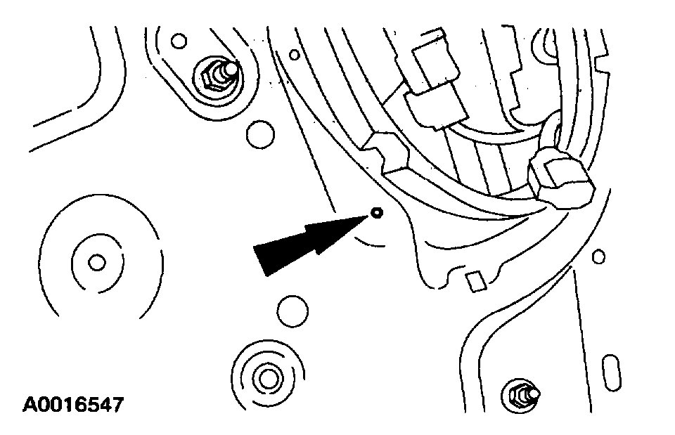

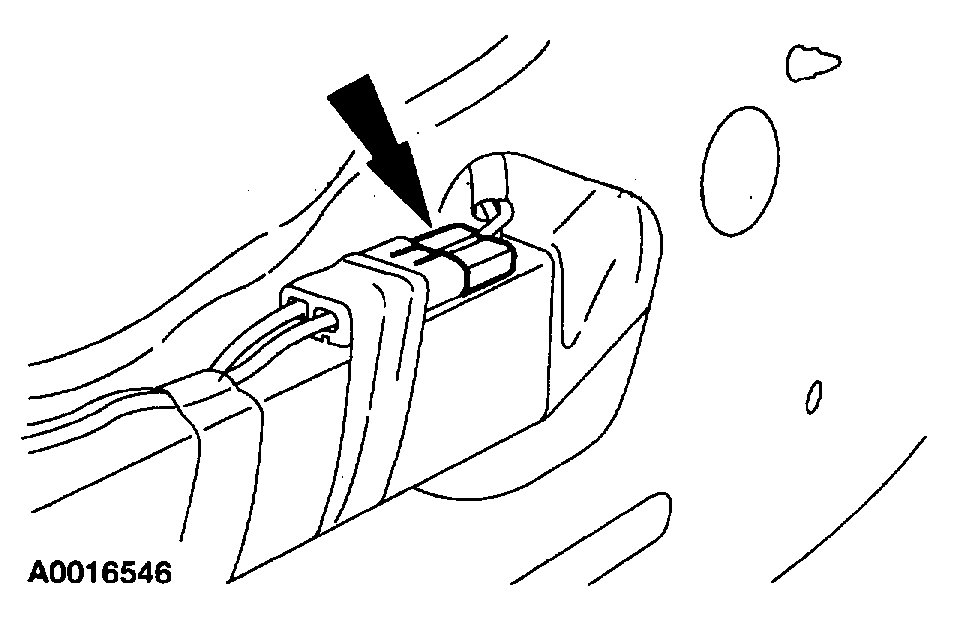

If you determine the motor is bad, here are the directions for removal and replacement. The attached pics correlate with the directions.
___________________

1. Remove the front door trim panel.
pic 1
2. Remove the front door speaker.
1 Remove the screws.
2 Disconnect the electrical connector.
3 Remove the speaker.
3. Remove the water shield.
pic 2
4. Disconnect the front door window regulator motor electrical connector.
pic 3
5. Drill a 13 mm (0.52 in) hole using the locator in the door sheet metal as a guide.
pic 4
6. Remove the bolts and the front door window regulator motor.
