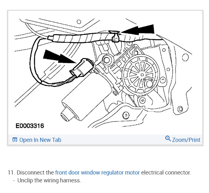

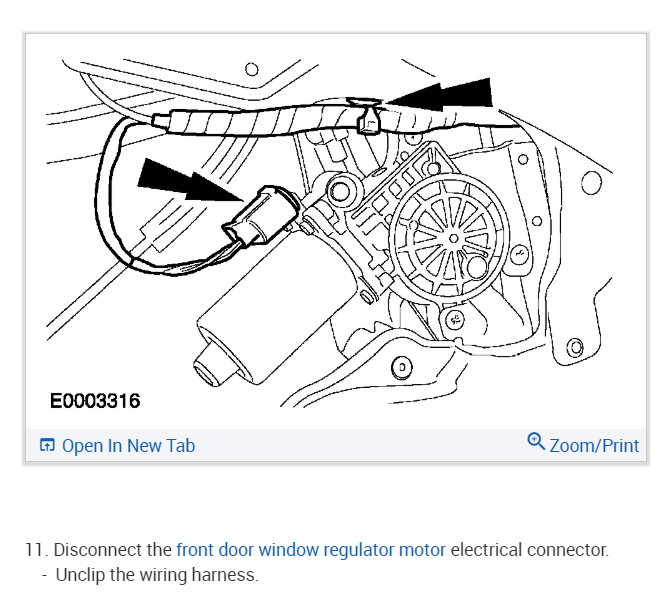

The electric window on the drivers side doesn’t work, the switch works for the Passenger window on the drivers side. I’ve noticed when pressing the button whilst putting the passenger window up or down slows slightly.
Sep 4, 2019 at 7:26 AM
  • 55,433 POSTS

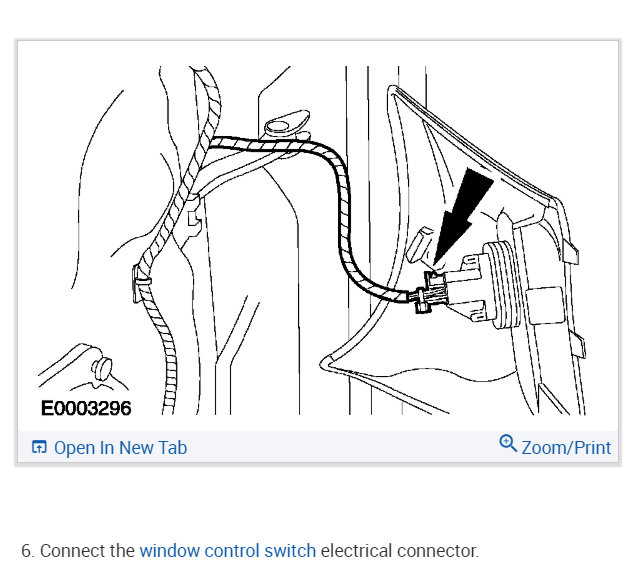

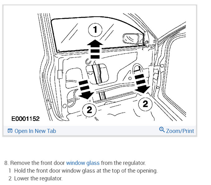

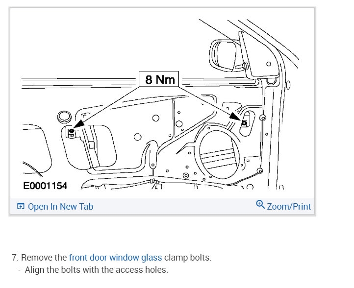

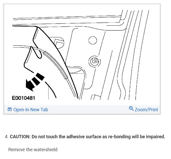

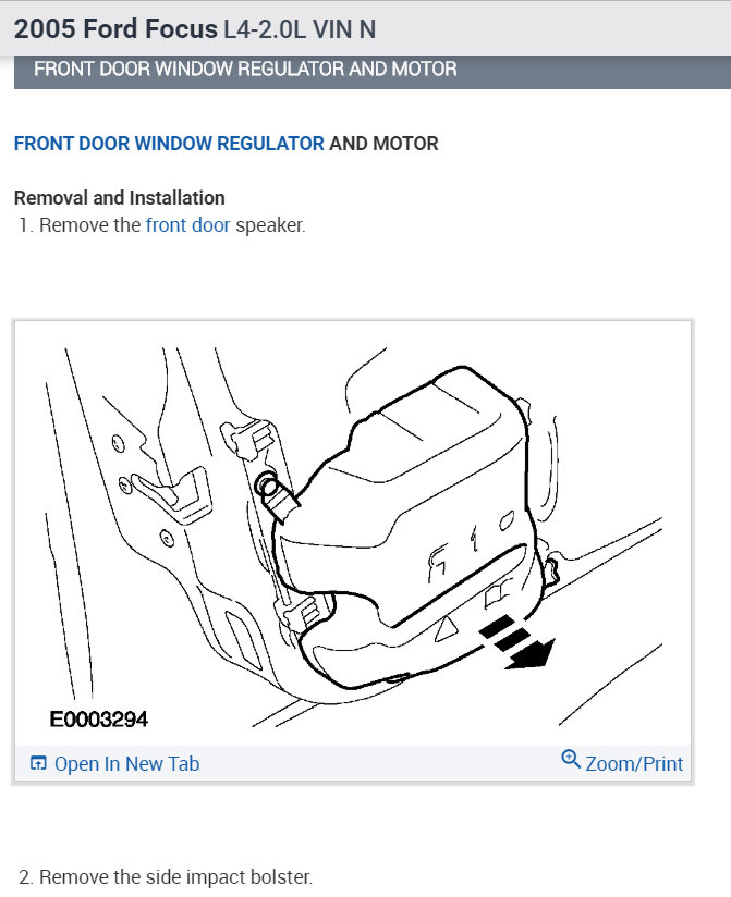

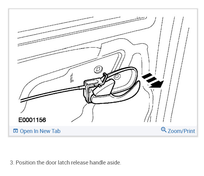

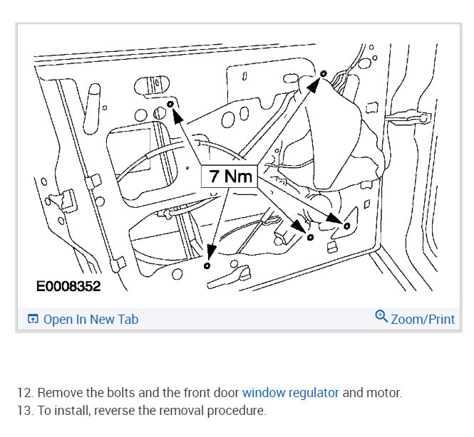

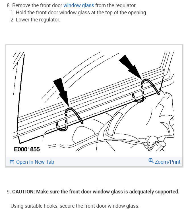

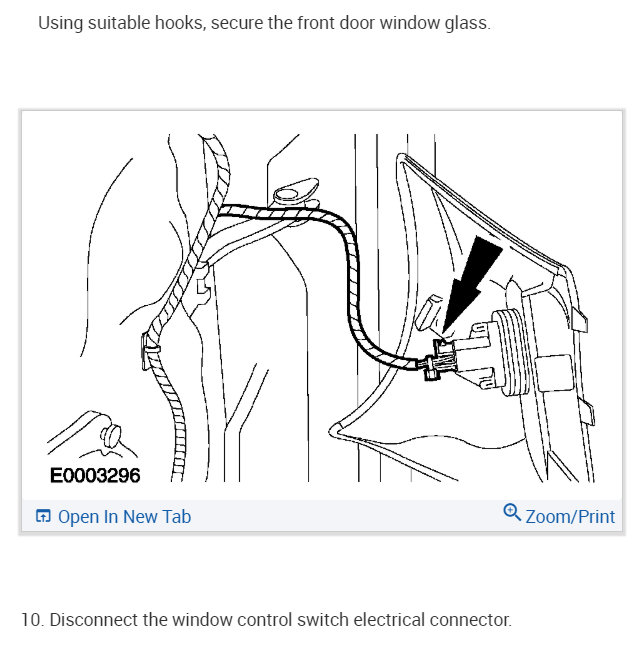

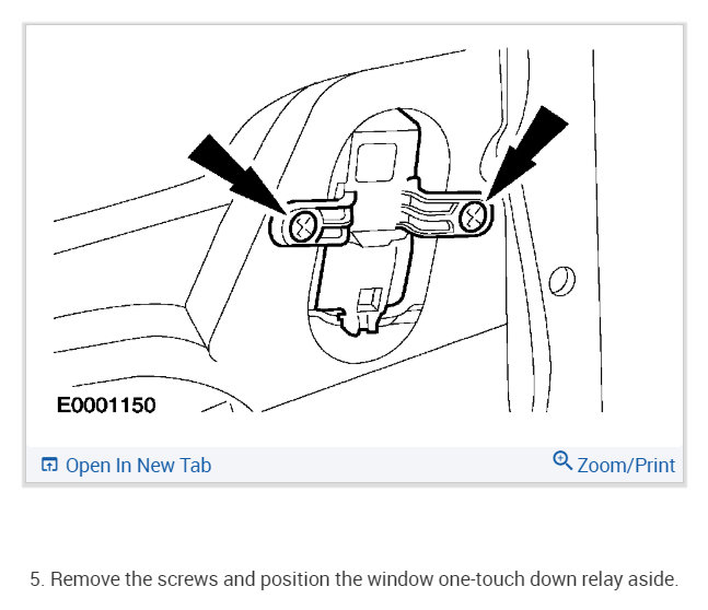

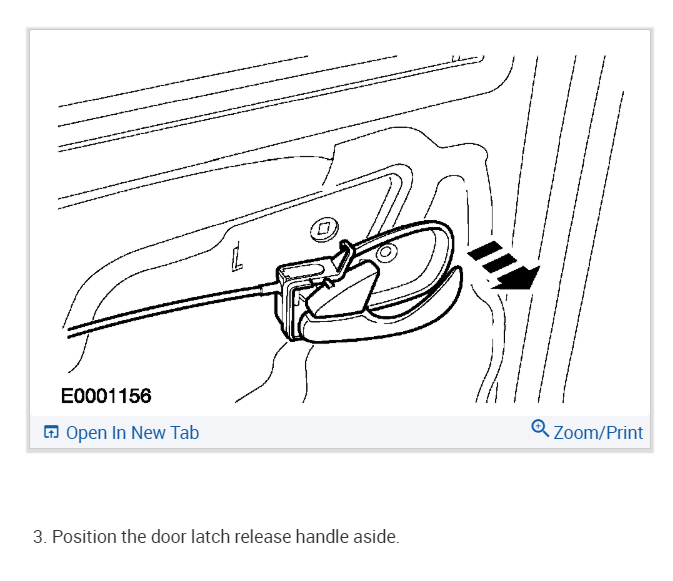

This is common when the drivers side window motor goes out. here is a guide to help walk you through the repair with diagrams below to show you how on your car:
https://www.2carpros.com/articles/how-to-check-and-replace-a-electric-power-window-motor
