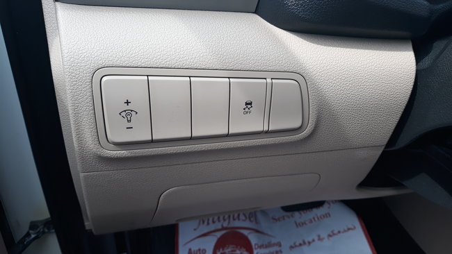

i don't have electric tailgate on my vehicle. i am planning to add one aftermarket.
https://ko.aliexpress.com/item/32906720211.html
They have tutorial video as well.
my only concern is in my original switch i don't have the button for opening tailgate.
if i buy the full switch assembly online will the aftermarket tailgate work with the same original wiring harness or not. i don't want to add the aftermarket switch inside the car as it requires another drilling.
has anyone tried this?
https://ko.aliexpress.com/item/33023469814.html?spm=a2g12.12010612.8148356.7.1ede7ea2yW7Lga
Feb 17, 2020 at 6:48 PM
Good morning,
The aftermarket tailgate will not work with the factory system at all. It will be a separate system totally independent from the factory harness and controlled by the wiring provided.
A switch will be required to make it work for your van.
