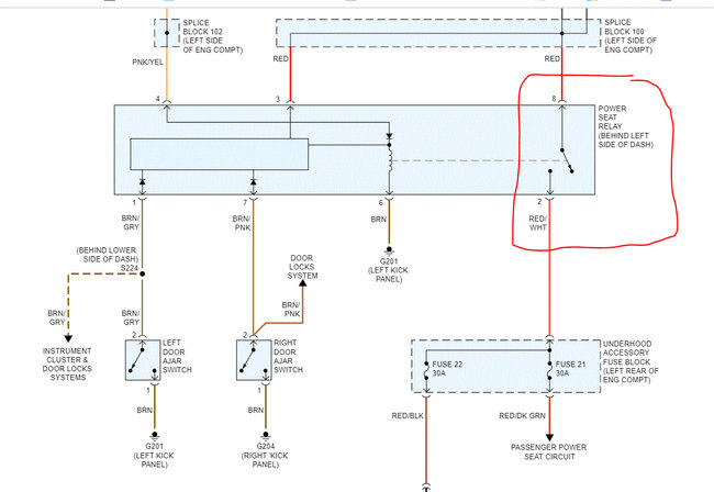

I just got done installing the ashtray in my vehicle .not an easy job. upon completion, I noticed my electric seats are no longer working, neither of them! I do not believe I came into contact with any connections, etc., (which I may have broken) during the ashtray repair, so I am stunned at the timing of this failure. The car seats worked fine just this morning and all I did was install the ashtray into the console (as the old ashtray had been removed and the dash disassembled a week ago. At a loss here. thanks!
After waiting a half hour or so they began working again. I believe now that I have an intermittent relay involved. Any clue where the relay is located?? Thanks again!
Jul 18, 2020 at 6:59 AM
  • 110,251 POSTS
I found the relay by looking at a wiring schematic. It indicates it to be behind the left side of the dash. However, I tried finding a pic of the relay and have had no luck. Is there a relay box under the dash?
Here is a link that explains how to test a relay. Not sure if you need it, but I thought I would add it. Note that the relay in the attached pic powers both the left and right seats.
