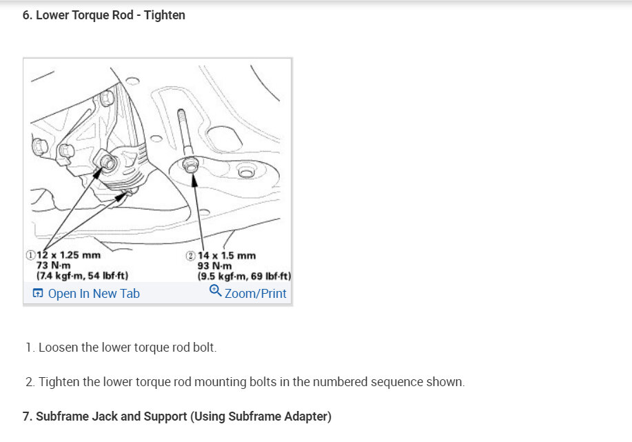

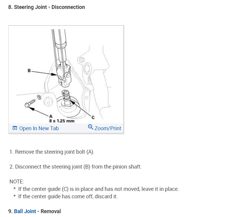

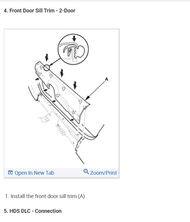

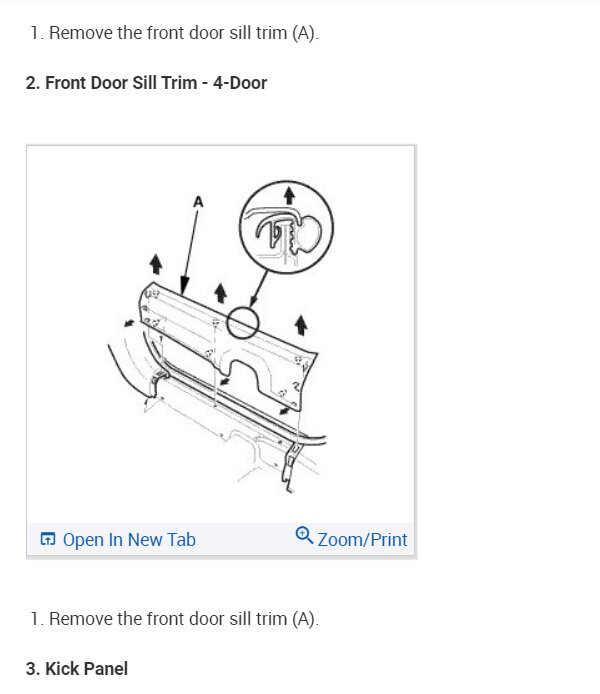

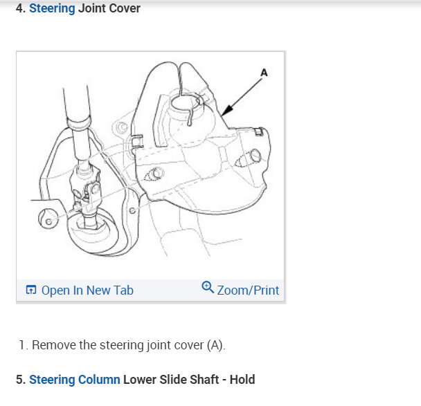

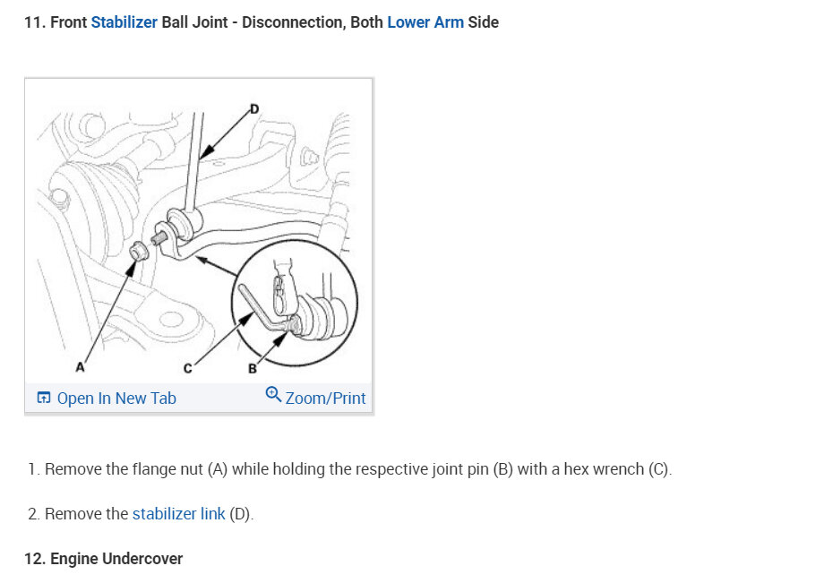

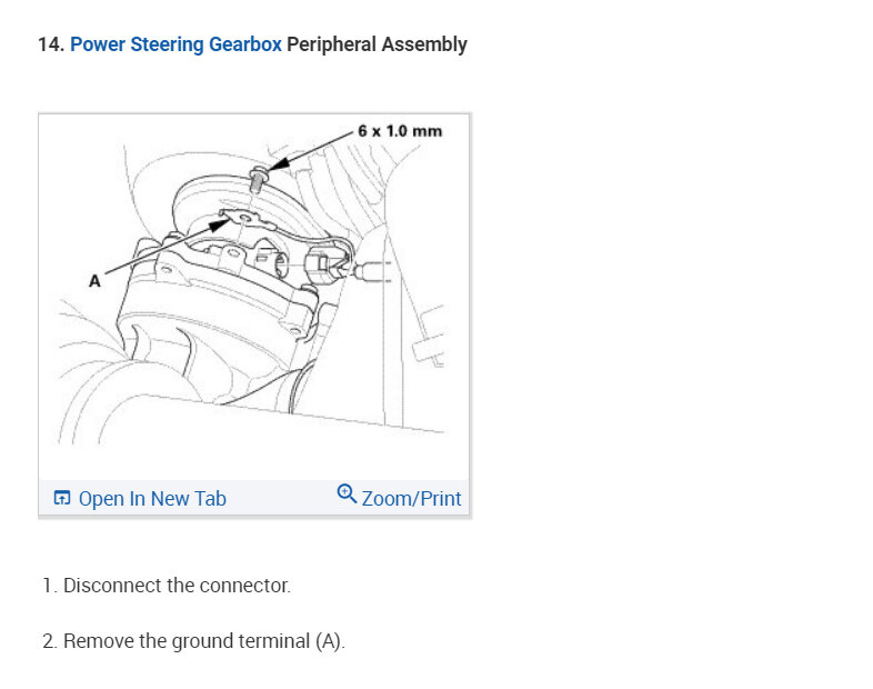

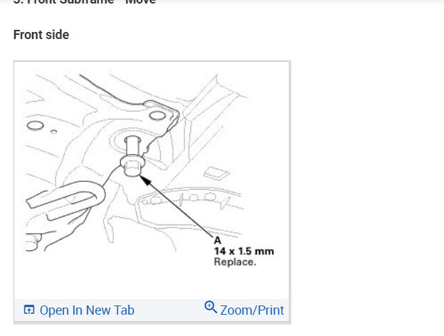

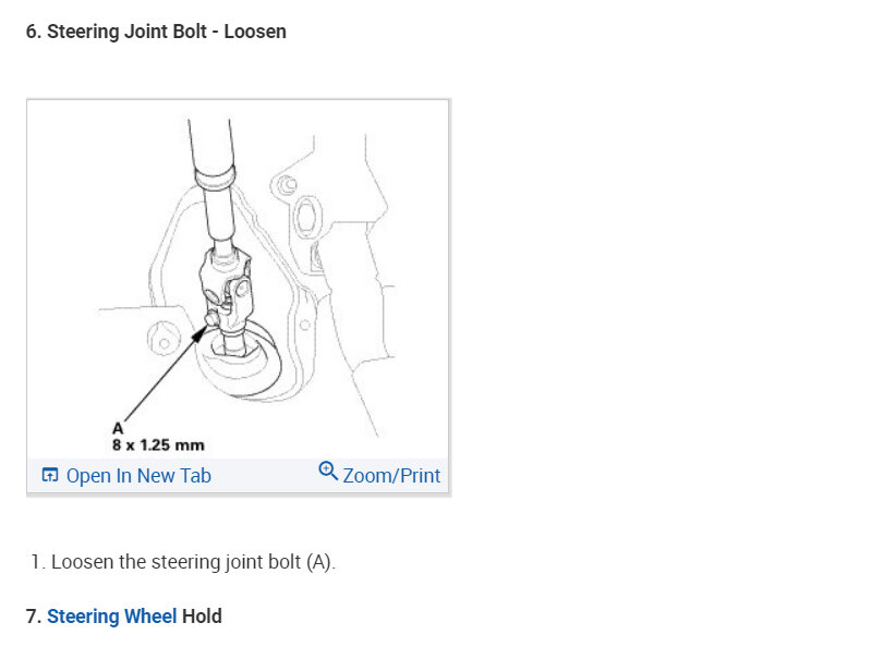

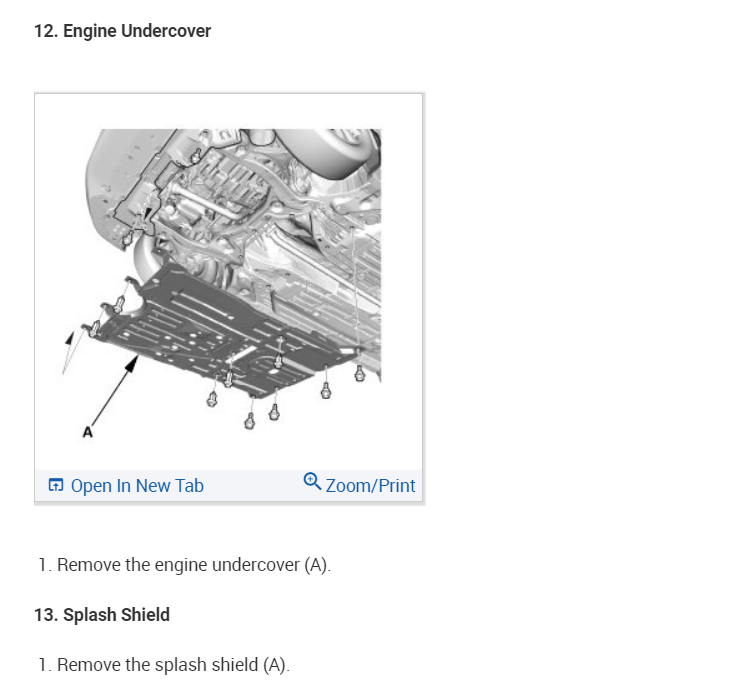

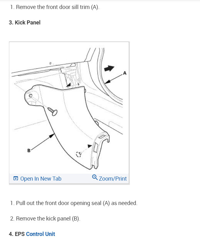

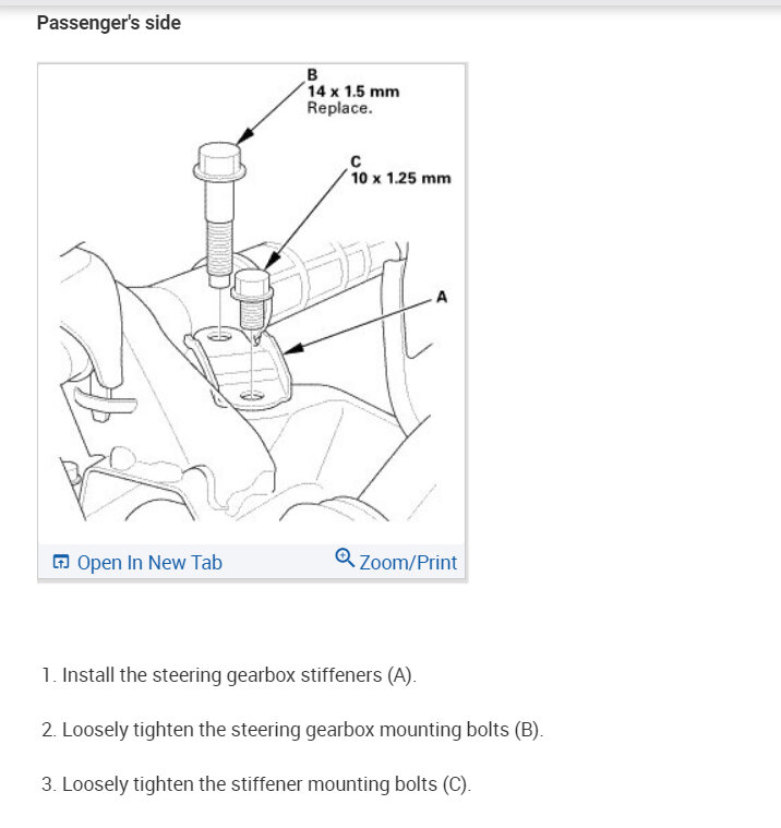

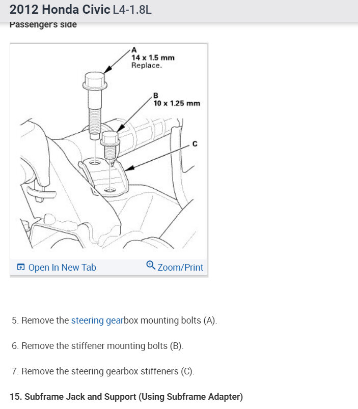

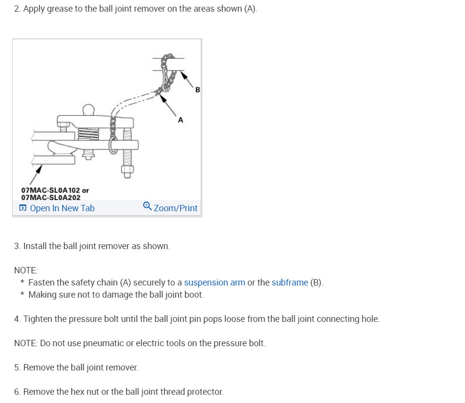

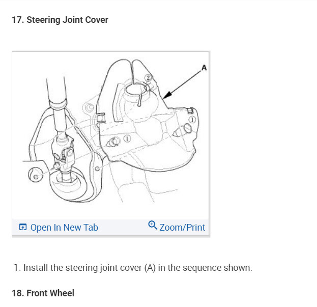

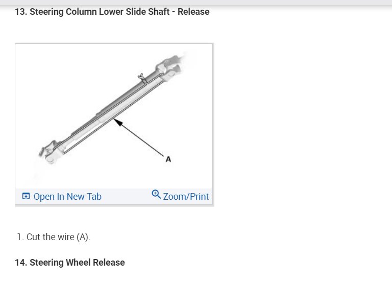

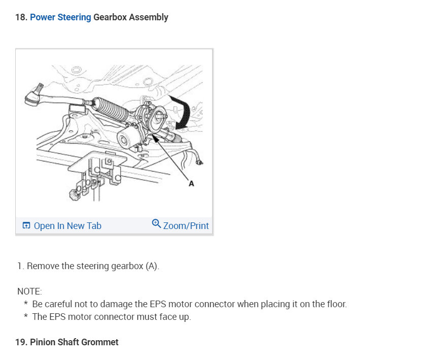

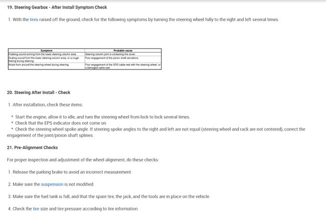

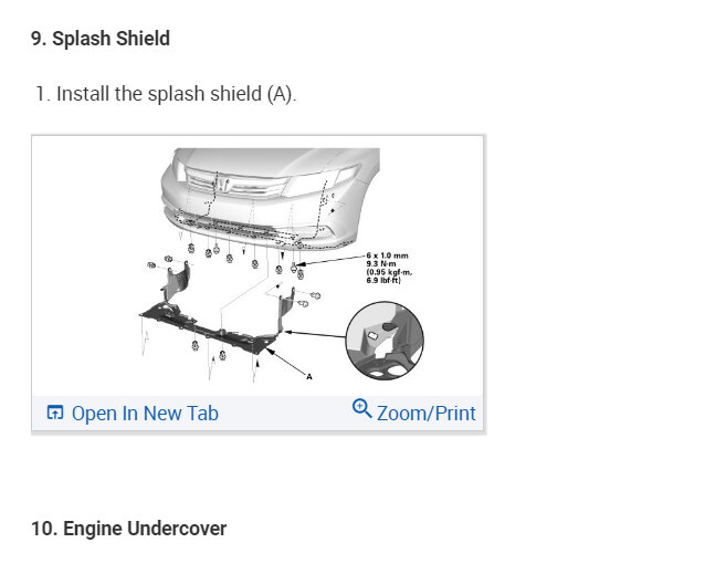

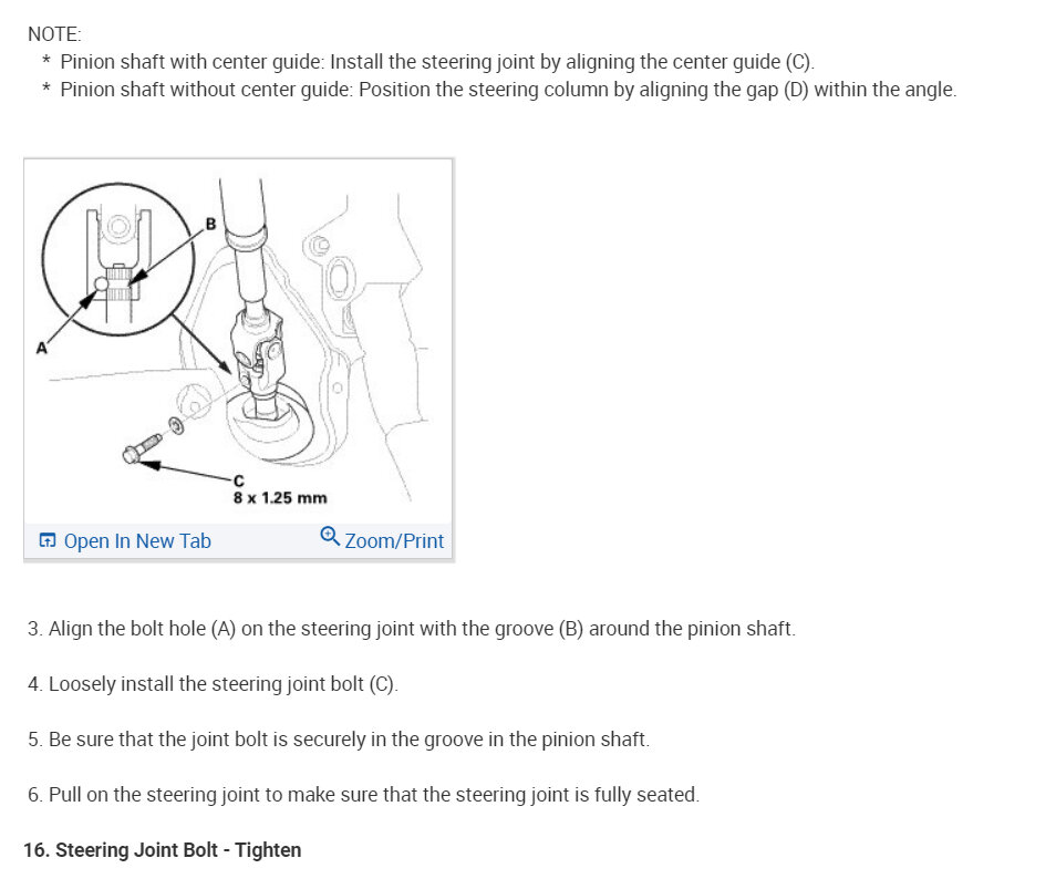

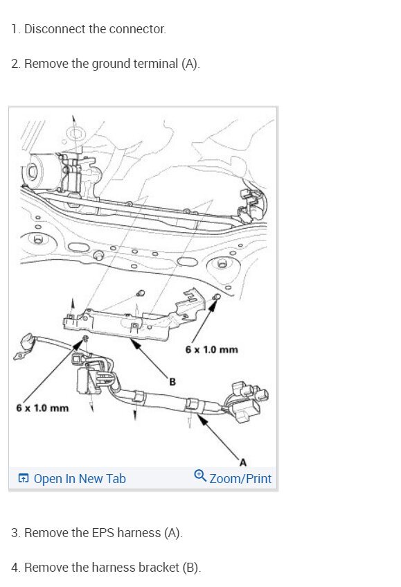

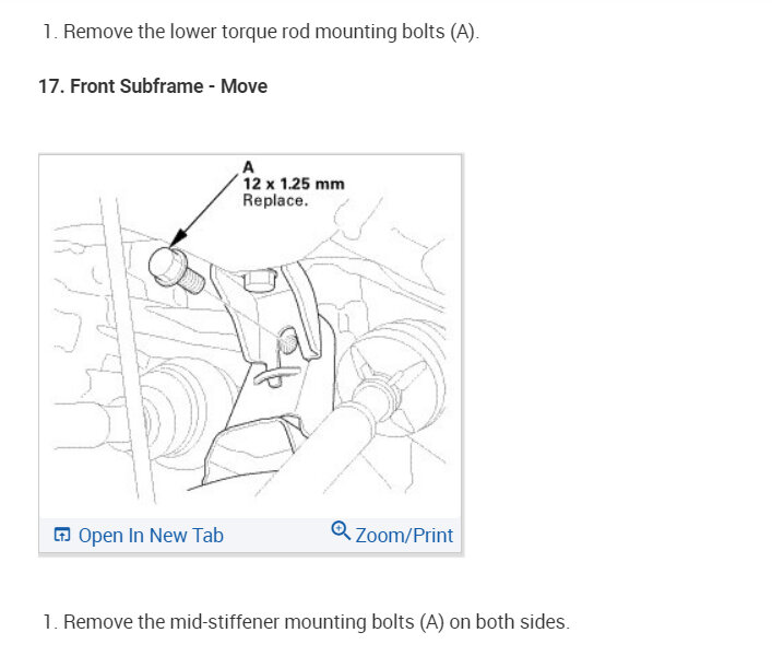

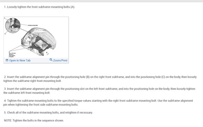

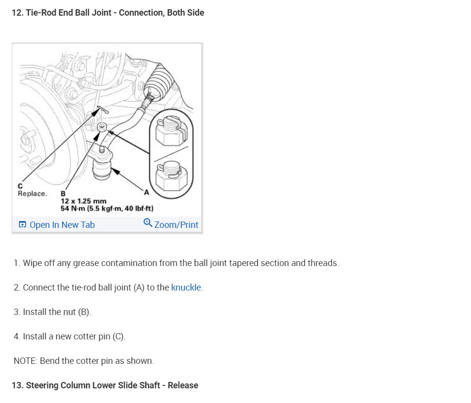

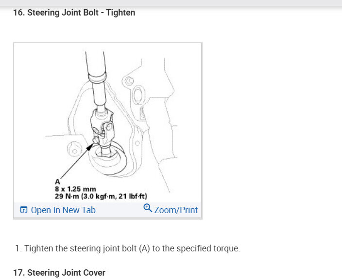

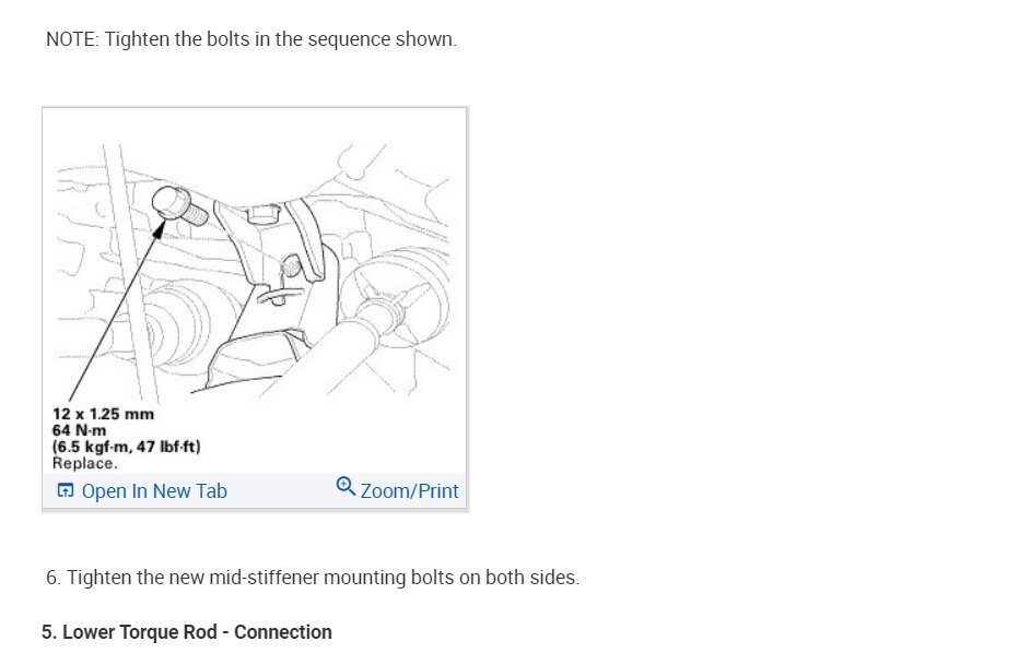

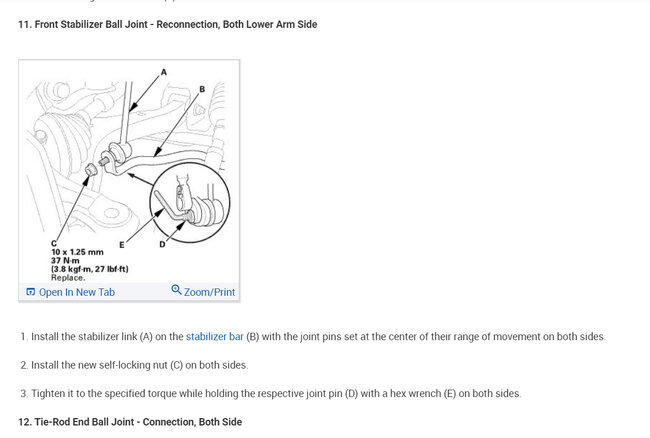

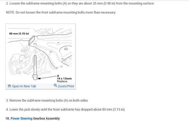

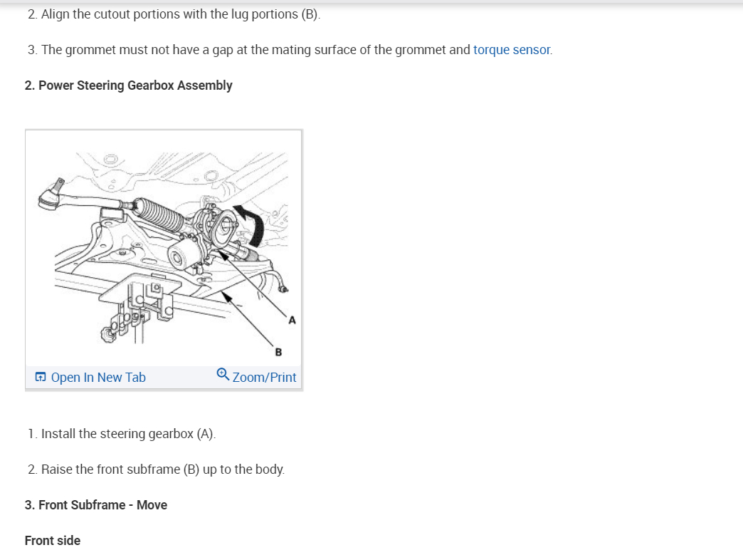

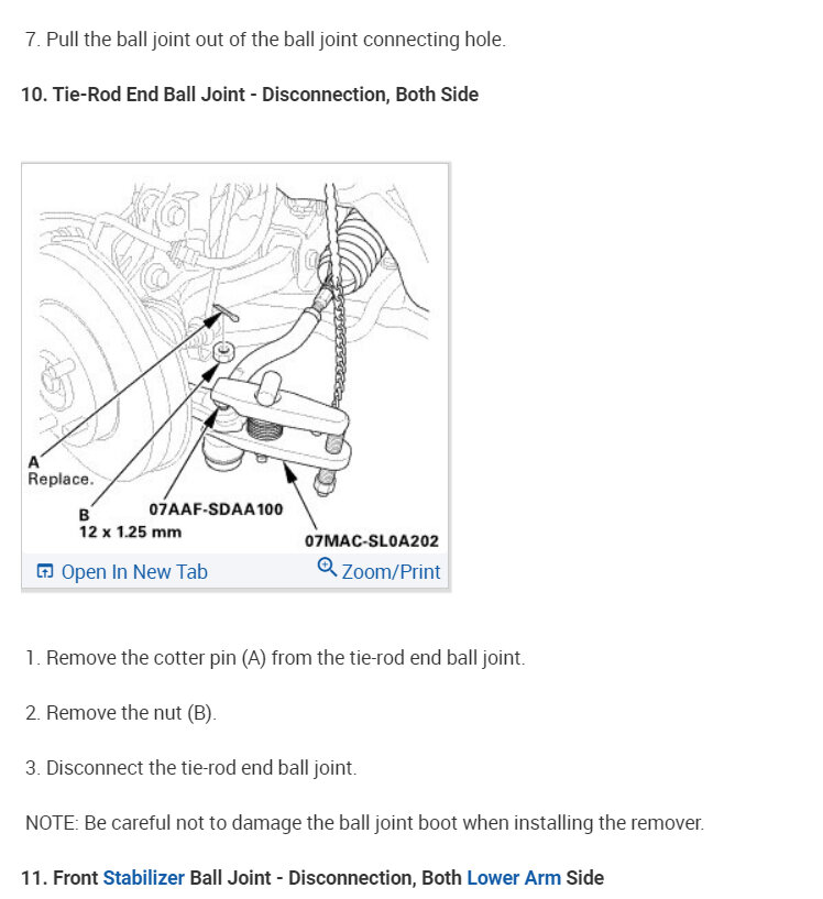

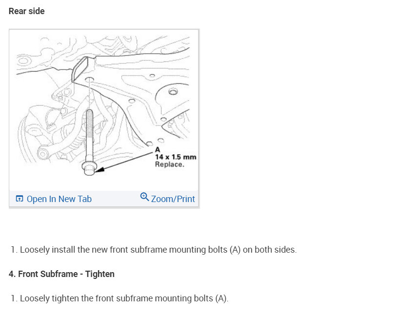

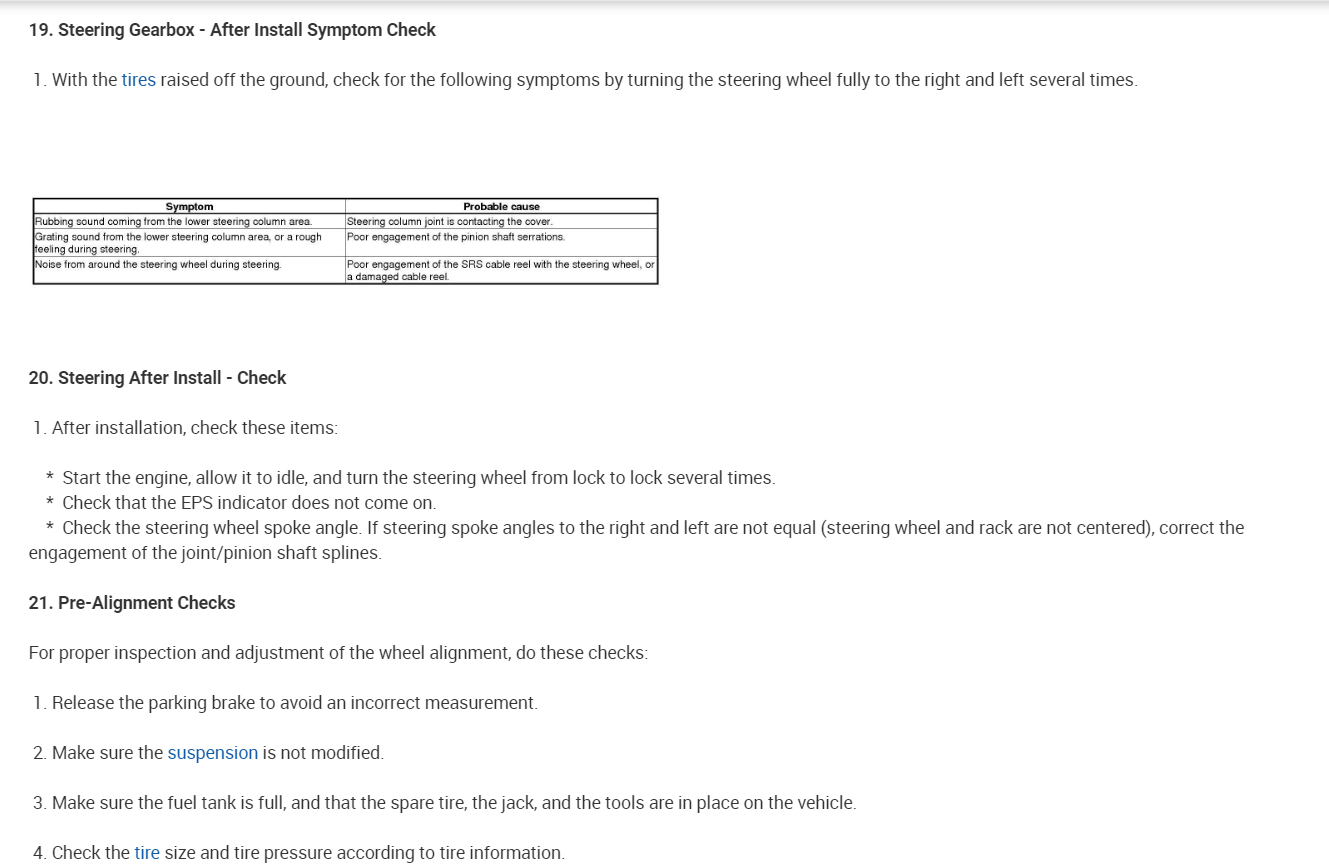

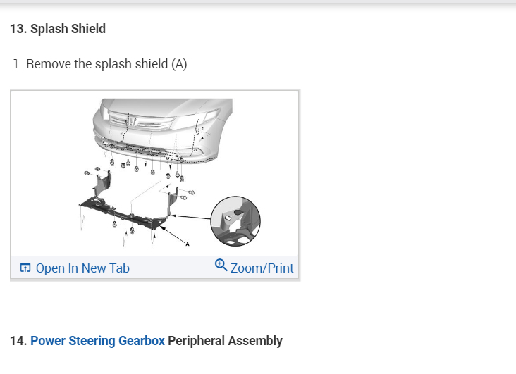

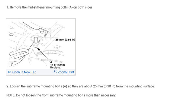

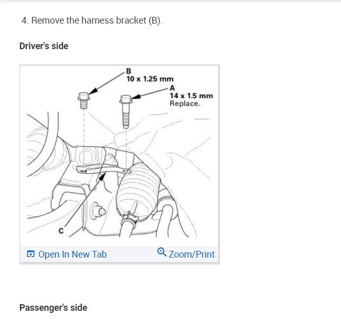

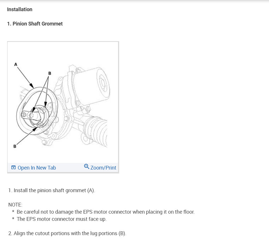

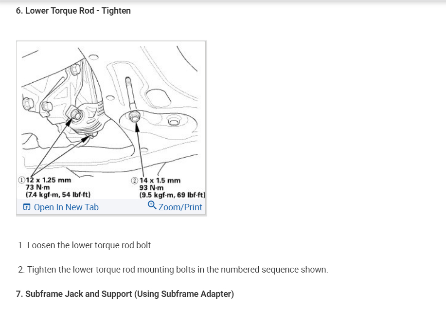

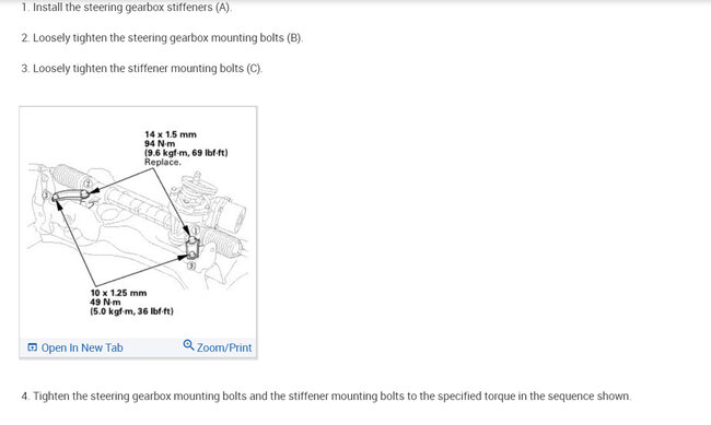

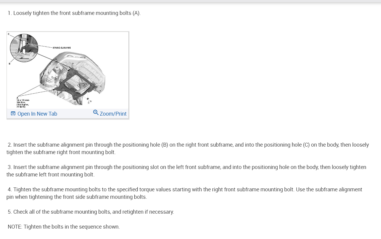

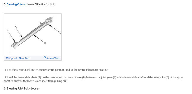

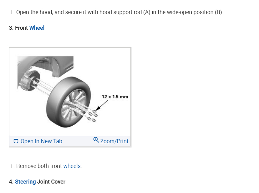

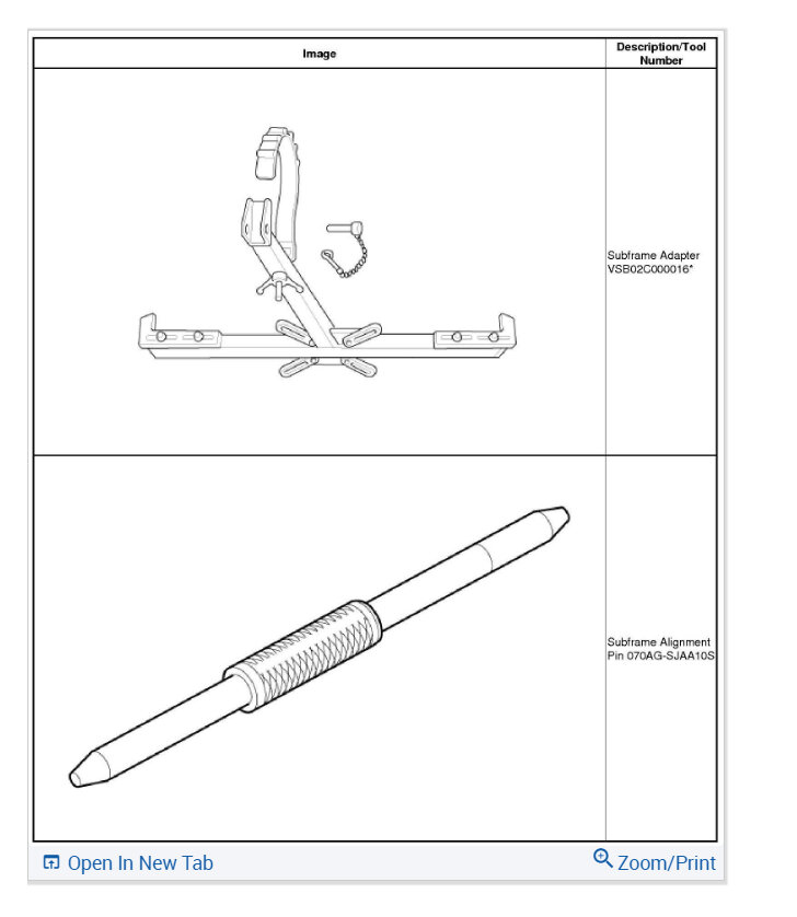

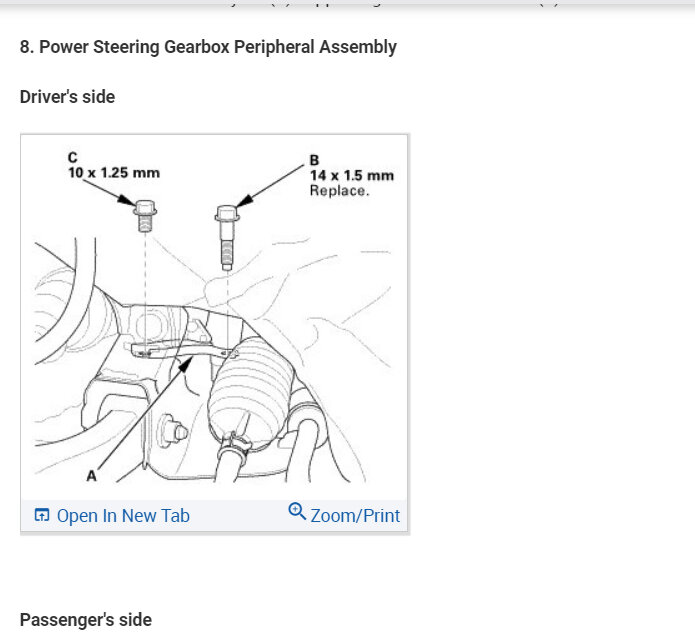

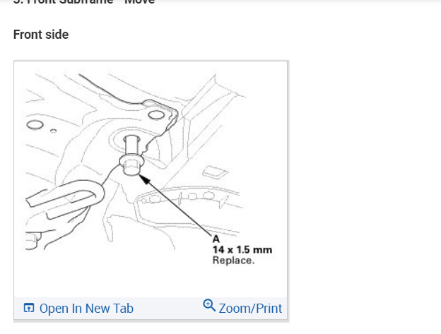

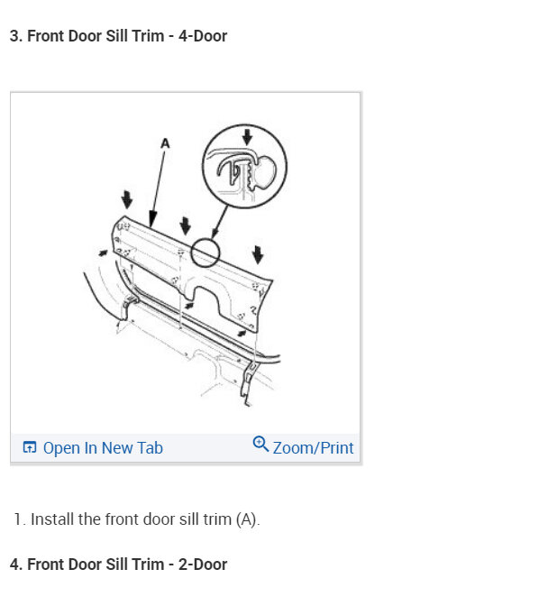

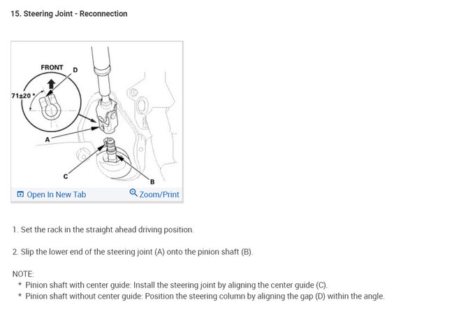

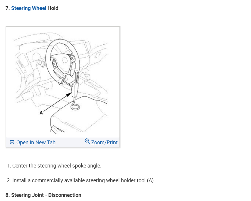

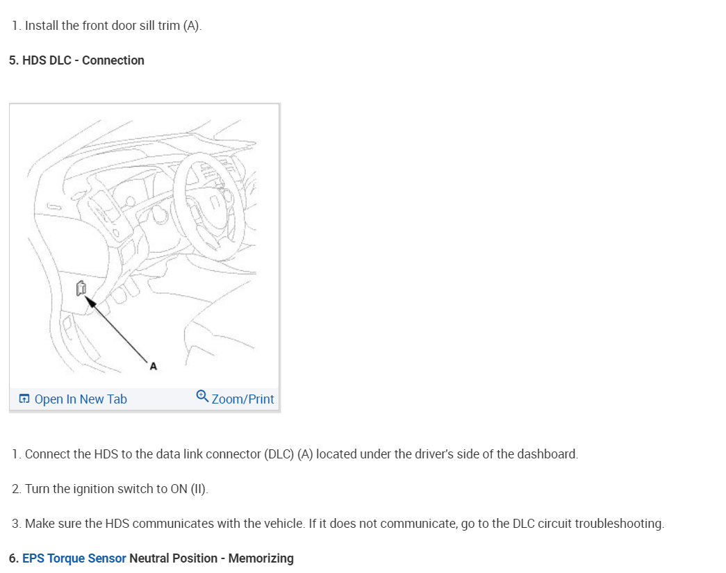

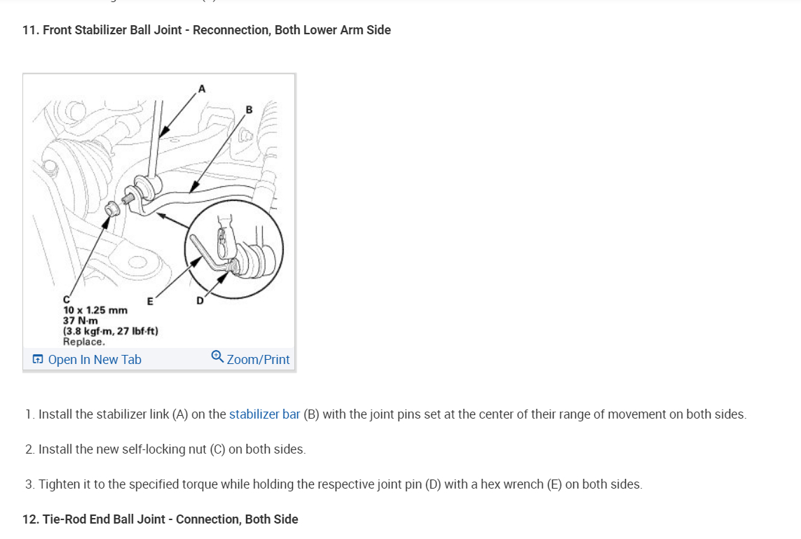

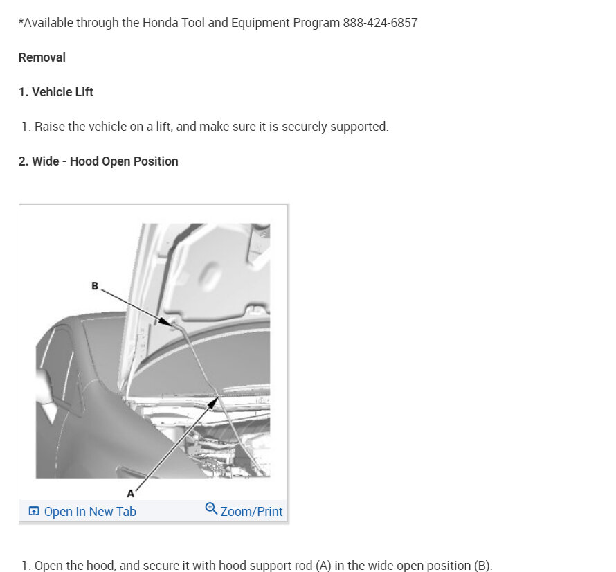

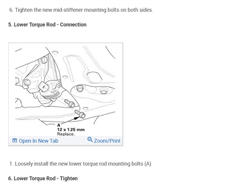

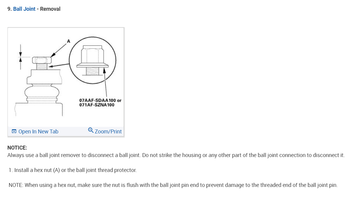

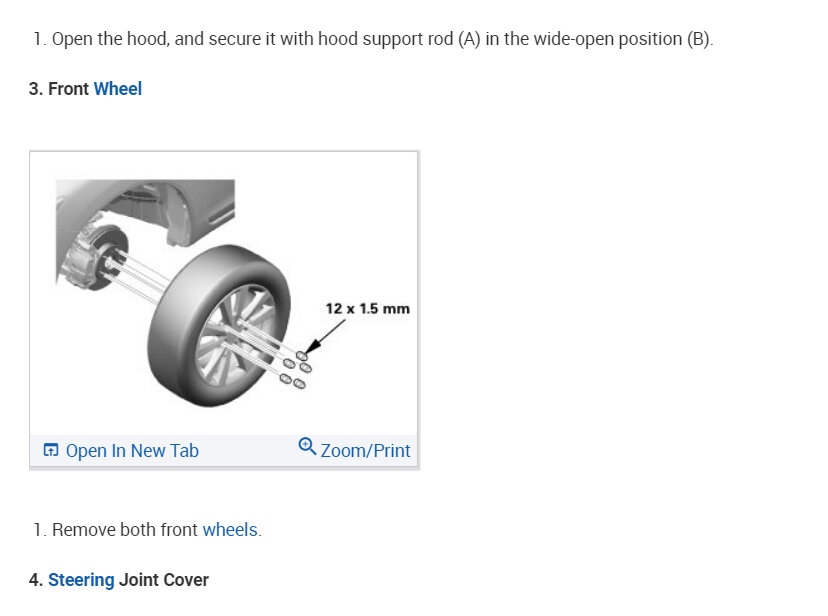

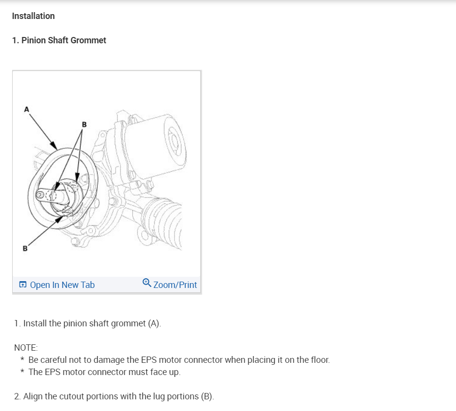

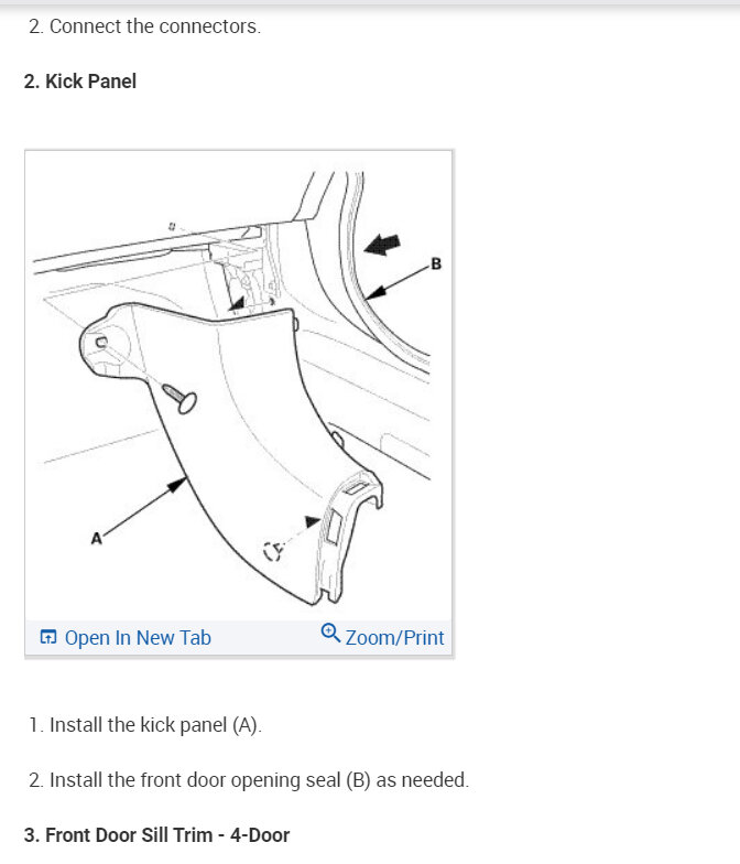

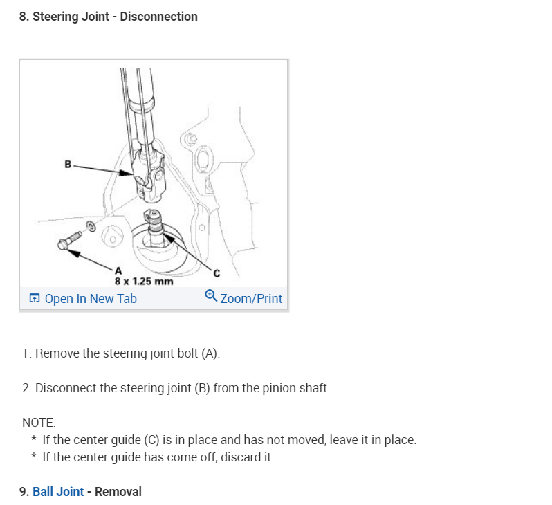

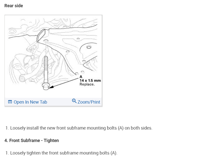

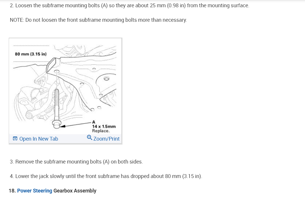

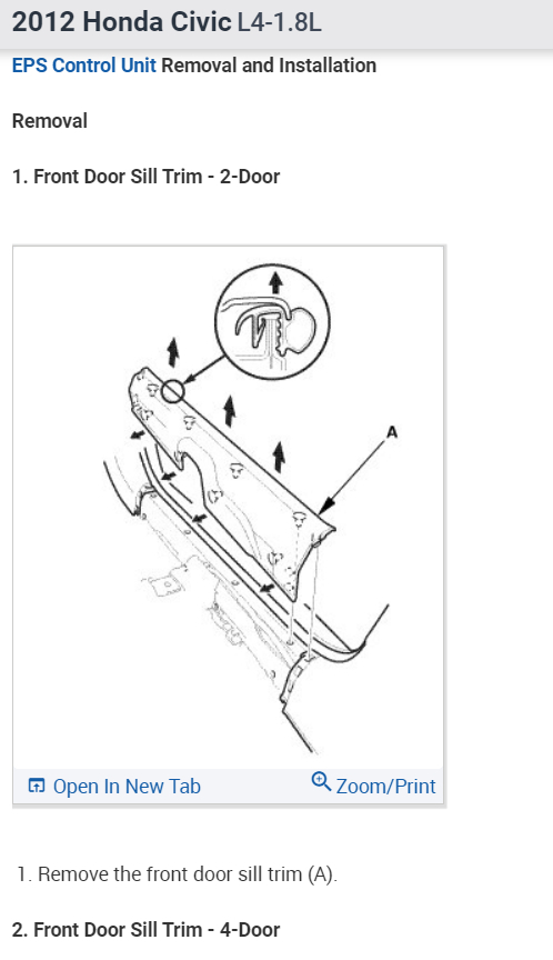

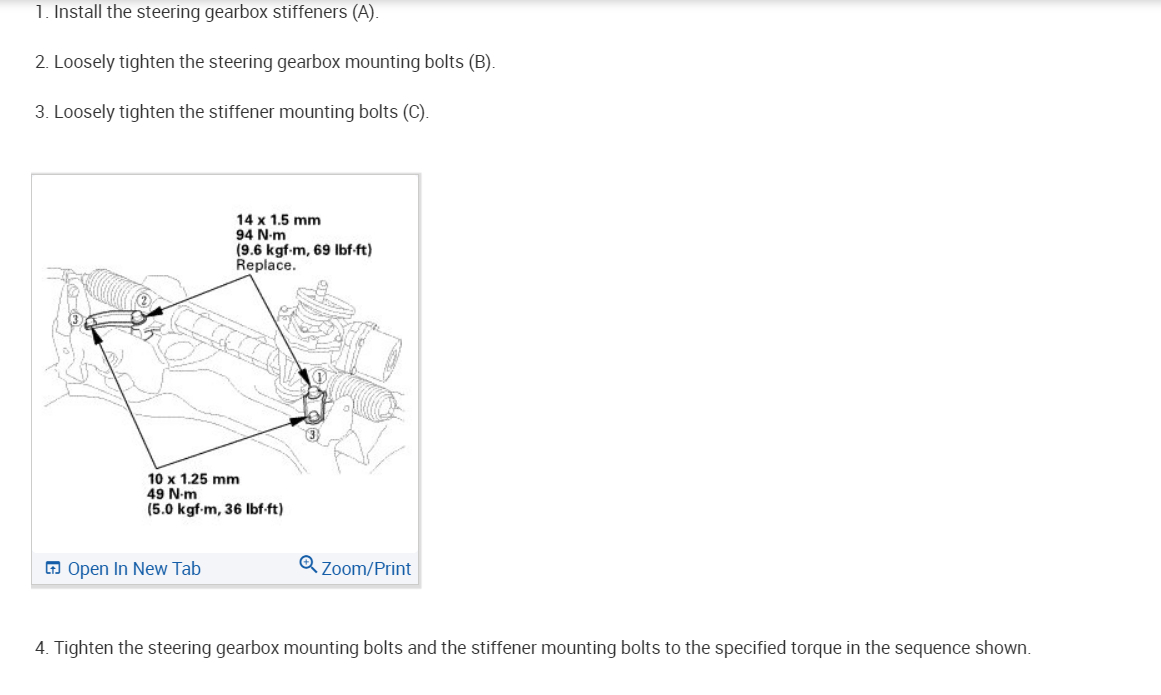

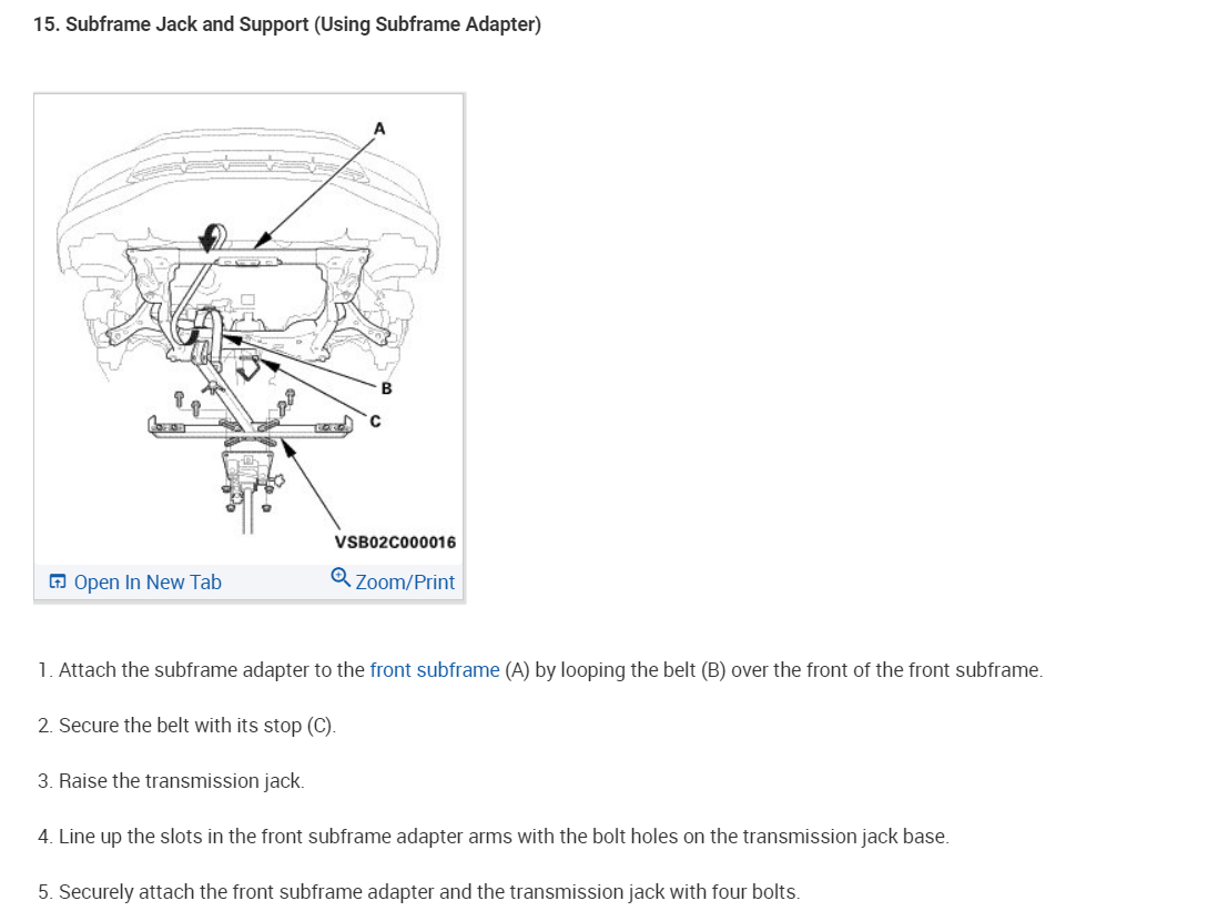

That does sound a little pricey. here is the cost of the rack and labor time in shop which you will need to multiply by the shop rate.
4 - Steering Gear 53601TS8A04 $1612.82
Complete Assembly With Transfer Of Parts B 4.6 HRS at shop rate. so, if the shop is at $120.00 an hour it would be $552.00

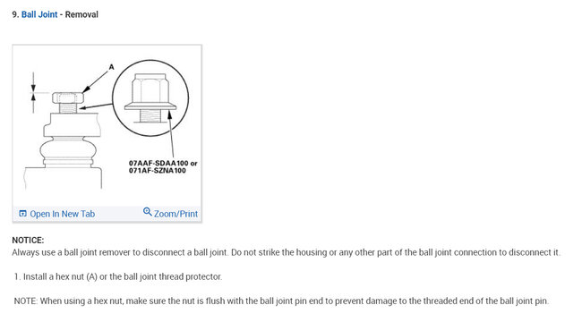

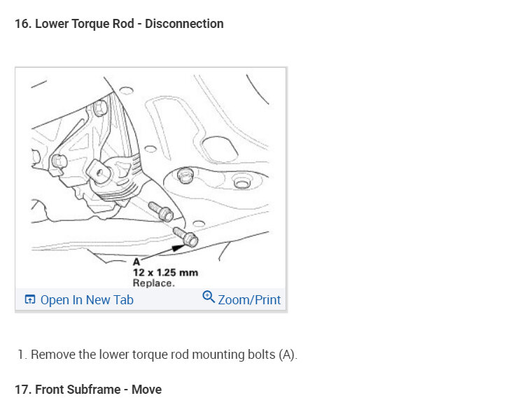

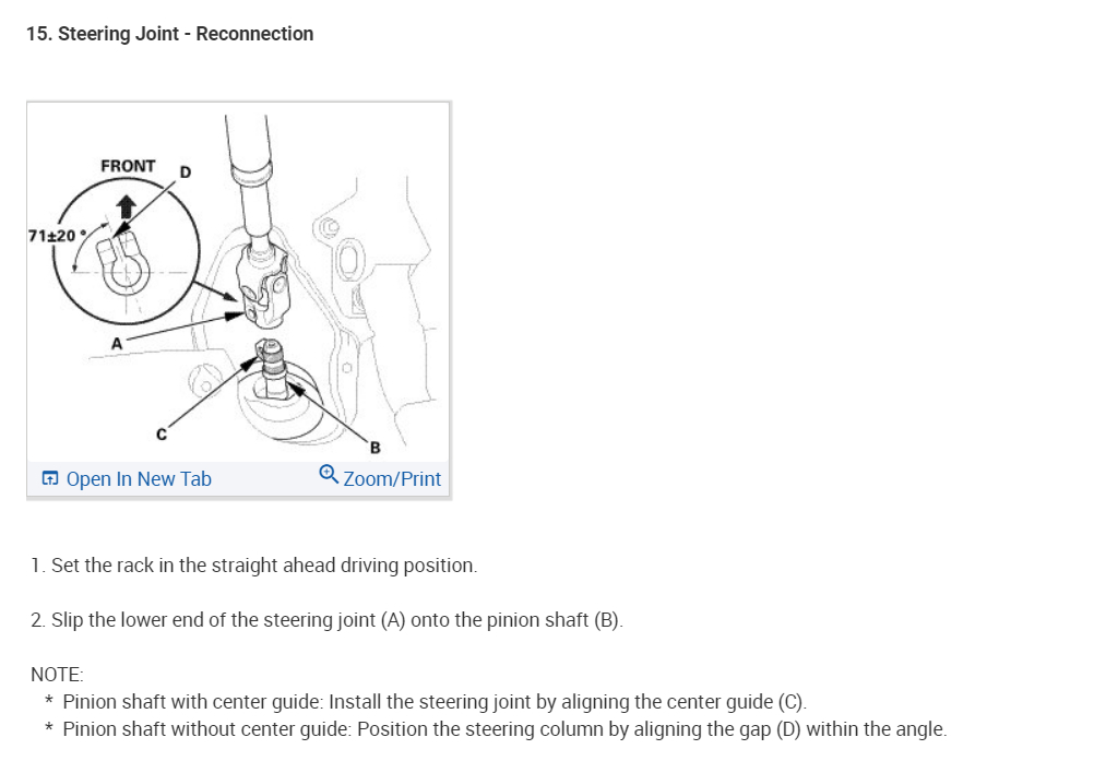

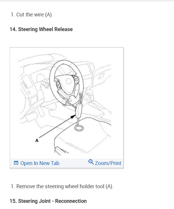

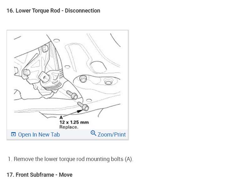

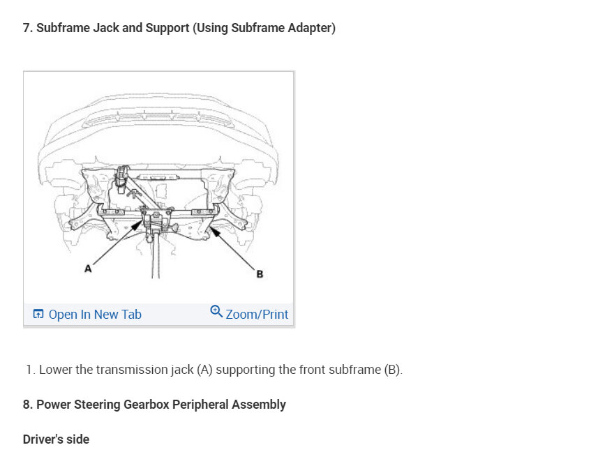

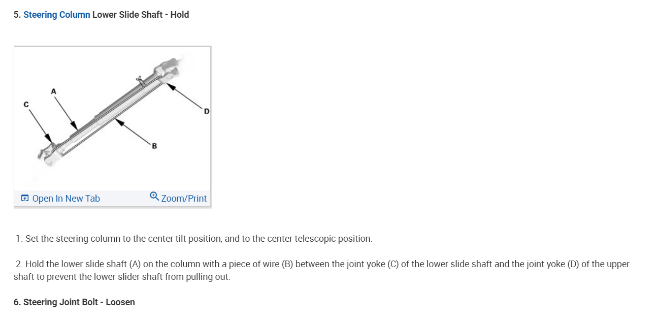

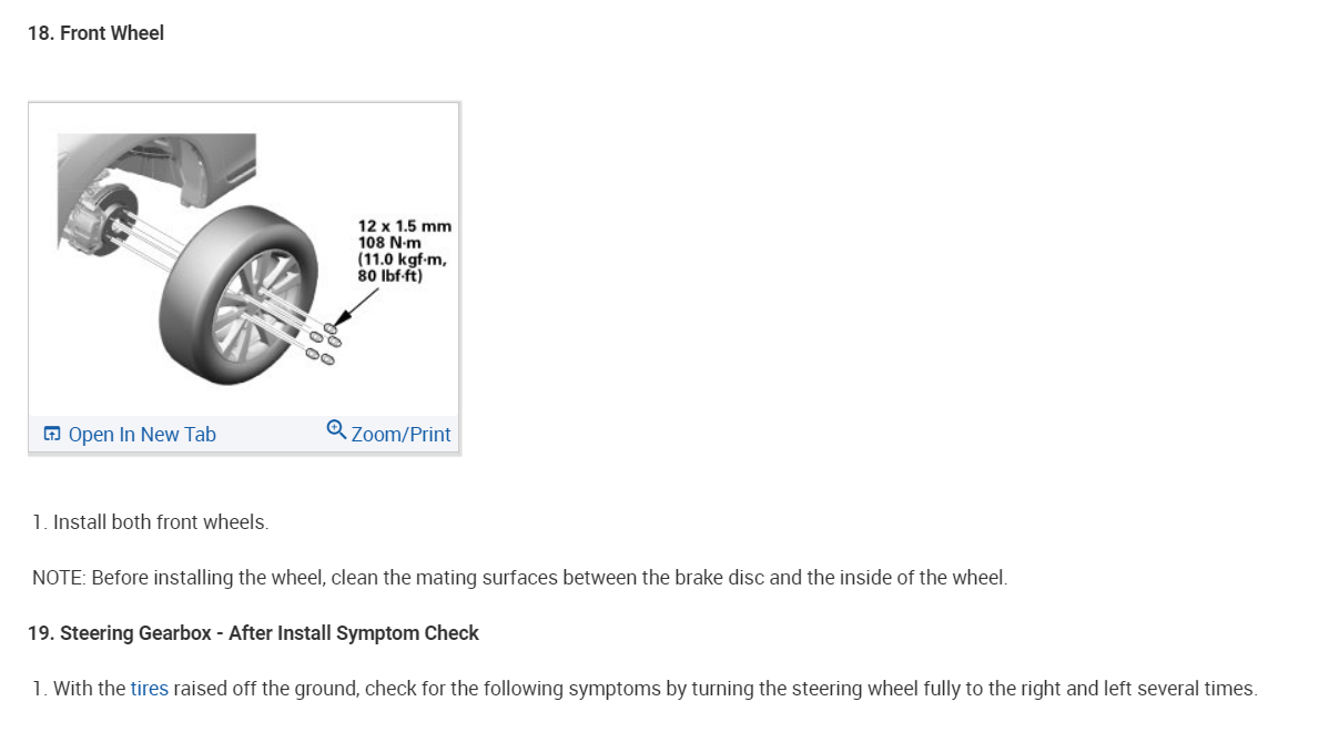

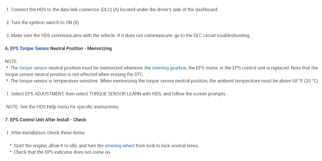

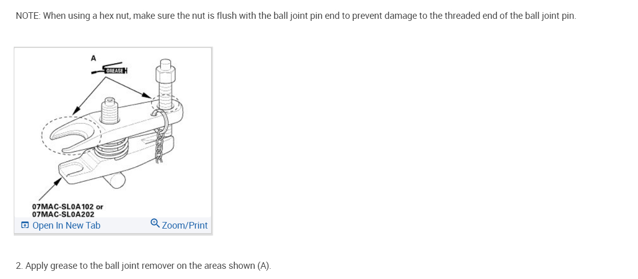

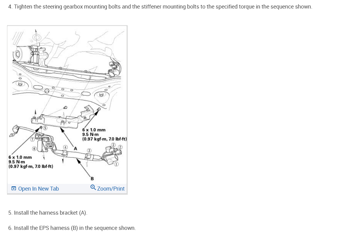

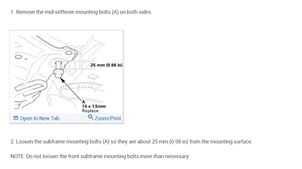

Here is how the job is done in the images below in case you what to see what you are paying for. Check out the images (below). Please let us know what happens.

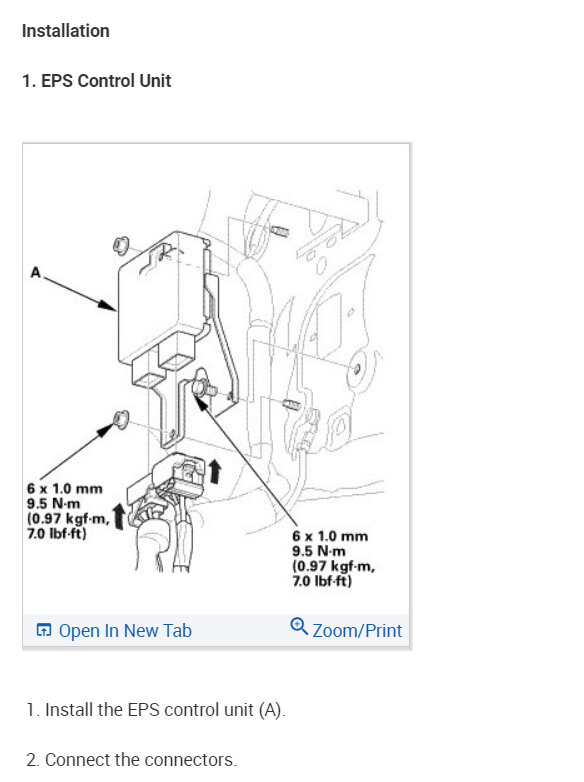

And while checking the mechanical function, I asked them to ensure they ran the onboard diagnostics which cost me $110 but I think was well worth it in the end.

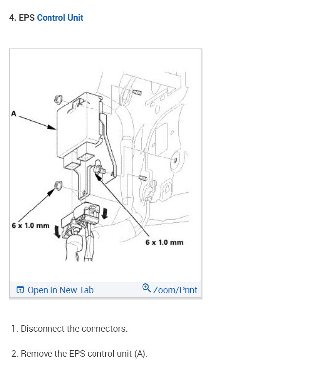

The problem is was diagnosed as a faulty, EPS control module.
This part has been ordered and will be installed at a total cost to me of $800

  • 55,433 POSTS

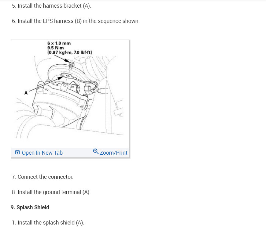

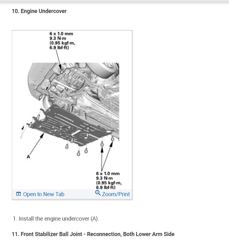

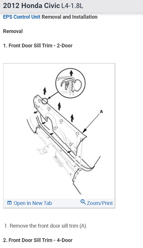

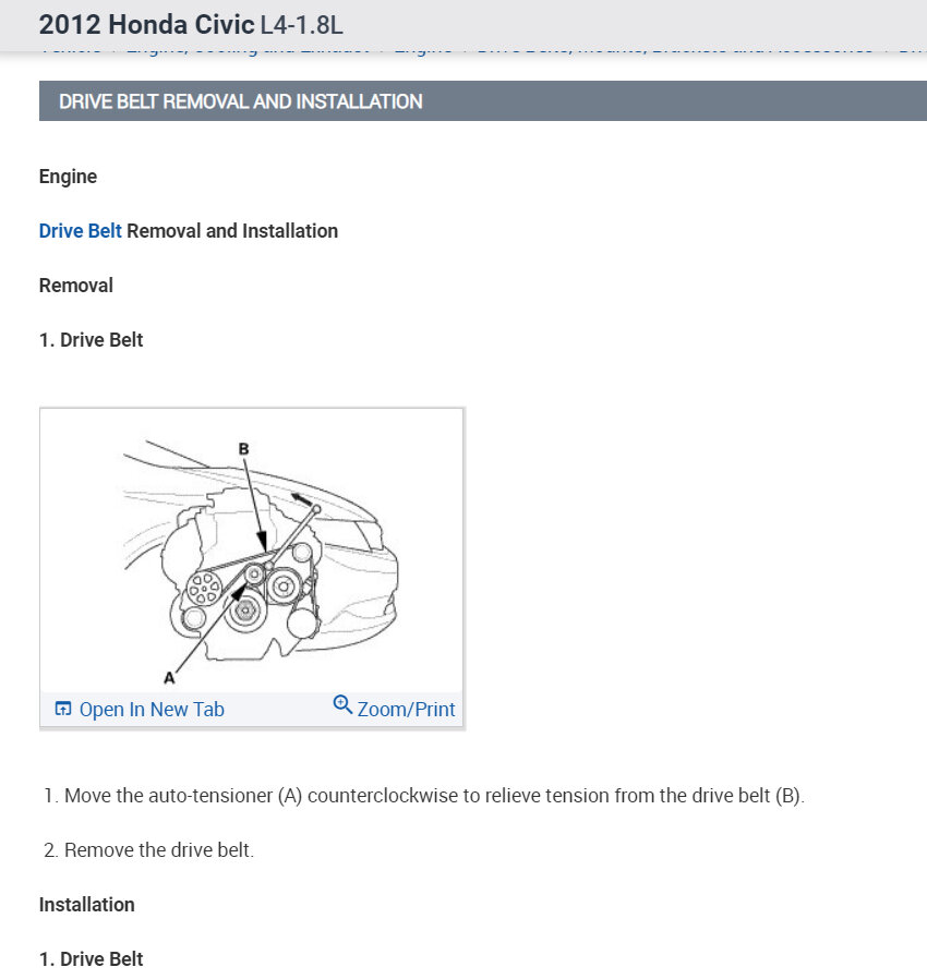

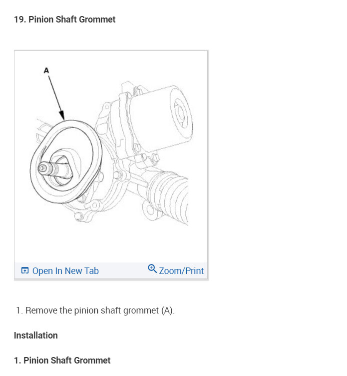

Yep, I am not a fan of EPS either, I think manufactures will end up going back to the old faithful systems that work better and are easier and cheaper to work on, (I hope anyway). I have included the replacement of the EPS control unit so you can see what you are paying for. Also, $300.00 for a serpentine belt sounds a little high? I have included the prices for that as well.
Control Module 39980TS8A01 $563.52
Labor Control Module 0.9 hrs @ shop rate.
Serpentine Belt:
Bando Without AC Serpentine Belt 31110R1AA11 $52.08
With AC
Mitsuboshi Serpentine Belt 31110R1AA02 $89.85
Labor: Serpentine Belt 0.5 hrs @ shop rate.
