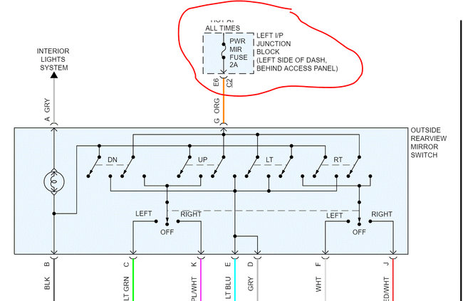

where is the fuse located?

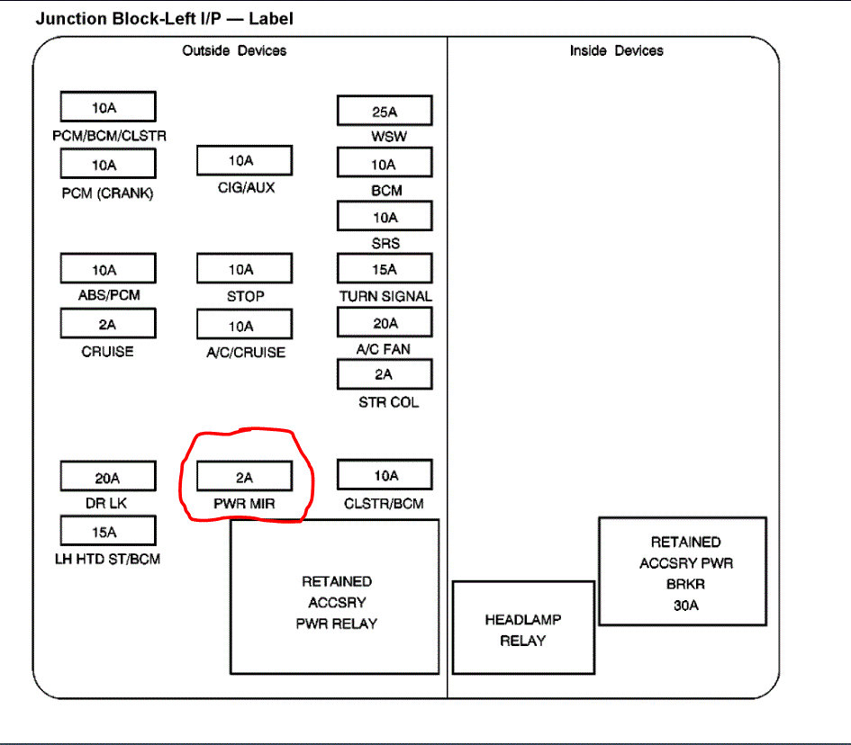

The fuse is in the left hand instrument panel fuse box. It is a 2 amp fuse. Don't use a higher amperage in place of that fuse because damage can occur.
I attached two pics below. First is a portion from the schematic in the event the fuse checks good. You can check for power to the orange wire at the switch for power. Note there should be power all the time at that point.
The second pic is of the fuse box. I circled the fuse to locate.
When you check the fuse, in addition to only looking at the fuse, make sure there is power to it. Here is a link you may find helpful:
Let me know what you find or if you need help with anything.
