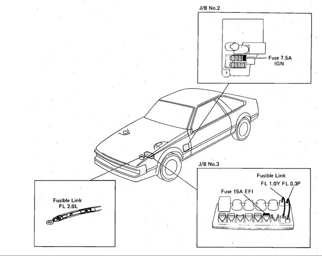

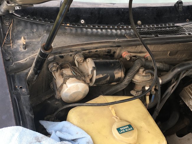

I had my alternator go out and changed it, yes I was sure the alternator was the issue, so I changed it. i made sure to connect everything correctly and now there’s no electricity to the car. I found a wire that runs from the same grouping as the alternator that isn’t connected to anything and I can’t find its home.
Jul 17, 2020 at 3:51 PM
Good morning,
Can you upload a video or pictures of the wire that is hanging free? I attached a diagram for you to view.
Do you have power to the alternator from the battery?

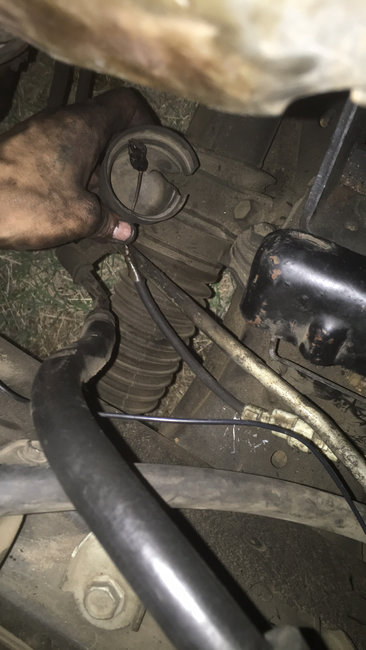

I can send a couple pictures and video if you need.
Jul 18, 2020 at 6:35 AM
SLIDYMK2
  • 11 POSTS
This is the wire end:
Jul 18, 2020 at 6:36 AM
SLIDYMK2
  • 11 POSTS

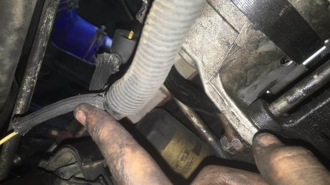

This it where it splits off from the alternator.
Jul 18, 2020 at 6:41 AM
SLIDYMK2
  • 11 POSTS
Or at least from the same wires as the alternator.
Is the yellow cut back by the alternator? It looks like the wire is cut.
Jul 18, 2020 at 8:53 AM
SLIDYMK2
  • 11 POSTS
No all the wires to the alternator are connected and in tact.

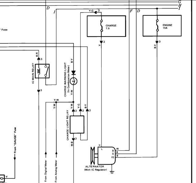

Is that a used alternator or did you not change out yet?
Do you have power to the alternator wire from the battery? You need 3 wires with power to the alternator. Can you verify that?
Jul 18, 2020 at 8:49 PM
SLIDYMK2
  • 11 POSTS
I only believe I have 2 the harness and the ground. I can send more pictures too.
Jul 20, 2020 at 11:06 AM
Please send as many as you can. The diagrams I have are generic and I would like to see what you see.

Could you possibly tell me what part this is?

That is the wiper motor and has nothing to do with the alternator.

You say that, but after fixed a wire on there i started the car today.

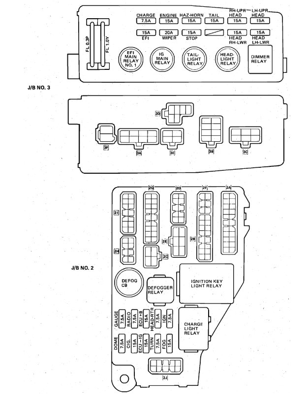

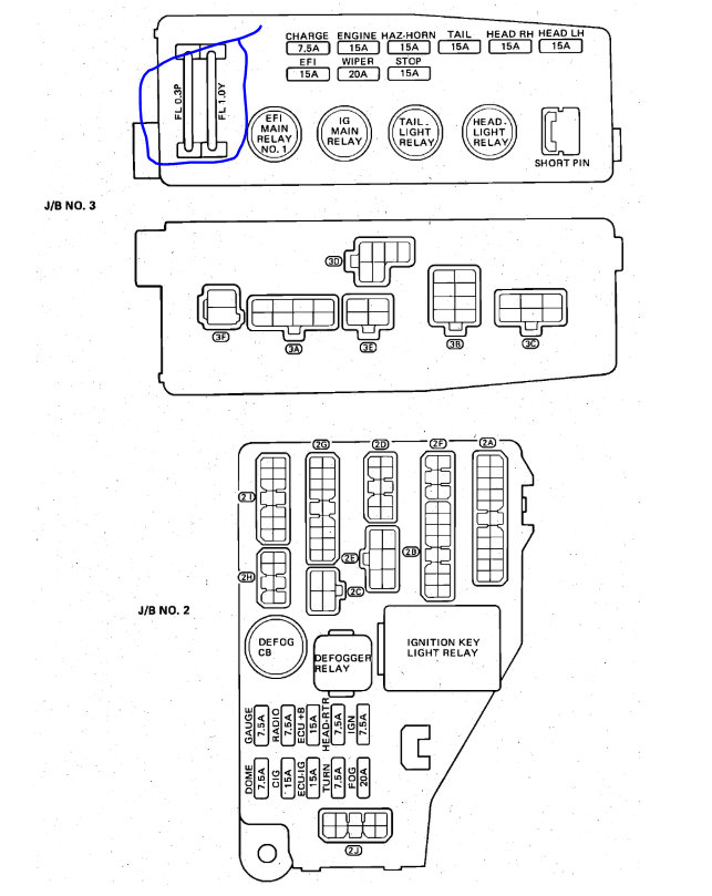

My friend that helped me thinks the wire that was off was arcing on the car
Jul 27, 2020 at 8:12 AM
Then check the fuse block for a high amp fuse. Test it on both sides with a test light.
