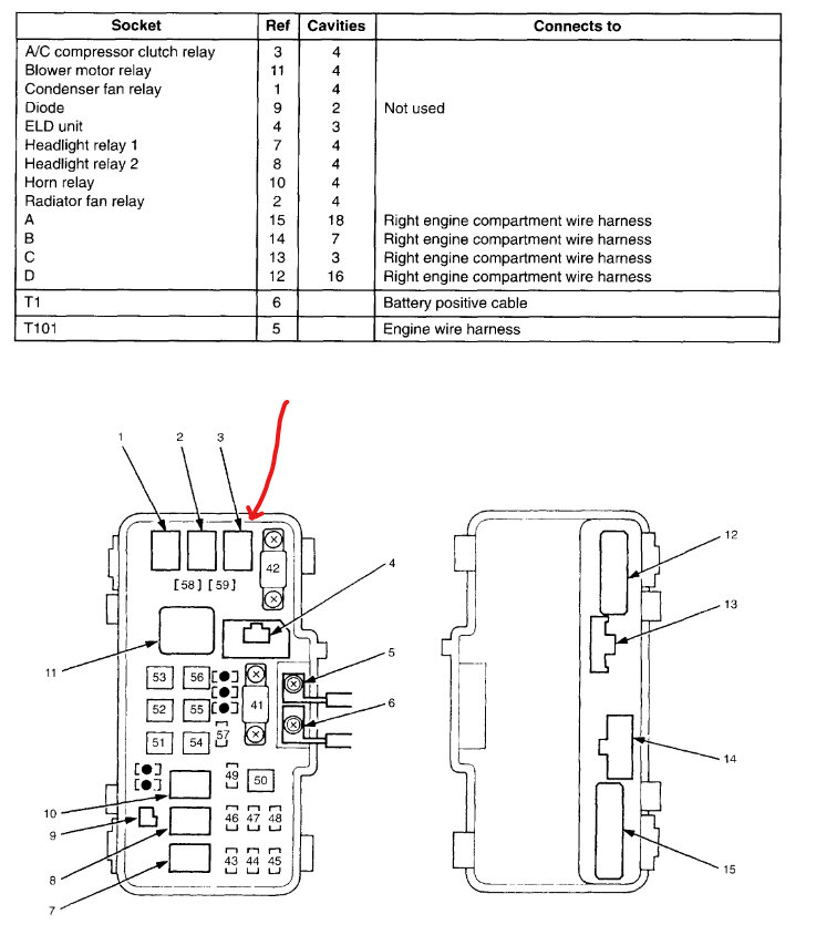

Battery drains, when I put a jump box on it, it beeps and says it is reverse polarity or something like that?
1998 HONDA ACCORD
207,000 MILES • 3.0L • V6 • 2WD • AUTOMATIC
BEETLEPUNK21
  • 127 POSTS
I just bought this vehicle. Brand new battery but there is a drain somewhere.
It will drain the battery completely! The only way to start the vehicle is using jumper cables from another car.
When I put a jump box on it, it beeps and says it’s reverse polarity or something like that.
After jump starting, the headlights and blinkers sometimes flash like maybe the security alarm is going off. But there is no noise, and the car is able to be driven.
Any idea where to start or look for?

I would remove the A/C compressor clutch relay to see if the drain stops, this is a common problem with these cars and will hold the clutch coil engaged for the compressor.
This guide can help as well:
https://www.2carpros.com/articles/car-battery-dead-overnight

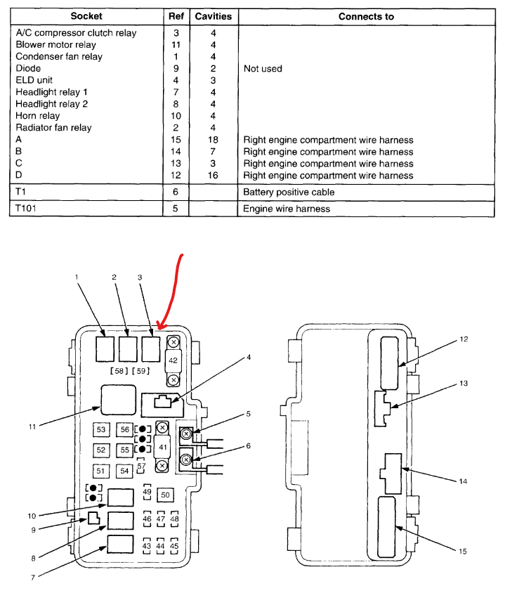

The jump box can just be responding to a really dead battery so I wouldn't worry about that unless you do have the cables mixed up. I would try the jump box on a known good battery to see if it functions correctly. Here is the location of the compressor relay. Check out the images (below). Let us know how it goes.

Did you try the A/C compressor control relay? Also please go over this guide:
Please go over this guide and get back to us.
