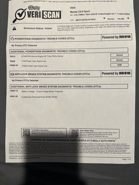

Well, I was driving on the interstate my cars dashboard started flickering and displaying smart brake malfunction cruise control malfunction cruise control disabled. The steering wheel locked and Car was jerking and slowed all the way down. Please help!!

Thanks for getting back to me. I actually did take my car to o’Reilly auto parts and they did a test. I have attached below what the test showed. Thanks so much for being willing to help me because I have no idea. lol

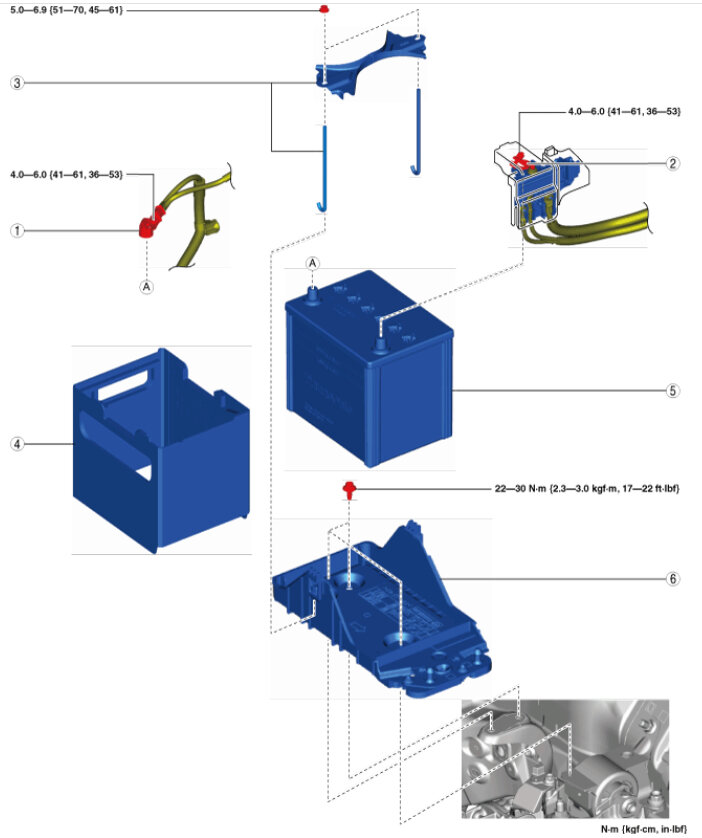

Okay, the big code that stands out is the battery below threshold. So I would remove the battery and take it to the auto parts store for testing. Then I would clear the codes to see what happens. This guide will show you how with instructions below to help with your car.
https://www.2carpros.com/articles/how-to-replace-a-car-battery
