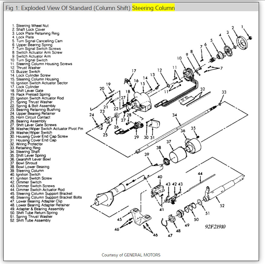

Car will lose complete electric power while driving. No noise, no lights, turn the key and absolutely nothing. I think it is a wiring issue under the steering column. I jiggled some wires and it started everything. Drove it again and complete loss of power. Got to start again but something with a wire that powers everything is going bad. I noticed my radio cut out first and the fact was jumping around. Then complete power failure.

Yep, if you can move wires around under the steering column it sounds like the switch is bad, I would replace it and check the wiring connections at the switch. Check out the diagrams (below). Please let us know what you find.

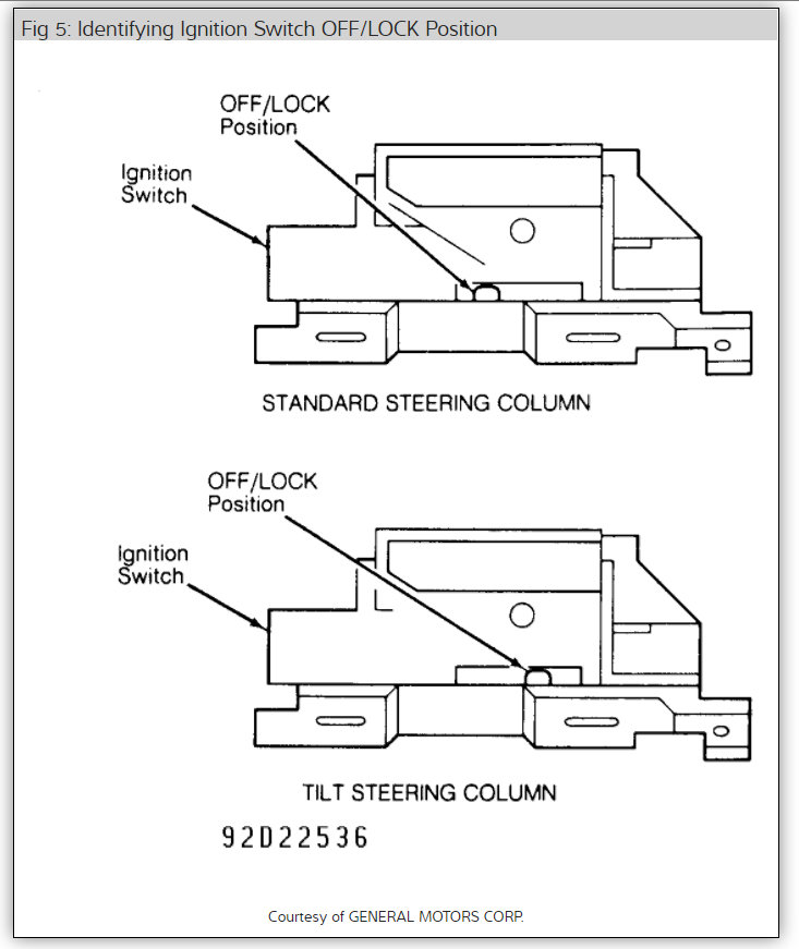

Would it be the ignition switch even though the car starts fine and was running when the power went out?

Yep, when you move the wires it moves the contacts inside the switch, but like I say check the wiring as well.
