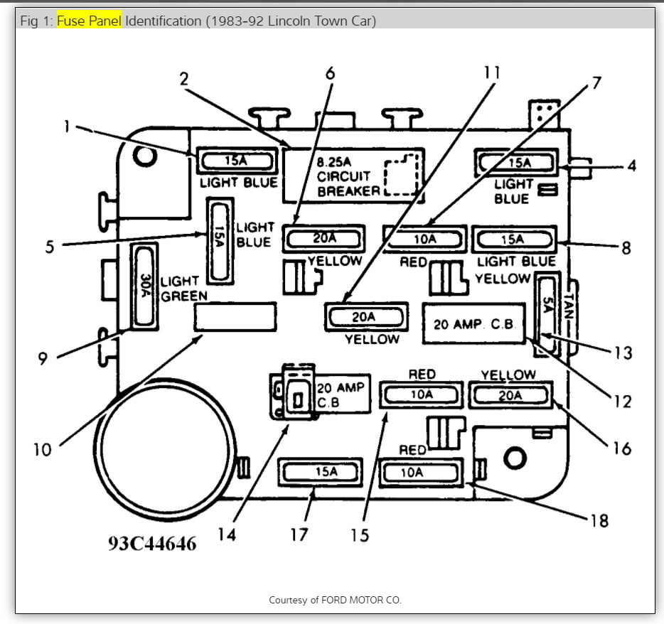

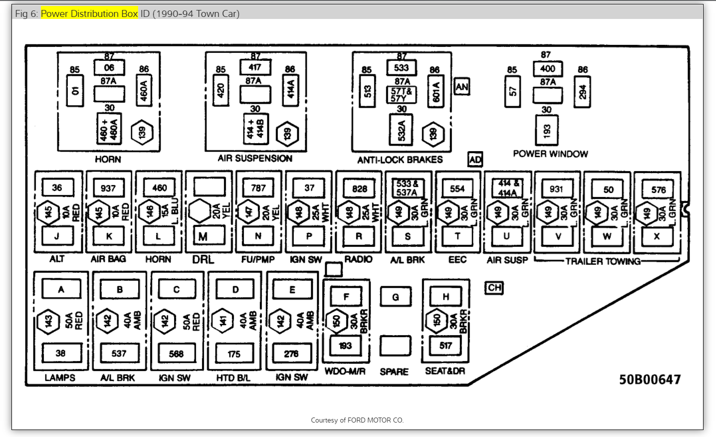

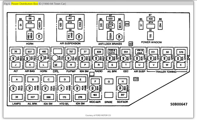

The electric instrument panel does not light up at all.
Nov 4, 2017 at 7:09 AM
Experienced Mechanic
55,676 POSTS
Is it an LCD display instrument cluster? I would start by checking the fuses.
Here is a guide to help you get the job done:
Check out the fuse box diagrams below.
Cheers! Ken
