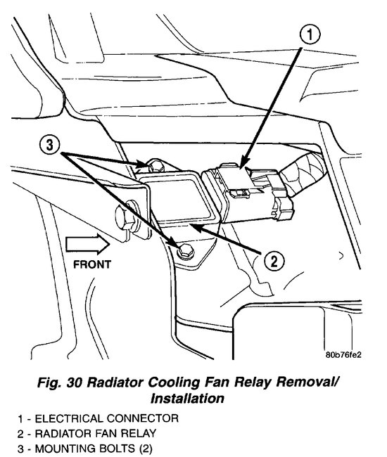

This car has a hybrid cooling system that uses both mechanical fan and electric, pulse width modulated electric fan. One fast way to determine if it is working is to turn on the AC and the fan should come on. If not the system has a solid state, electronic relay located on the left frame rail, behind the radiator. It is difficult to access as you have to remove the front bumper, grill and vacuum reservoir.

The pulse width modulated (PWM) radiator cooling fan relay is located behind the front bumper fascia below the right headlamp.
Operation:
The PWM relay is used to control the speed of the electric radiator cooling fan. It allows for multiple fan speeds. This allows for improved fan noise and A/C performance, better engine cooling, and additional vehicle power.

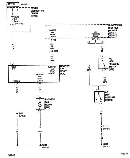

I do not know how you could have accessed the correct relay that fast but it is time for some troubleshooting which may require the use of a bidirectional scan tool.
Here is the wiring diagram.
