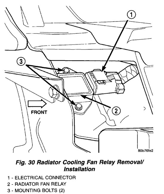

From the service manual
Description:
The pulse width modulated (PWM) radiator cooling fan relay is located behind the front bumper fascia below the right headlamp.
Operation:
The PWM relay is used to control the speed of the electric radiator cooling fan. It allows for multiple fan speeds. This allows for improved fan noise and A/C performance, better engine cooling, and additional vehicle power.
PWM relay operation is controlled by the Powertrain Control Module (PCM). To operate the PWM relay, the PCM looks at inputs from:
^ Engine coolant temperature.
^ Ambient temperature from the body controller.
^ Vehicle speed.
^ Transmission oil temperature.
^ A/C switch position (A/C request).

Left the car running with the AC on high for about twenty minutes, no movement on electric fan. swapped out relay, ran for another ten still no movement.
fan spins freely with engine off.
Mar 31, 2018 at 10:55 AM
WRENCHTECH
  • 20,761 POSTS

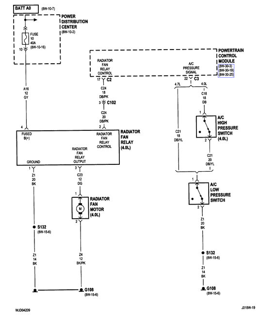

I do not know how you could have accessed the correct relay that fast but it is time for some troubleshooting which may require the use of a bidirectional scan tool.
Here is the wiring diagram.
Mar 31, 2018 at 11:01 AM

I have done it before, and the spot is still open. Mounted correctly to the body so it does not overheat and melt the wires.
Mar 31, 2018 at 12:31 PM
