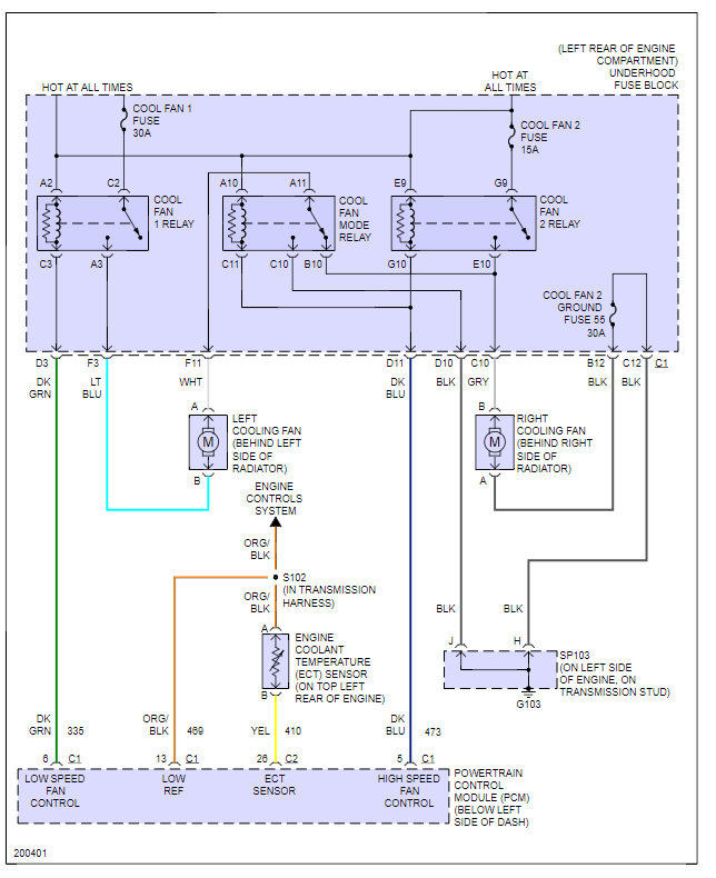

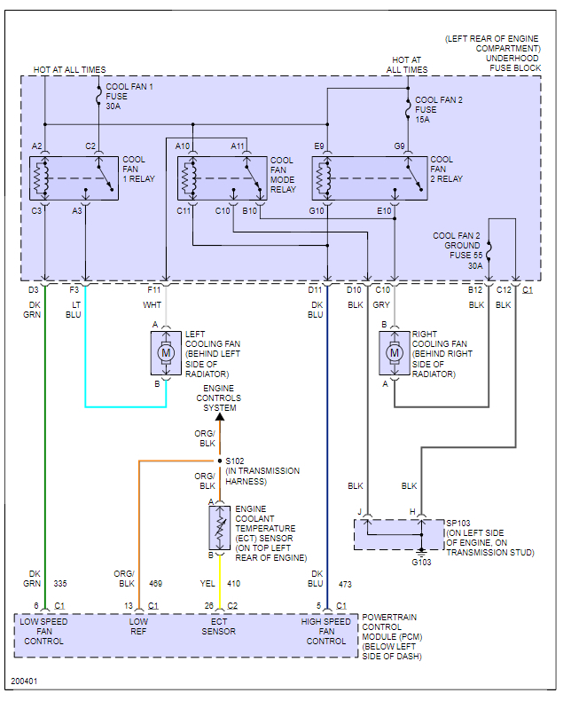

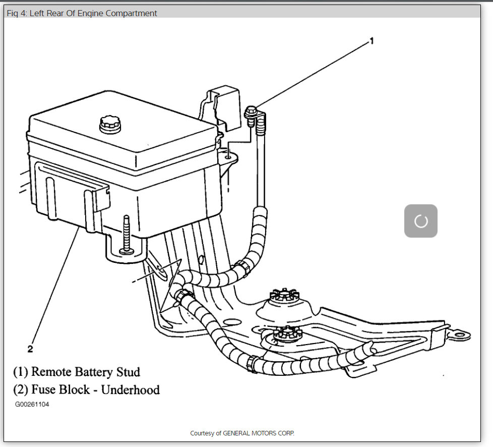

AC compressor locked up about a week ago and now my cooling fans will not come on. My car is getting hot. how to test? how do I test the relays or what do you think is why the cooling fans will not engage?
Sep 27, 2017 at 7:10 AM
  • 55,433 POSTS

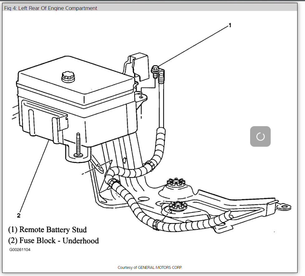

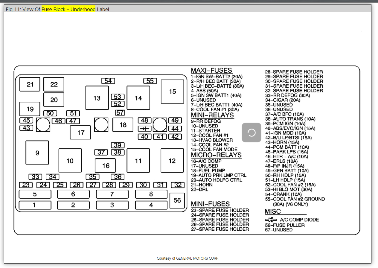

It sounds like when the compressor locked up it popped some fuses.
Here is a guide and some guides to get us started:
Please run this test and get back to us so we can keep helping you.
