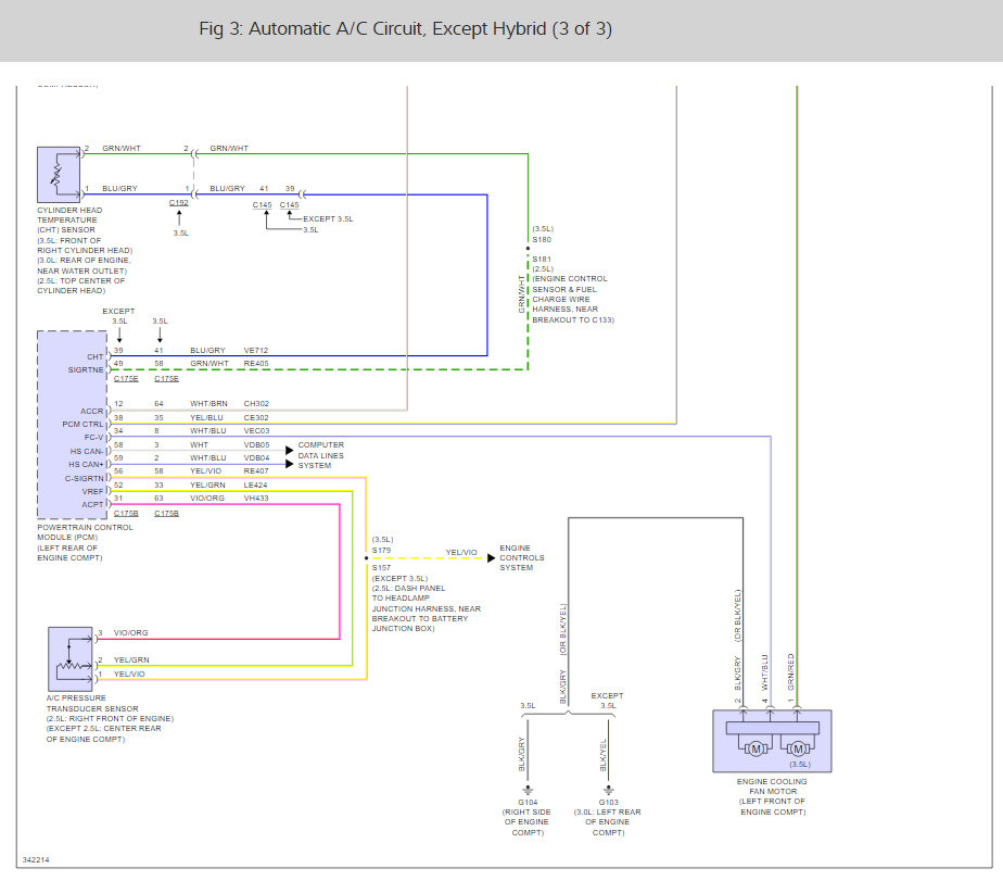

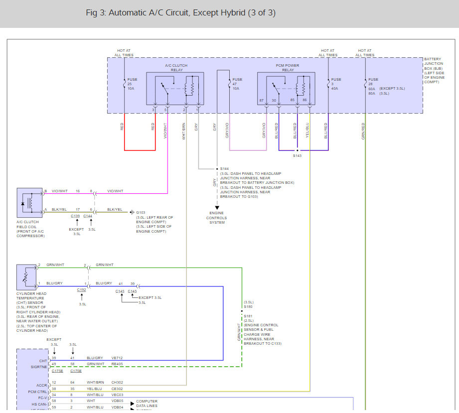

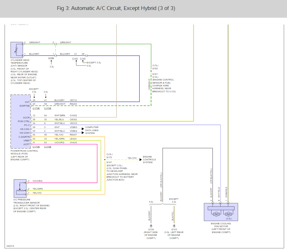

Turn A/C on the compressor kicks on and blows cold air. But the electric (cooling) fan does not switch to high speed. But I can take the pressure transducer switch and disconnect and the A/C clutch shuts off and fan kicks on high.
Aug 1, 2017 at 3:43 PM
  • 54,832 POSTS

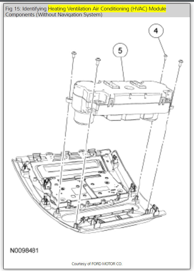

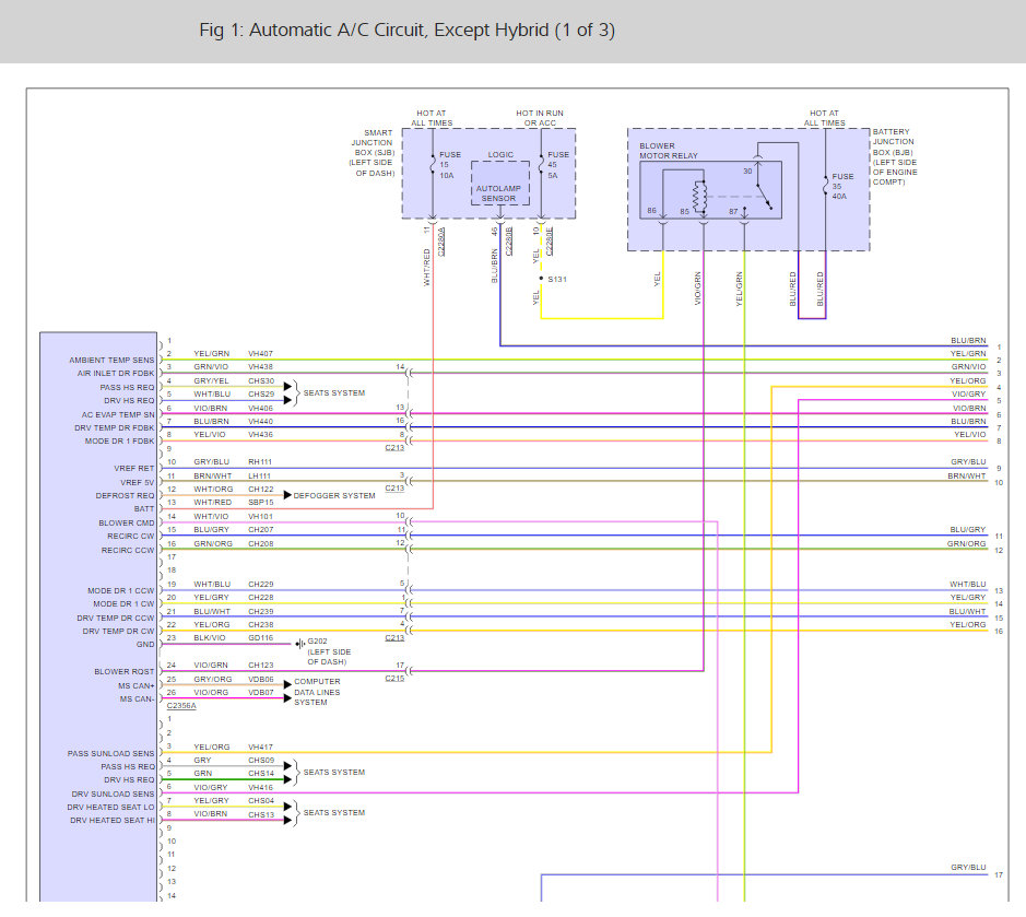

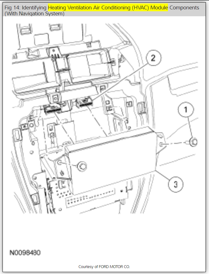

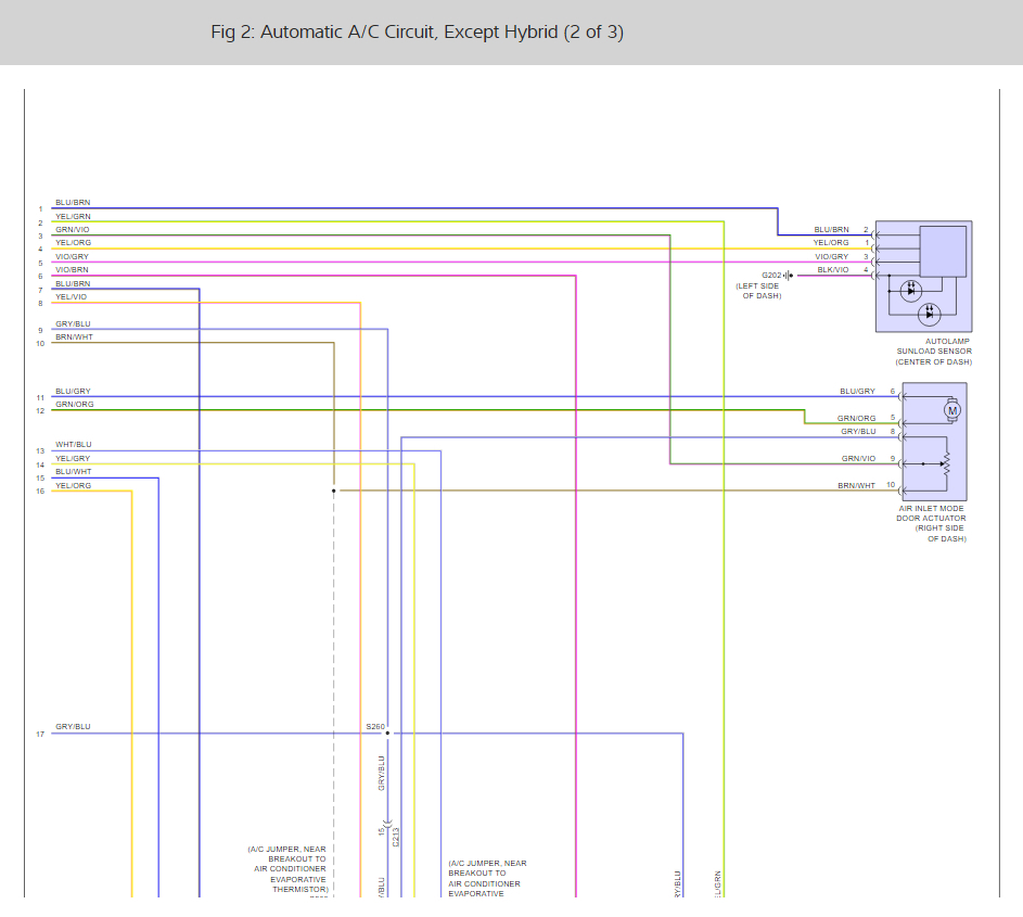

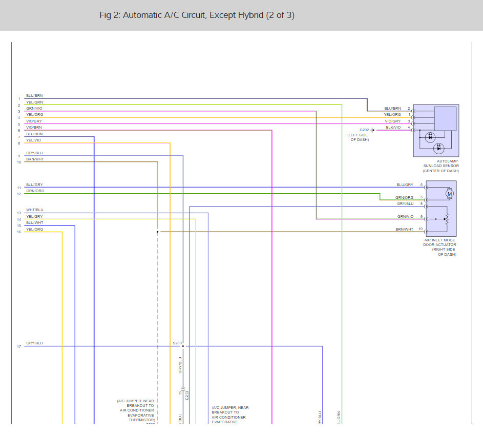

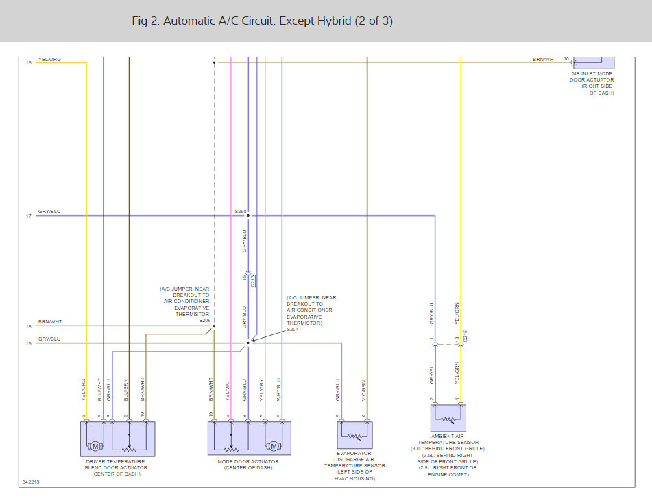

It sounds like you have a HVAC module going bad or the system is a little low on charge. Also turn the AC on high and let the car sit in one place and watch it for fifteen minutes to see if the fan go to high speed. The system is pretty intelligent and will only run the fans when needed.
Here are some guides to help you get the problem fixed:
https://www.2carpros.com/articles/air-conditioner-how-to-add-freon
and
Here are some diagrams (below) so you can do some testing to confirm the problem.
Please let us know what happens, we are interested to see what it is.
