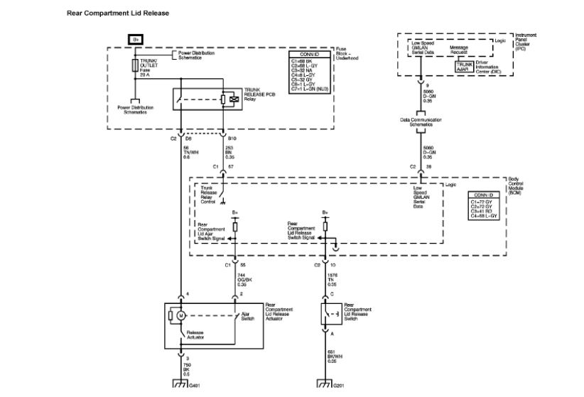

All four door locks constantly switch up and down every five to ten seconds while driving. Pulled door lock fuse to stop.
Tuesday, April 24th, 2018 AT 2:31 PM
MECHANIC
52,796 POSTS
Good morning
Okay, the body control module controls the operation of the locks. It is very possible that the module is the issue.
You need a advanced scan tool that can read live data on the body control module.
I attached a wire diagram for the system for you to view.
