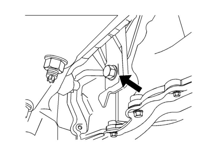

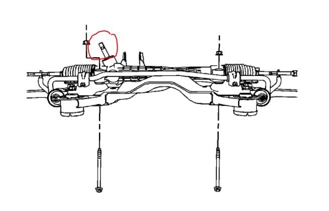

I have to replace the rack and pinion because the gears stripped. The steering wheel turns but the wheels don't unless I put it on jack stands, but when binding one wheel, I can feel the rack gears stripping.
I suspect the internal preload yoke broke.
Can you tell how to make absolutely sure the new rack can line up with the steering shaft?
Also, what's the torque specs on the rack mounting bolts and the pinch bolts.

Good evening,
The steering shaft from the car has a blind spline that lines it up correctly.
You cannot install it incorrectly. I attached the procedure for you to view. The torque specs are in the procedure.

4. Remove the transmission rear mount bolt.
ImageOpen In New TabZoom/Print
5. Remove the steering gear bolts, nuts, and washers from the steering gear.
Important: The position of the steering gear will need to be manipulated to remove it through the left front wheel opening.
6. Remove the steering gear through the left front wheel opening.
7. Transfer any parts as needed.

Important: Start all of the bolts and nuts by hand before finalizing any torques.
2. Install the steering gear bolts, nuts, and washers to the steering gear.
Tighten the bolts to 70 N.M (52 lb ft) plus an additional 90 degrees.
3. Install the transmission rear mount bolt.
Tighten the bolt to 90 N.M (66 lb ft).
