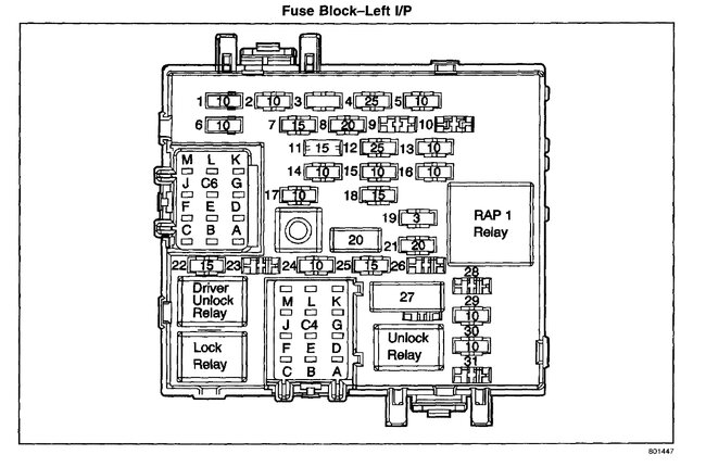

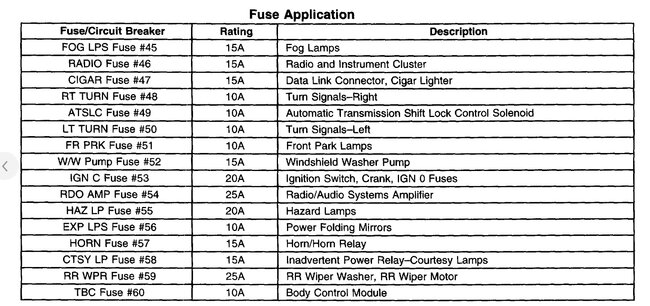

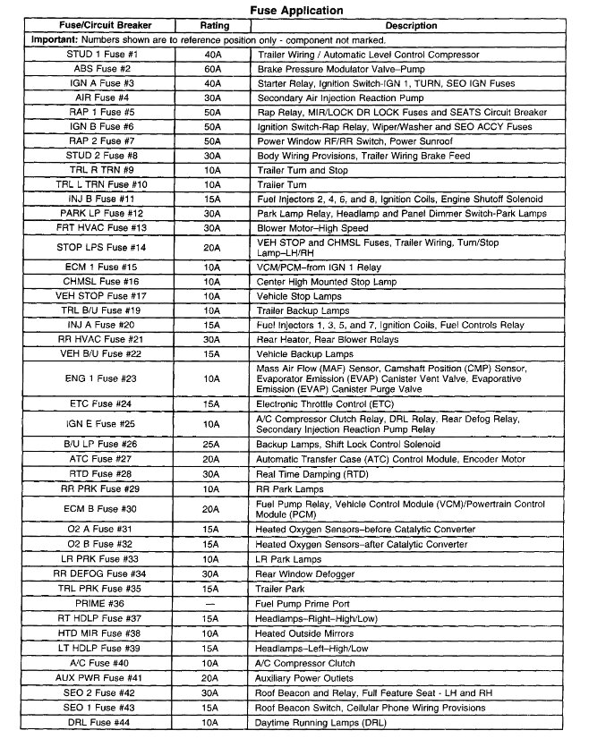

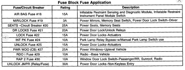

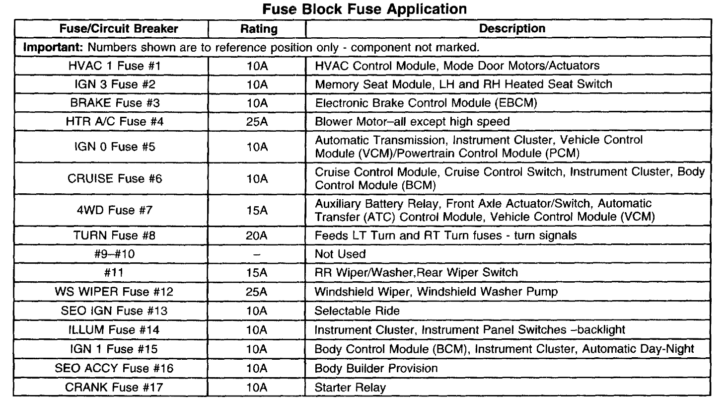

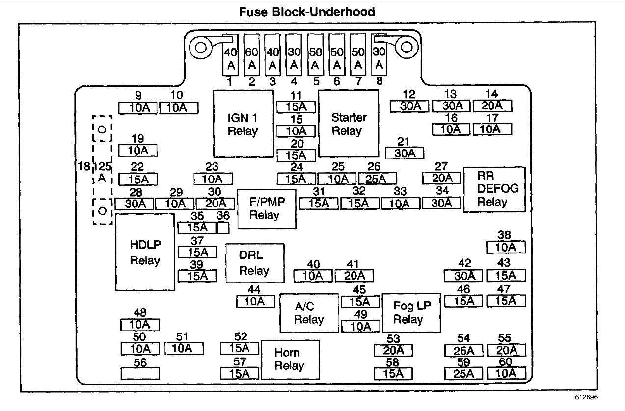

The first thing to do is check the fuses here is a guide and the fuse locations in the images below, please check the fuses with the key on.
