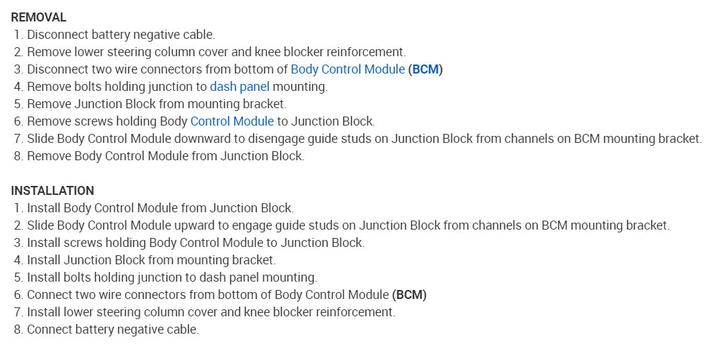

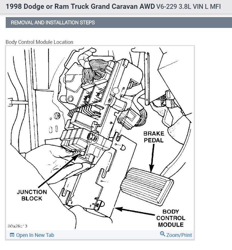

The power door locks and interior lights only work if vehicle is running or ignition is in on position. What could be the issue?
Feb 8, 2021 at 1:54 PM
  • 55,857 POSTS
This sounds like the BCM is out. To be sure lets do a CAN scan which is the future of automotive repair. you can get a CAN scanner from Amazon for about $50.00. here is a video to show you how:
https://youtu.be/u-4syLc-ifQ
Here are instructions you can replaced the BCM in the diagrams below. Check out the diagrams (below). Please let us know what happens.
