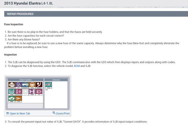

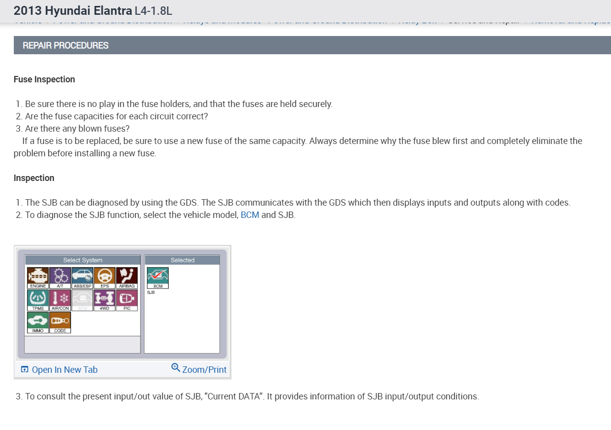

Changed the steering coupler and now no wipers or blower controls and all wires seem to be plugged in.

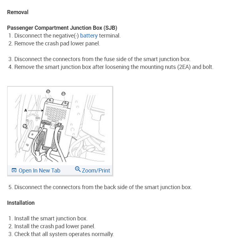

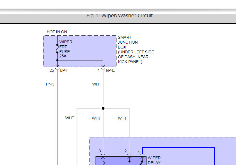

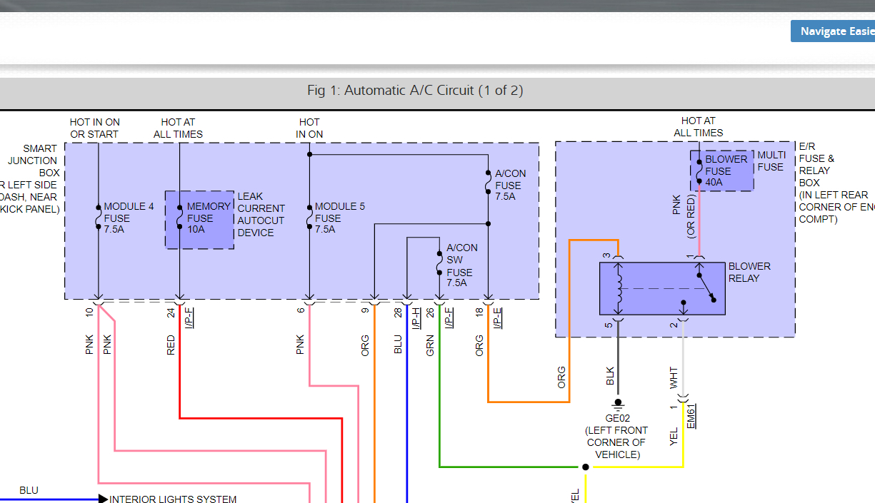

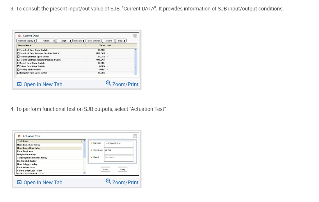

Steering coupler? Can you please expand on that? So, there is a smart junction box that powers these items I would start by checking for power at the fuses.
Here is a guide that will help:
The fuses you should check are in the images below. If no power is present when the key is on, then the SJB needs to be replaced which I have left instruction for. Check out the images (below). Let us know what happens and please upload pictures or videos of the problem so we can see what's going on.

I got it figured out. the ignition starter switch went bad for some reason when I changed coupler.
