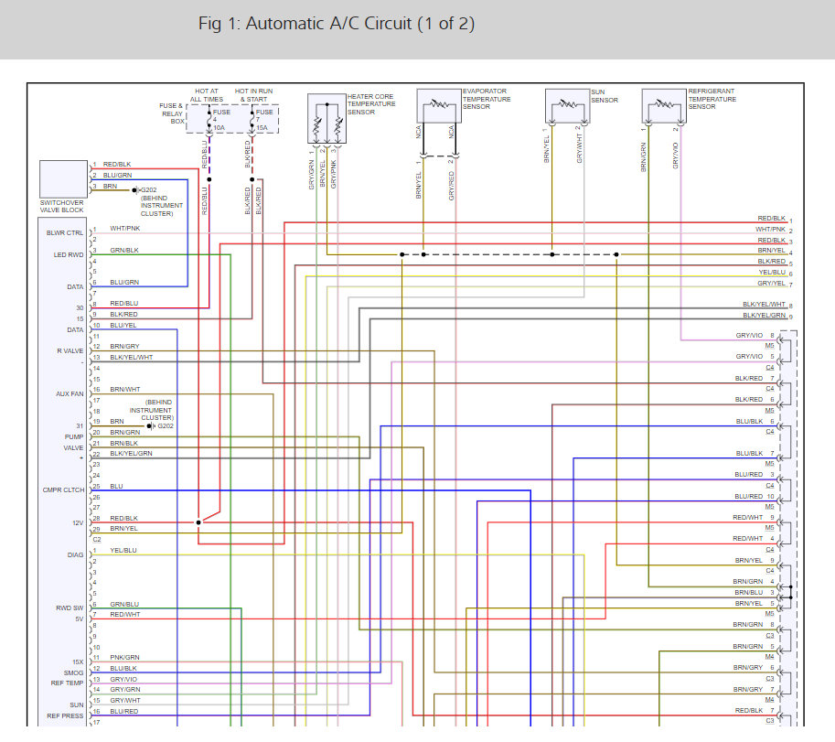

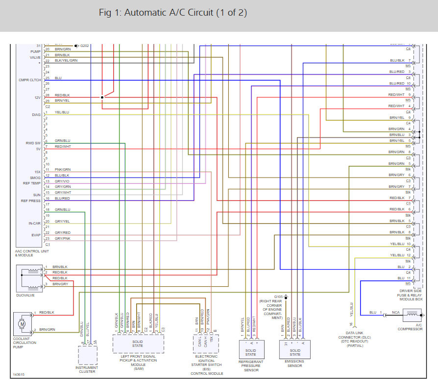

Hot air and no electric for compressor. A/C compressor has no power going to it
Aug 1, 2019 at 2:33 AM
  • 55,399 POSTS
Hello
The first thing we need to do is check to see if the system has a charge we can do that by following this guide
https://youtu.be/uZrQCGwXfek

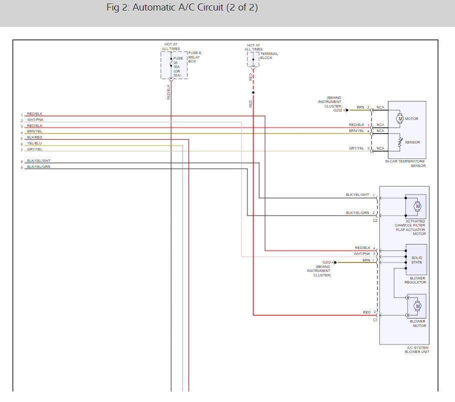

If the charge is okay we need to check the system fuses here is a guide to help with that and the air conditioner wiring diagrams so you can see how the system works and which fuses to check
Check out the diagrams (Below). Please let us know what you find. We are interested to see what it is.
