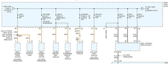

Remote for doors stopped working also the light delay and back windshield wipers all at the same time. checked fuses.

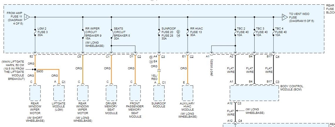

It appears the Lift-gate Module is responsible for all remote key-less entry operation along with rear wiper operation. I know you said you already checked the fuses, but I would double check the LGM #2 fuse in the rear fuse panel (see attached diagram). If the fuse it good, it's possible the Lift-gate Module itself has failed.
