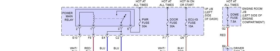

The alternator went out and the windows were down when alternator got fix the power in the car stop working. The radio, brake lights, heat rear view windows. Checked fuses none are blown.

Check these fuses first.
