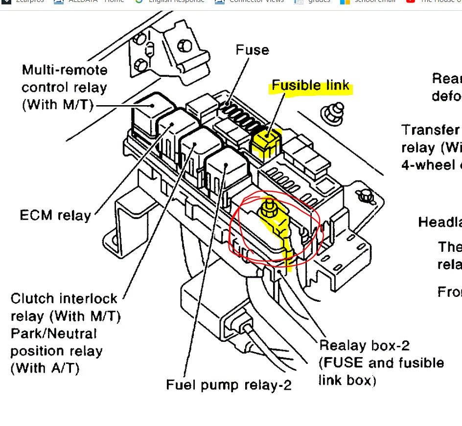

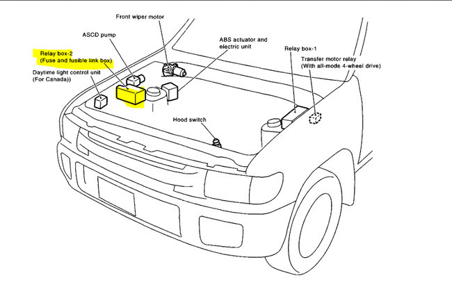

If nothing is working, I need you to locate the fuse/fusible link box under the hood. See pic 1 below for the location.
Next, in pic 2, I highlighted a fusible link that I need to be checked. A fusible link is basically a fuse but is designed differently to do the same thing. Confirm it is good. Also, confirm there is power to and from it.
Also in pic 2, I highlighted and circled the power supply wire to the box. Simply confirm there is 12v present on that wire/bolt. You can use a test light, multimeter, or voltmeter.

I've found the fuse box and the fuse was bad. But I also found corrosion everything from the battery post to the starter.
